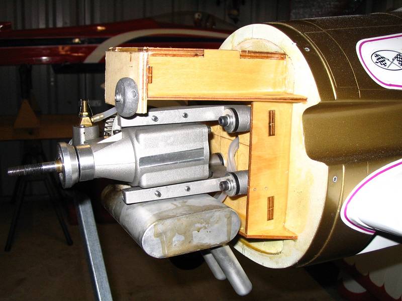

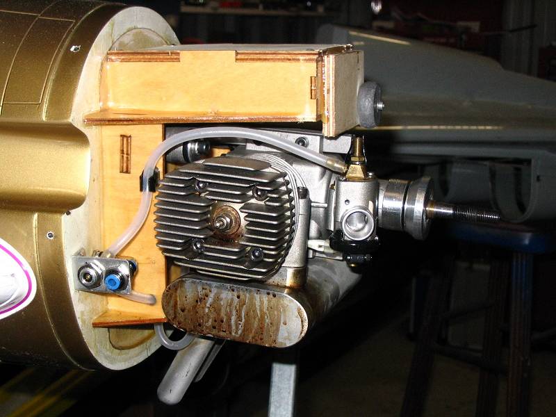

Here she is, powered by an ST G2300 with a Bolly 15X10 3 bladed glass prop.

can you please post a pic of the engine mount in the cowl how it look a like. does it stick out of the cowl and what muffler do you use ?
this engine looks to me like a bargain and with 12600rpm max with 3,7hp thats not dad

Here's the pics you're after. I chose the G2300 as it fits nicely inside the cowl and also a bit of weight is needed up front. The Bisson pitts muffler also is a nice neat fit. As you can see I cut a slot in the front edge of the cowl to help with air flow over the engine for cooling.
Hope this is helps.

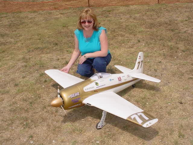

Here he is with my hunny , who has indured the assembly of this plane for 6 months..all the *****in and complaining...and she still loves rarebear, and me!
