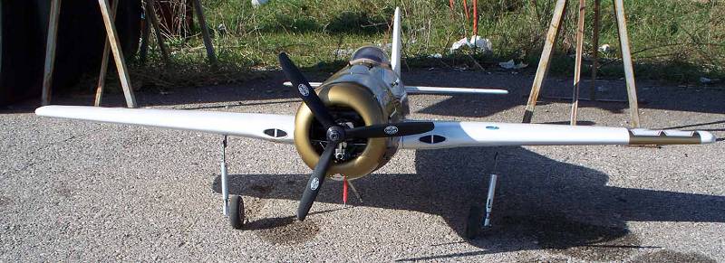

RE: ThunderTiger Rare Bear
I would like to ask : what kind of wheels do you use ? I use a pair of 3'' with normal rim and they deform ( because of the weight of the model), so my plane has a horrible tracking on the runway. I have order a pair of Robart scale wheels ,where the tire has a lower profile,but don't have it on hands yet. Also , i noticed that while my inside loop is O.K. , the outside loop goes to a snap-roll...Any ideas?
#1628
Join Date: Jan 2003
Location: KALAMATAMESSINIA, GREECE
Posts: 36
At list ,today ,i got the Robart wheels (but not the inserts) so i cut the hard foam from another pair of lite-wheels and stuff it inside the Robarts.No case to deform anymore. Also , i made a modification in the base of the retracts,i glue a piece of 3 mm plywood in the rear beam,so that the wheel ,moved about 20-24 mm forward (when in the open position) and away from the Center of Gravity.This should give even better ground handling ,i hope. I will test it on next Sunday.
#1630
Join Date: Jan 2003
Posts: 36
I think i am starting to fell very good with this plane in the air. Very clean flying model. NIce landings ,when you have some speed.
Test for the wheels . was O.K.
Much better ground handling and no sings of deformation.
I still have some problems, but i think this is because of the spring wire that connects the Gear and the strat. It is 3/16 (4.8 mm) the one that came with the SpringAir's (model 103 HD - 85*) but it keeps bending inside. Do you have any suggestion?

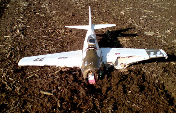

I was on the 2nd flight of the day.Everything was looking O.K.... 3 minutes after the takeoff ,i passed the transmiter to my 17 years old son (he flyies for 5 years now-mostly 3D ) to fly & feel the plane a little bit. He flew the Bear gently for 2 minutes, about 500-600 feet high and after a downwind leg and left turn, i saw the plane diving at full throtle .I thouht he was going to make a low pass over the runway- the plane was flying str8 to the ground on a 70 deg angle with the wings level and no respont to throtle, aileron or elevator inputs. I said """"uppppppppppppp""""""" but there was nothing that could be done.As if the receiver was locked !!! There was only 1 more flyer on the field on 40.150Mhz , i was on 35230 Mhz.,so no problem from him...
The plane fall in a very very mudy field, so i saved the engine ( found 20 cm under the surface).
I still can not undersand what happened. There was not pilot error. No crack or brake on the stabilizer/elevator. Everything was working normaly when i got there and took the photos. Battery ( i use 2- 6volt/2500 ma Nimh with two switches -http://www.rcbatteryclinic.com/parallel.html ) was O.K. , each one gave me 1500ma on the discharger...at 0.8 A.
Now i have put the receiver and crystal aside ,and will not use it again. If any friend has some answer ,i 'ld be glad to hear.
By the way, the last modification on the retracts ,was to put a 2mm ply, under the base plate close to the wings center, so that the wheels,moved when open about 1 inch to the front and away from the C.G. That gave even better ground handling.[][][]
That explanation sure puts doubts in the radio system and I don't blame you for setting aside your Rx and crystal. Have you ever had any other problems with your Tx? I currently use a JR6102 Tx and love it but I had some radio issues with it also. I sent it in once to JR with signal problems and they claimed I had a loose Tx crystal. I'm surprised I didn't notice that but it seemed to work great after that (for the most part). I was pretty sceptical for quite a while cause there's nothing more scarier in this hobby as getting radio interference while flying. After I got the Tx back from JR I went flying again and on this particular night I was flying my Thunder Tiger Lazy Tiger 51 and was on my third flight (I shoulda check the Rx battery before this flight, my fault...). I went straight up into a stall and nosed it over while the plane was fairly close to full throttle and from about 250 feet up (give or take some) it went straight down and smacked into a terrace channel which was also luckily very muddy. The plane was shredded but the engine (which I found about 10-12" under the ground surface) was OK. I sent the Tx and Rx into JR to inspect and everything checked out fine. I didn't check my battery until much later cause I was blaming the radio, but I am sure the battery was the culprit. As in your case it does not sound like it was. Here is a few pics of my loss. I really liked how this plane flew so all my original electronics and O.S. 52 engine is back on another Lazy Tiger 51. I've even got another brand new Lazy 51 in a box ready to be built if the the one I'm flying now ever gives up on me. I just recently purchased a Spektrum DX7. I've been wanting to upgrade to this since the 2.4 GHz is supposed to me much safer and less chance for interference. Once again, my regrets to your Rare Bear cause they are beautiful planes. Hope you can salvage it.

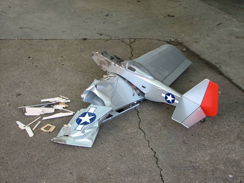

DragonRacingCars, you're right on the money. You shouldn't have to spend $300 on an ARF and not have the confidence that your plane will hold together in flight. That's absolutely ridiculous. That Beaver dude is totally whacked!!! What idiot would spend $300 on an ARF and want to put in all that work to reinforce the wings and stabs. I had the same problem with my Hangar 9 60 size Corsair. The plane folded in mid air because the wings just collapsed. I lost over $500 on that plane, including my lipo batteries. Horizon Hobby wouldn't do much for me on a replacement. Never buying from them again.
I don't know how these manufacturers can put out ARFs like this and have them fail in flight and do nothing about it. Posts for the Hangar 9 60 size Corsair go back to 2004 about the wings failing in flight. The Hangar 9 60 size Corsair crashed because there wasn't enough glue in the wings holding the wood together. What are these guys thinking? Skimping on glue? It's a $260 plane. I also have a Thunder Tiger Rare Bear, but I picked it up cheap, $150. For that price, I'm going in to reinforce everything, but not for $300. You've got to be nuts to spend that kind of money and do all that work as you would for a kit.
