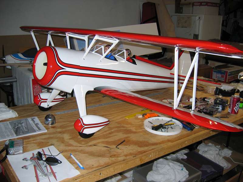

I bought my Super Stearman on Monday and have it nearly together by Wednesday evening. I'll be going with a Saito 180 Golden Night, or a Brison 2.4.. The plane goes together with excellence. I opted for a new chip hyde tail wheel which looks great.

super nice cannonball, where do you fly at in OK? I am trying to make a weekend and come to OK and fly sometime. keep us informed on the building and more pics.

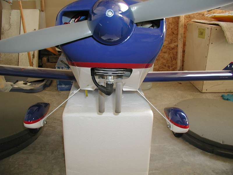

The G26 is an amazing engine. I run two of them currently on a Cermark Pitts and Sukhoi. One is converted to EI and weighs about 2.5 lbs without muffler. The conversion was done by Ralph Cunningham and I gotta tell you this guy knows his Zenoah engines. The ignition unit is housed in the rear mount of the engine keeping it all very clean. Very much worth the investment... it runs perfectly! This would be a perfect plane for a converted G26. I can't wait to hear how well they fly. Please keep us posted.
a few shots of the Pitts to show engine placement

Ari--The G26 I have is one of the B&B engines that comes with their inverted muffler (non-pitts style). I'm going to stick with it as there is not much room behind the engine to use a wraparound muffer.
Cannonball200--Wow, you really want to hand a Brison 2.4 on this guy? I've got a Brison 2.4 on my big Dave Patrick Edge 540T. That thing swings an APC 20x10 at 7850 RPM static. My Edge has unlimited vertical and hangs on the prop at around 1/3 throttle. The Edge weighs in at 15 lbs and is a much more substantial airframe. I'm curious to see how yours would hold up to that big of an engine on such a small airframe.
