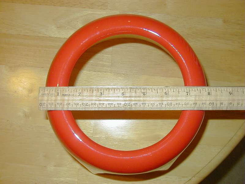

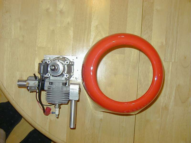

Finally took some pictures of my cowl. The cowl measures close to 8" in diameter near where the front lip begins to curve inwards. It is about 8-3/4" wide at the base, and is a little more than 6" long on the left side. The more I look at it, the more I am surprised at how small it is. It DEFINITELY doesn't need any high end servos, and my G26 will fit PERFECTLY and should fly it GREAT! So far, the quality still seems top notch and I have not run into any problems, although I have just started working on it.

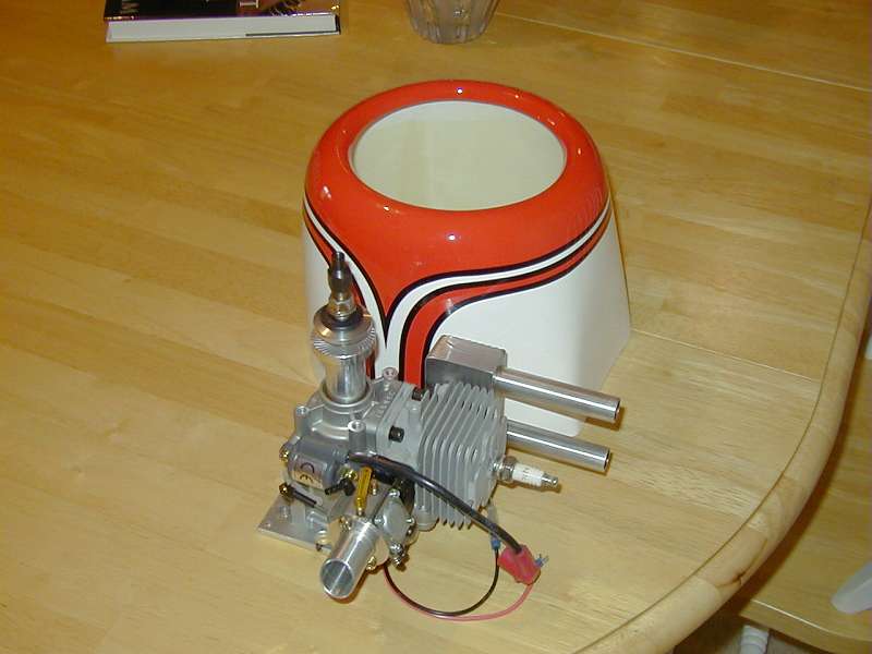

Here are some more...
