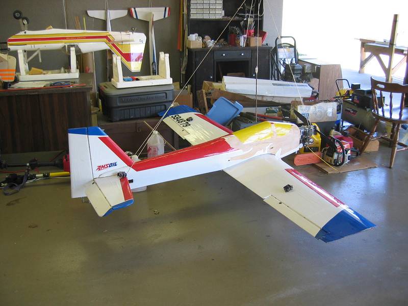

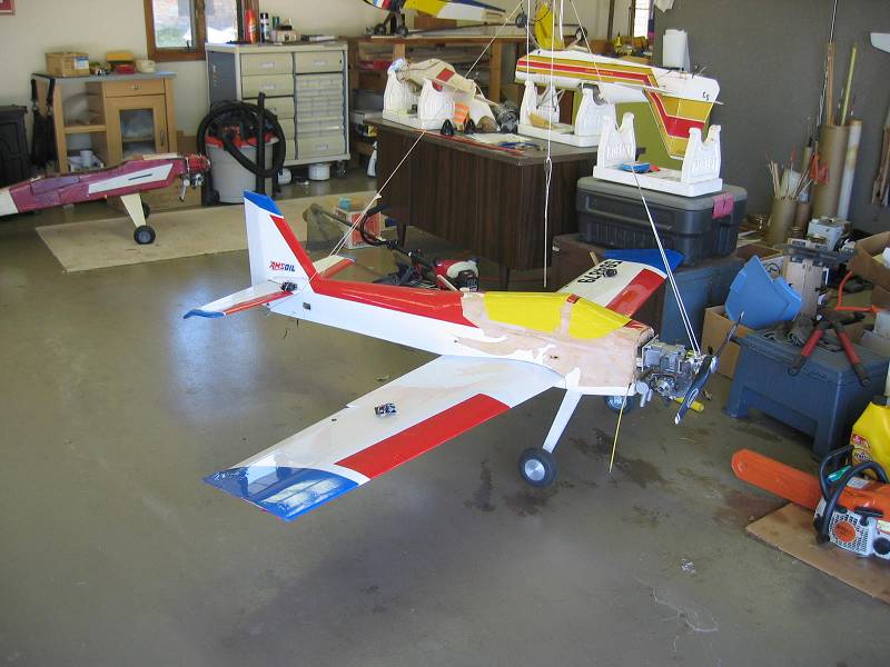

I prefer to balance right side up in a string cradle (front to back) with a suspended pendulum simply because it is convent, safe for the airplane (two inches off the floor) and allows laying parts on the airframe to check various conditions. Instability doesn’t exist using a cradle.

RE: Balancing low-wing plane
LeeHop,
Here is a picture of a hand me down that was being checked for CG. The servos are laying on top of the airplane for a rough balance check and the airplane remained in the cradle for 24 hours while alternatives were being considered.
Bill
Bill
Bill -
Thanks for the pics - they are very helpful.
Does the string run thru a nearly frictionless pulley at the top?
Does the pendulum hang from the axle the pulley is on?
If the plane is, say, nose-heavy, does the pendulum point to a location behind the desired COG?
Is the rear hanging point actually the leading edge of the horizontal stab? How does this affect the measurements?
Thanks for your help -
LeeHop
LeeHop
LeeHop,
Suspension is from an open hook. The string is looped once or twice to prevent the string from sliding. The airplane should be at approximate flight attitude when picked up, which means that when the airplane is suspended it will be level.
The pendulum will always point to the GC.
The cradle is looped on both ends and the attach point (to the airplane) is relatively unimportant. A big loop goes around the tail feathers easily and doesn’t need to be changed for the next airplane. In the picture the loop went to the tail wheel bracket otherwise the loop slides up the fuselage.
The cradle works for upside down balancing for those who prefer. The airplane doesn’t know the difference.
Think about the process like a crane operator picking up an I-beam. The choke point (pick point) is important but the cable attachment points to the I-beam simply need to be towards the ends.
I use a string ratchet for suspension for convenience. Prevents tying so many knots.
Bill
Bill

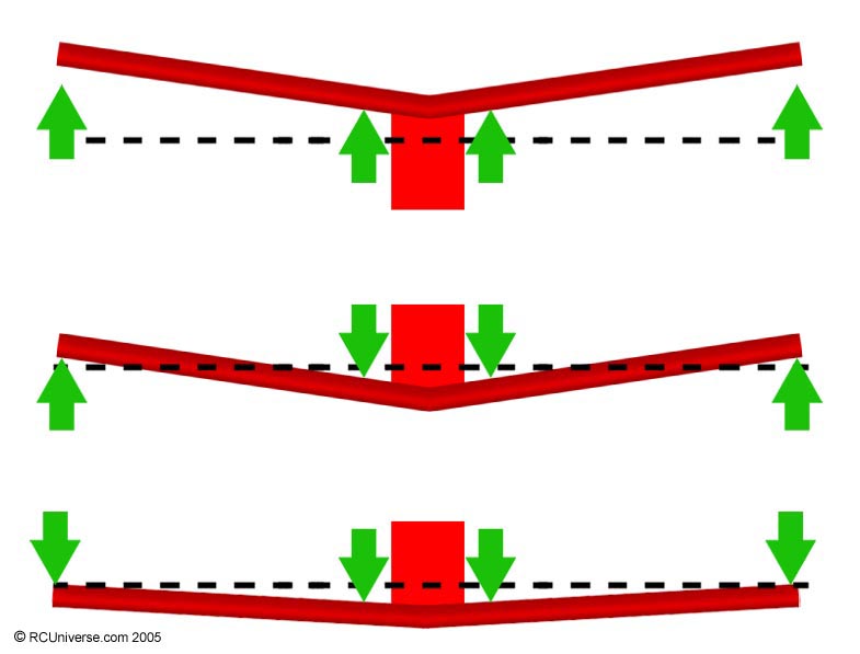

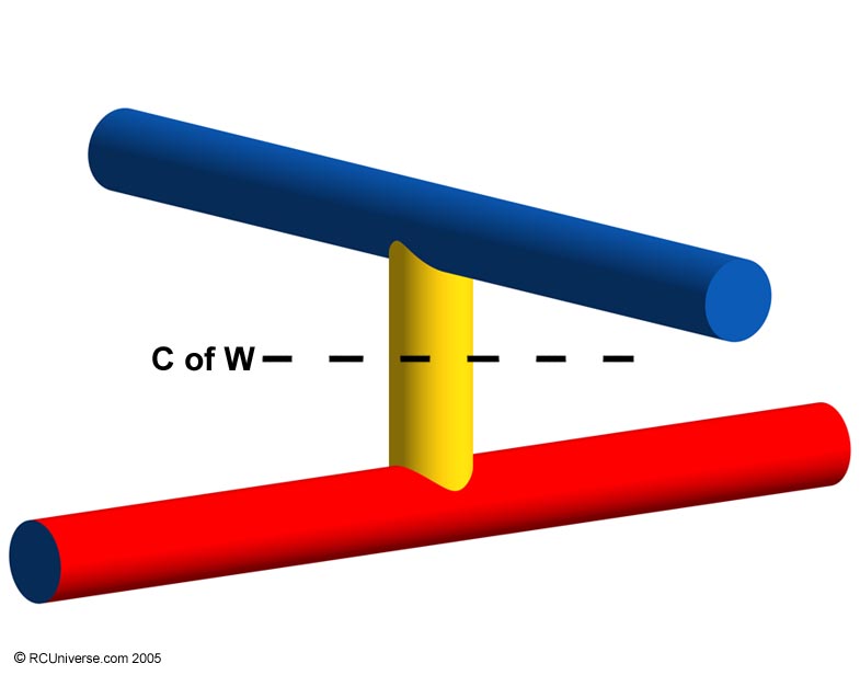

The question of balancing a plane Right-Side-Up, or Up-Side-Down is really a matter of the design of the plane.
Aside from Center of Gravity, you need to consider Center of Weight (CW).
In the first figure below, if you were needing to balance the Red bar, you would hold the ends of the blue bar with the red bar hanging below (as pictured). But if you were balancing the Blue bar, you would invert it and hold it by the Red bar, wouldn't you? That's due to the "Pendulum Effect" that N70R mentioned in post #2.
Now if you tried to balance the Top bar by holding the ends of the bottom bar, it would try to flip over to get the CW below the pivot point.
So depending on where the aircraft's Center of Weight is you might find it's easier to balance it either Right-Side-Up, or Up-Side-Down
A High-Wing plane will (Except in rare cases) always balance better Right-Side-Up, because whether you balance at the wingtips, or next to the Fuse, the CW is always below the wing.
But with a Low-Wing plane, the CW will always be above the wing at the Wing Root, but at the tips, it may be below, depending on several factors, including the amount of dihedral.
So the bottom line is, You can't just say one way is better than the other, but with a little common sense and maybe some "Trial and Error" it's not too difficult to figure out which way works best for whatever plane you are working with
