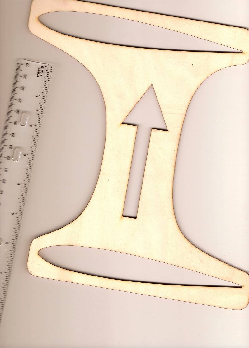

Thanks to the excellent thread on this here, I was going to also tackle the rigging problem...
Now could someone PLEASE, PLEASE, PLEASE... upload a 1:1 scan of the aligment template, preferably done with the templates right on the scanner glass, and saved in jpeg?
It would be much appreciated.

RE: Nitroplanes.com
BTW: Except for the diagonal, my struts look the same as your picture.
is this what you're looking for?
