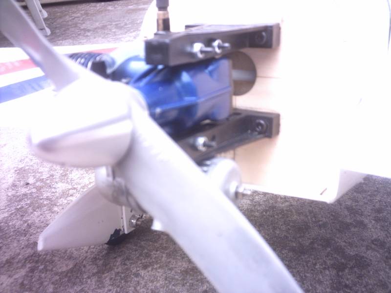

Long ez 46 engine mounting question.

Im installing an OS 46fx sideways on the plane. Am i suppose to center it on the crosshares located on the fire wall? IF i do so, the cowl seems to be real high and does not look good. Does anybody have pictures of their installation. Thanks for the help.

Smokey I took a few pictures of my engine mount this morning. Mine is mounted so the enginge is centered on the marks scribed on the firewall. The piece of wood you see under the upper mount is there to space the engine out just a little so the prop thrust washer is clear of the cowling. I dont fly mine with the cowling as it seems to over heat to quickly.

Thats exactly what i did with the engine mounting. How does your cowl look installed? Mine looks like its angled too high up and it does not look right. If i try to follow the slope of the top of the fuselage with the cowl, the engine should be mounted maybe over 1/2" lower for it to look alright.

Smokey, I just slipped my cowling on and it lines up OK. The crankshaft is in the center of the cowling cutout for the propshaft to go through. I did notice what you were saying about the slope of the rear deck. Mine to looks like it does not follow the line of the fuse exactly, but if you'll notice the rear of the fuselage slopes upward on the bottom too. The cowling appears to center itself on these two lines, top and bottom. Put the wings on and check it out, it look a lot better.

As a tip, add a washer under the bottom two engine mount bearers so that the prop has "down-thrust" at the rear.
Opposite to down-thrust in a tractor set-up. The prop should seem like it would lift the nose-(it should)

Hmmmmmmmmm, Mine required a shim under the top engine bearer, I took the bottom one out. See the pic's in the first part of this thread. It climbed at full throttle and when trimmed for that it would require lots of up for landing. After adding the shim it just flys like a normal front engine plane. They must all be built a little differently. Probably has a lot to do with lack of information in the instructions, ie... what angle does the front canard go in relation to the wing. I know mine could be moved in the slot provided about 5 degrees difference. Also the balance of the model, do you balance with full tank or empty tank for the postion shown? I balanced mine empty, some did it full and I think one even went with half a tank of fuel. After getting th first few flights over and trimming things out its a really neat little airplane. Maybe a little more comparison for the newbies so they can get it right the first time. I'm going to fill my tank and see where it balances with nose gear up and down and post it. I haven't checked it since i changed the motor to the OS LA 46. I know its about 5 oz's lighter than the OS46FX is, same prop and muffler though. I'll see where it is now because it's really flying great now.

About engine thrust line. From the back of the plane the thrust line should be about 3 degrees UP.
