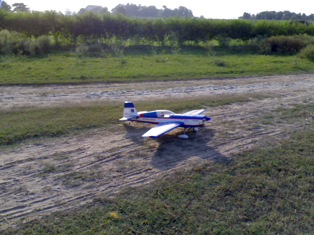

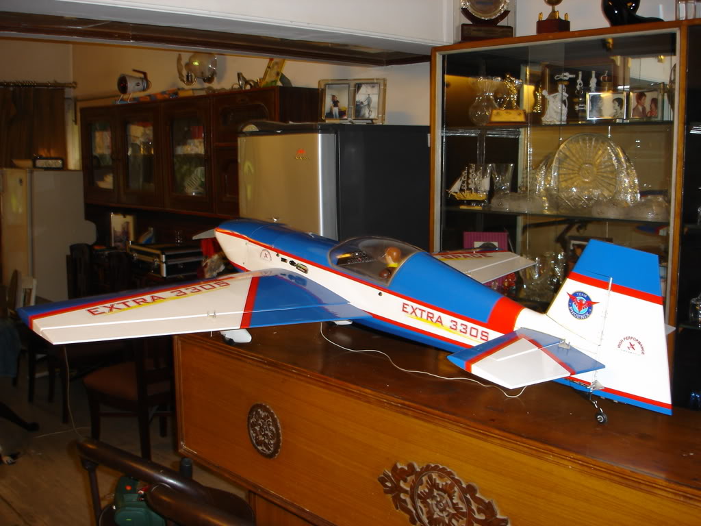

Phoenix Extra 330S 60-90 Size
Date : 27/09/2006
Time : 1600 Hrs
Plane : Extra 330 S
Venue : Noida (Suburbs of New Delhi) India
Hi
One word for this plane AWESOME.
This is a Pheonix models Extra 330S (60-90 Size) with a O.S. 91 FX. Power is Unlimited. Its like a rocket at 60% throttle (rich needle valve setting). Prop 13 x 8 (breaking in prop). 4 x 3001 (servos), 1x 645 MG hitec servo for rudder alongwith Dubro Heavy Duty and Extra Long Servo Arms. Fuel tank changed to 450 c.c. by MK. Wheels changed to rubber (GP) for low bounce.
After the pre flight checklists were done just pushed up on the throttle and went like a bullet. The only correction i had to give was one click on the right aileron. Comes in very hot for landings. DR rates and expos were
Low Rates
Ailerons : D/R 55% Expo -25%
Elevator : D/R 50% Expo -40%
Rudder : D/R 50% Expo -30%
High Rates
Ailerons : D/R 100% Expo -25%
Elevator : D/R 100% Expo -45%
Rudder : D/R 100% Expo -25%
Tracks very very straight and true. Rudder gives great Yaw withought banking. while coming in for landing its very stable and using rudder alone you can make it track the runway. Planning to change to 15 x 4 prop.
Excellent plane for disciplined AMA and IMAC manouvres
Go get yourself one. You wont regret it.
Siddy OUT.........
P.S. Got the wheel pants painted white (red is stock)

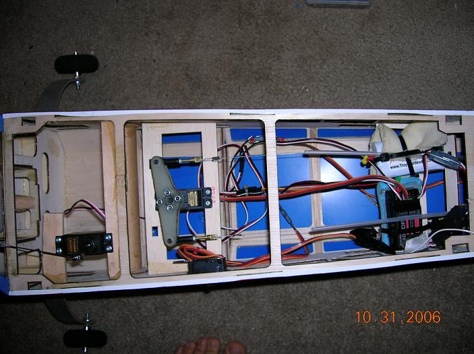

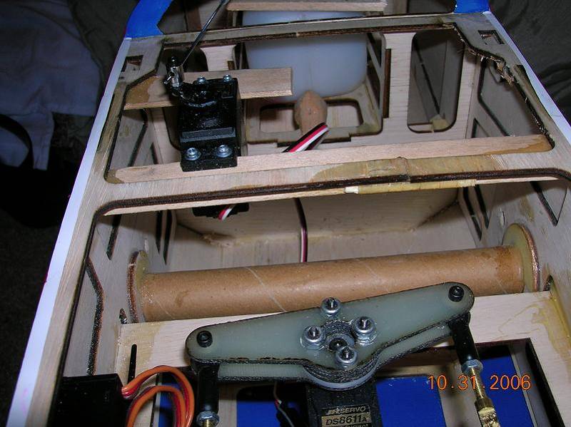

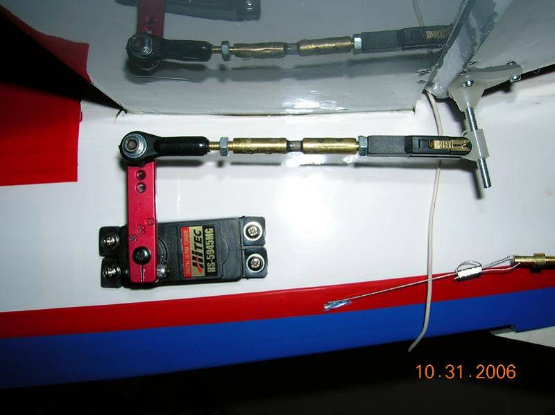

I'll get you some pictures of the inside tonight. I got the plane as a present after my dad wrecked my Wildhare Yak....lol....(that's another discussion).
I have removed some weight from the plane already such as the cockpit area I removed the pilot figure and lightened the canopy.
I too like ATMYCABIN have a Tower .75 in the nose and I am going for a 3D plane. If I can get it to under 7 lbs. I'll be happy. It won't have much pullout from a hover, but at least it will be capable if the desire is there.
Any of you guys with the .91 done any lightening or did you just ad weight to counter the larger engine? Much help would be appreciated to see where some ideas about secret lightening spots.
The plane has got overkill radio euipment that I pulled out of my Yak:
- JR 8611A Pull Pull on Rudder
- Hitec 5945MG elevator halves
- Futaba 3010 High Torque on ailerons
-2800 mAh Li-Ion regulated to 6V
Can NEVER have too much power, but I'll do what I can with what I got. Will post pics tonight.

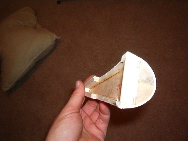

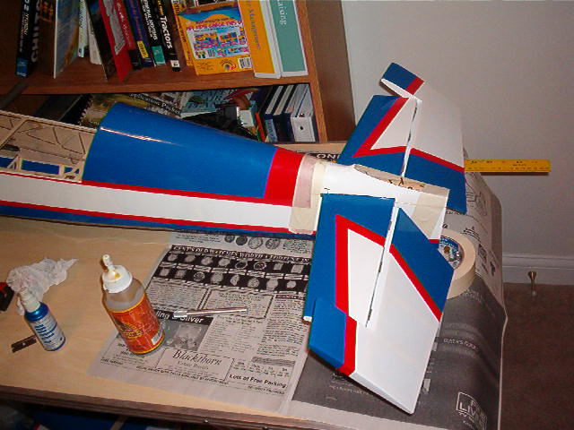

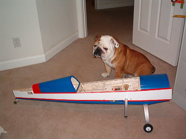

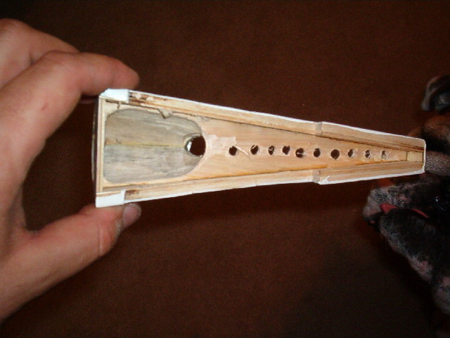

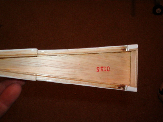

I am also planning on not using the wheel pants or gear fairings, (which are really nice) and will most likely cut out most of the bottom of the cowling. I don't see much else that can really be done to the plane to remove weight. It's actually pretty light as is.
Here's some pics of the assembly process. It will go together well, as I have some great supervision!

Nice pics Cap, I am going to try to maiden mine this weekend so I'll try to run it through the paces as well as my abilitly is.
On a side note finding room for my reciever and batter along with a voltage regulator was a B$#)^. I had to mount the throttle servo on a mount just behind the fuel tank slot. I balanced it and it is around 125mm+ so it's going to be on the tailheavy 3D side already.
Also I added my old 14 oz DuBro tank from my old Phoenix Extra .40 size, as well as replacing all the endlinks for the servos with 4-40 Quik-Links. I only kept the carbon rod connections and stock control horns.

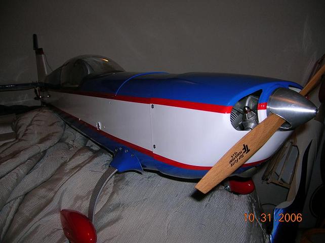

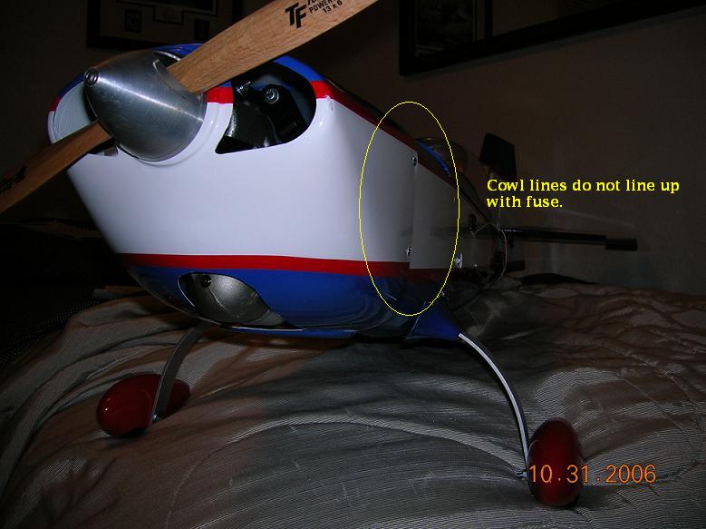

Here are some pics from mine now complete. I am just waiting for some good weather for the maiden (Been windy as crap here).

Here are a few pics. I don't know how much larger the silencer on the .91 is, but Tower's is huge so it should not be much more.

Yeh it will, I just didn't want to fool with making new blinds since getting to them inside would have been a P.I.T.A. Also, at the 45 degree angle my engine is completely enclosed.
It comes at a 45 degree angle for the mounts, and my old extra did not have a tunnel for the silencer.......therefore I had to get a pitts, but I don't get the same HP out of the pitts as I do the stock muffler which is lighter and less restrictive.
