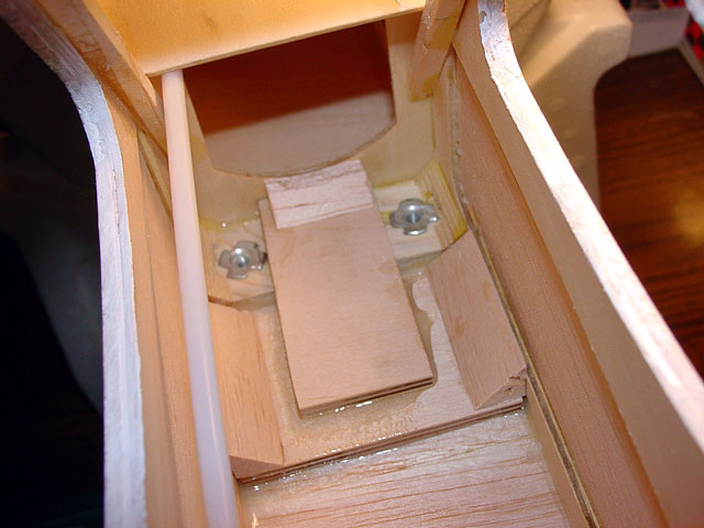

RE: Rascal 40 / Saito FA62.......Beginner
ORIGINAL: pdansalvish
Add some tri stock around the landing gear plate and replace their metal plates with steal. Have fun...

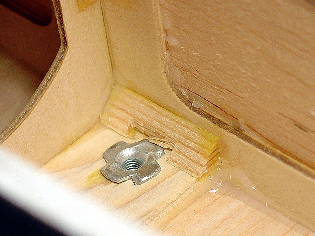

Keith,
What I mean by tri-stock, is go to your local hobby shop and purchase a strip of 1/4 triangle balsa. Cut two pieces the width of the plane and glue to the front and back edge of the landing gear plate on the inside. I believe I used 30 minute epoxy to glue the triangle into place and I also spread it around the on the inside of the fuse near the plate. Just a very light coat.
I hope that helps.

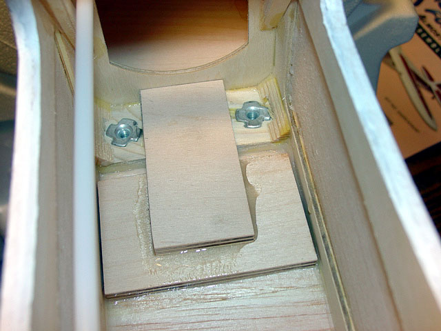

Well, anyone who knows my method, knows I take pics of just about everything!
So yeah, I have pics of the landing gear reinforcement. First pic is factory stock landing gear area. Second and third pics are the added "beef", all epoxied into place.
