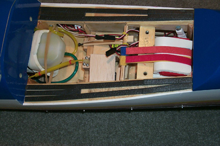

Built one this Spring. Had not built a plane since 1973 and it was SIG kit I never put radio in. Having said this, I found it very high quality for the price. Monokote needed a couple hours of ironing initially to remove wrinkles. Packing and shipping was good. I did replace most all of the hardware, just because I wanted the best and found the included items average.
For grass fields:
4" Sullivan Super Lite wheels, no pants
1.5 inch tail wheel
Sullivan tail wheel assembly for 14-20 lb planes
Zenoah G26 with 18x6 or 18x8 Master Airscrew Classic
Dubro heavy duty control horns
Dubro pinned hinges
Graupner sailplane surface gap tape
TruTurn 3 inch spinner
6 volt NIMH batteries with voltage regulator
Dubro large Gas quick fill
24 oz tank, runs a LONG time, mounted backwards in fuse and rearward of standard position
1/4 scale pilot
I placed batteries and reciever as far back as possible, added 8oz to tail and it still balances a little nose heavy. OK for now. Total weight, 14 lbs. I also added lots of epoxy and CA coating. Highly recommend two coats of thinned epoxy underside of belly pan and cowl. They are good, but the epoxy will prevent brittleness and eventual cracking.
Plane runs and looks great. Have not yet flown, as I am just finishing training on a small trainer. Hope to have up soon.
Highly recommend the ARF.
P.S. I paid $234 on sale last February and had a $25 coupon on top!

Batteries: 1800mah NIMH from Walmart Camera for $10 for 4
Battery Holder: www.acemodel.com
Gem 2000 and reulator: MPI
Hardware: Tower Hobbies
Radio: Futaba TX6AX PCM with s9001 servos
1.25inch aluminum servo arms on tail feathers for maximum throw

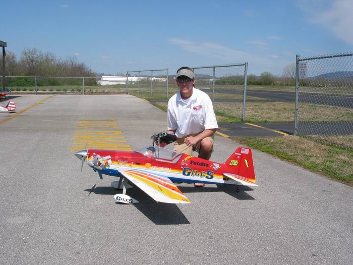

Comment on the Giles- I have had two of these airplanes and my son has one as well. I lost both of mine. One due to a wing failure and the other due to a Rx failure. G.P. went above and beyond in replacing the first one complete with a new OS 160 FX, Rx, servos, the works. Their evaluation of the wing was that it shouldn't have failed. Can't say what happened with the Rx on the 2nd. one other than possibly vibration got to it. Yes, I had it padded well..... Sent the Rx to Futaba to have it checked out and Futaba said there were two cracked ceramic filters that were damaged due to a hard landing. I will never know if it was a hard landing or the crash that cracked the filters.
Even after losing two of these airplanes and after having assembled two myself, I can tell you that all in all it's a pretty good airplane, IMHO. There were a few thread comments about incidence problems with earlier models. I did not encounter this. For the $ it's hard to beat and this airplane is a good introduction into the 1/4 scale. I really liked how mine flew. If you go with this model be sure to not get too much throw in the elevator. There have been several threads about snapping with too much throw. I encountered this on the first model and after adjusting all was ok.
Once you have the throws set right I found it to be a forgiving airplane. Both of mine and my sons tracked perfectly on takeoff. We both have a tendency to come in on final a bit too hot and the airplane will soar and soar. It takes a bit to find the right speed for final to avoid the soaring issue. At least it did for us.
Last I saw Tower was asking 279.00. Anything below this is a pretty good deal when you consider that most other airplanes will cost around 400.00 and up. I am in the process of assembling a WM 300 Extra. Purchased on sale for 375.00 at my local hobby store. If I had the same to do all over again I think I would have gone with either the G.P. Patty Wagstaff Extra or the WM from the get go. You can always buy a more expensive model than these suggestions. I really did like the looks of the Giles and enjoyed them while they lasted. Not meant to be a negative hit to the airplane.

I have a GP Giles with a 1.6 MVVS gas engine and it flys great. Just don't set the elevator up with too much throw and she will fly great. With correct throws there are no bad tendancies. I think this is one of the best built large scale ARFs on the market. For the money you just cant beat it. IMHO

This is almost funny. I have had two G.P. Giles 202's and decided to not get another, even though I really liked the airplane. Then I saw these pictures on the thread and just so happen to have all my servos, Rx and the 160 still uncommitted on the bench. I looked around and decided that I had to have another one. How's that for loyalty??? I know it sounds crazy, but when you like something, well, why mess with it. I liked this airplane and had a lot of fun flying it. Just a fun airplane in it's class. Maybe the third time will be a charm. Ordered it this morning.
