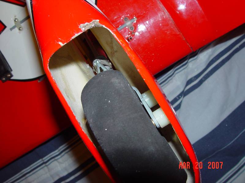

Hey all you Gee Bee R-2 lovers! I had problems with the stock wire gear twisting on hard landings with my Great Planes Gee Bee R-2 causing the wheels to contact the wheel pants. This caused a braking effect on the wheel resulting in nose overs. So, I bought the Robart struts for this plane. After I installed the Robart struts, I noticed that they compressed fairly easily for a 12lb plane and guessed that they would probably bottom-out on a hard landing and let the pants contact the ground causing nose-overs.
The real Gee Bee R-2 had wheel fairings attached to the wheel fork with telescoping pants to prevent this from happening, so I decided to do the same. I couldn't use the scale, molded-in joint as the telescoping joint because the Robart struts are not parallel to the leading edge of the pants. I had to make the joint further up the pants instead. The Robart struts compress just less than 1", so the joint had to be at least that far from the molded-in joint to avoid contact with the added sleeve. First, I drew the cutout and sleeve overlap areas on the pants. The sleeve would be made out of aluminum roof flashing and be glued to the wide end of the pants and overlap the narrow end 1/4". The area to be cut out is scribbled over in the picture below.

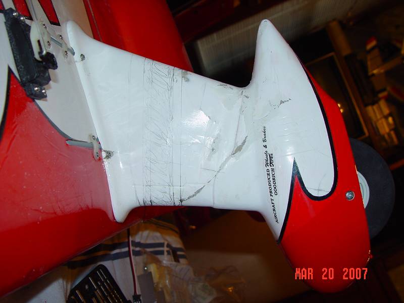

BTW, I chose to make the new telescoping joint perpendicular to the leading edge of the pants for simplicity of construction's sake.
Then, I carefully ground down the root of the pants to make them center on the Robart struts properly when they were tightly screwed onto the wing. The wheel fairing was then fastened to the wheel axle with 6-32 screws and nylon spacers carefully fitted and cut to length so as not to put twisting forces on the pants that would cause misalignment when the cutout area was removed from the pants. The plywood inserts that will be the base contact points for the fastening of the Robart struts to the wheel pants (originally glued in place for the stock wire stuts to bounce off) are not parallel to the strut forks, so the nylon spacers need to be slightly angled on one end to make stable footing.

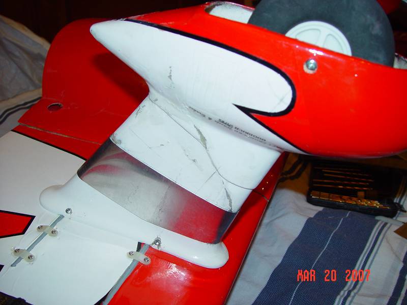

The next step was to fit a 2" wide strip of aluminum flashing around the pant.

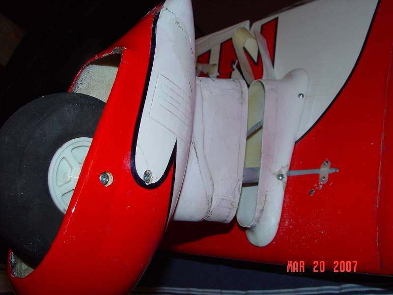

Time to cut out the 1" shock area.

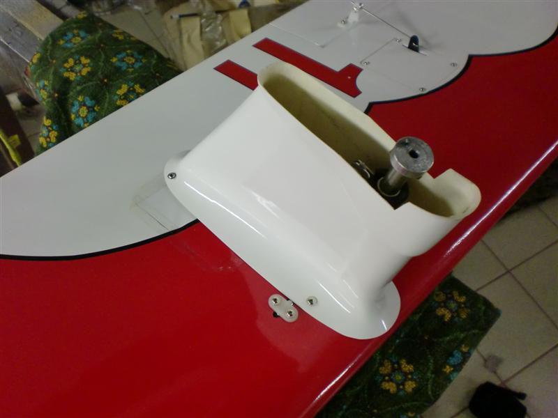

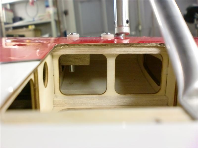

Hello,
here are the pics of my mods:
1. Here you can see the lousy glued hardwood block, one cracked out, when i placed the model carefully on the floor, imagine that!!!
But it was the start to do the modifications:

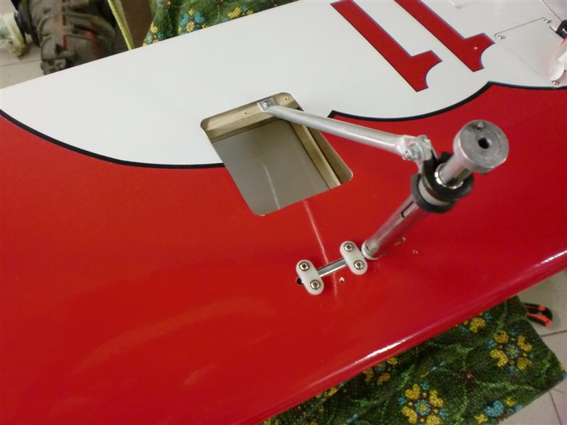

2. Here´s my added hardwood block to fix my additional brace (Graupner tube 8mm outer/7mm inner diameter, strong, but very light). The hardwood block is fitted without gap to get as much contact to the surrounding wood:
3. The upper joint with the Seagull strut:

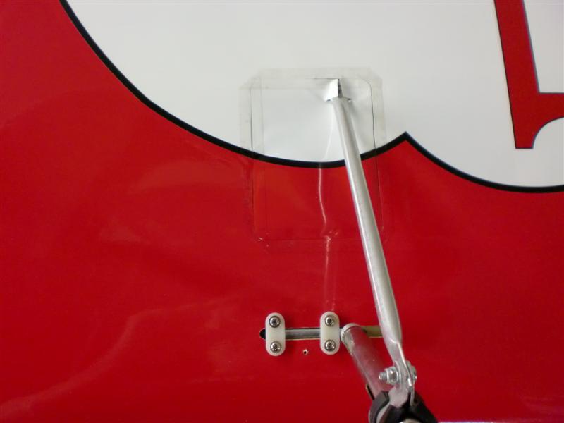

4. I used the old cutout film to close the hole again, with tesa, not perfect, but a fast fix:
5. The upper part of the pant, note the cutout for the wheel fork (not mounted in the picture):
6. the other side:
7. the wheel fork with the lower pant. I glued two plywood blocks per pant and fixed them to the fork with 3M Dual Lock, great stuff, almost free adjustments possible and the pants can come loose in accident case. Note:i had to rebent the forks to fit with the HKGee Bee pants, the Seagull pants are wider.
8. Wheel fitted. Because of our grass airfield i decided to let the wheel "look more out of the pants", sorry, i don´t know how to explain that better...
9. Complete assembly. If you look close, you can see the cut outs of the upper pants...i can live with that... Note:I have not glued the wings together and i am sure it is not necessary because of the aluminium link tube.
Thats it. 90% i would say, because i think it would be necessary to stiffen up the struts laterally with wires.
Wolfgang

the robart struts are high quality, pricy and especially designed for the Great Planes Gee Bee R2.
For the Hobby King version you would have to modify the wing attachments.

Here on the photo you can see on the left the Seagull strut and on the right the HK wire sh%& :
BOTHversions (Seagull /Robart) are spring loaded and no hydraulic damping, what would be the most effective improvement!
