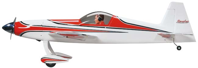

This Plane just shot straight to the top of my most wanted list.
http://www.greatplanes.com/airplanes/gpma1018.html

It sure is perty

WOW! Thats pretty sweet!

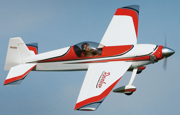

Here is the official page of Great Planes Revolver ARF
What a good looking plane it is....thinking of buying mine and throw an OS 55AX and 11x6 APC prop....it will be fast as a rocket!!!!!!!
LOOOOLOLololoLOLOOOLloLOlolOLLOlolOLOLOolloloLOLoL OlOLolOLoOL
[link=http://www.greatplanes.com/airplanes/gpma1018.html]GreatPlanes REVOLVER ARF[/link]
And here is the video (as always broadband recommended):[link=http://video1.hobbico.com/gallery/gpm/gpma1018-deluxe.mpg]Video BIG[/link]

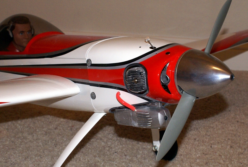

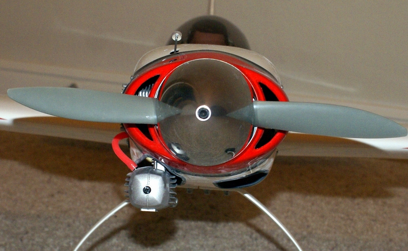

Here are some pictures of the Revolver I'm building using an OS .55AX and the stock muffler. The stock muffler requires some creative cutting. I used a Pitts style muffler on another .55AX and kept having trouble with the stingers developing cracks and even breaking off. If you remove the baffle, the stock P-Box muffler produces more power anyway.

Looks like the P-Box works out well on the 55. Nice work! How does it balance with the 55 AX? I would love to put a Tower 75 on this plane but it is ~4 ozs. heavier. I think I could move the battery back to take care of it. The Revolver is definitely at the top of my list.
