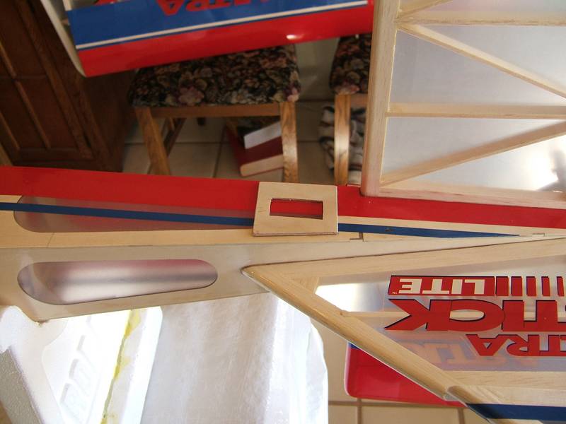

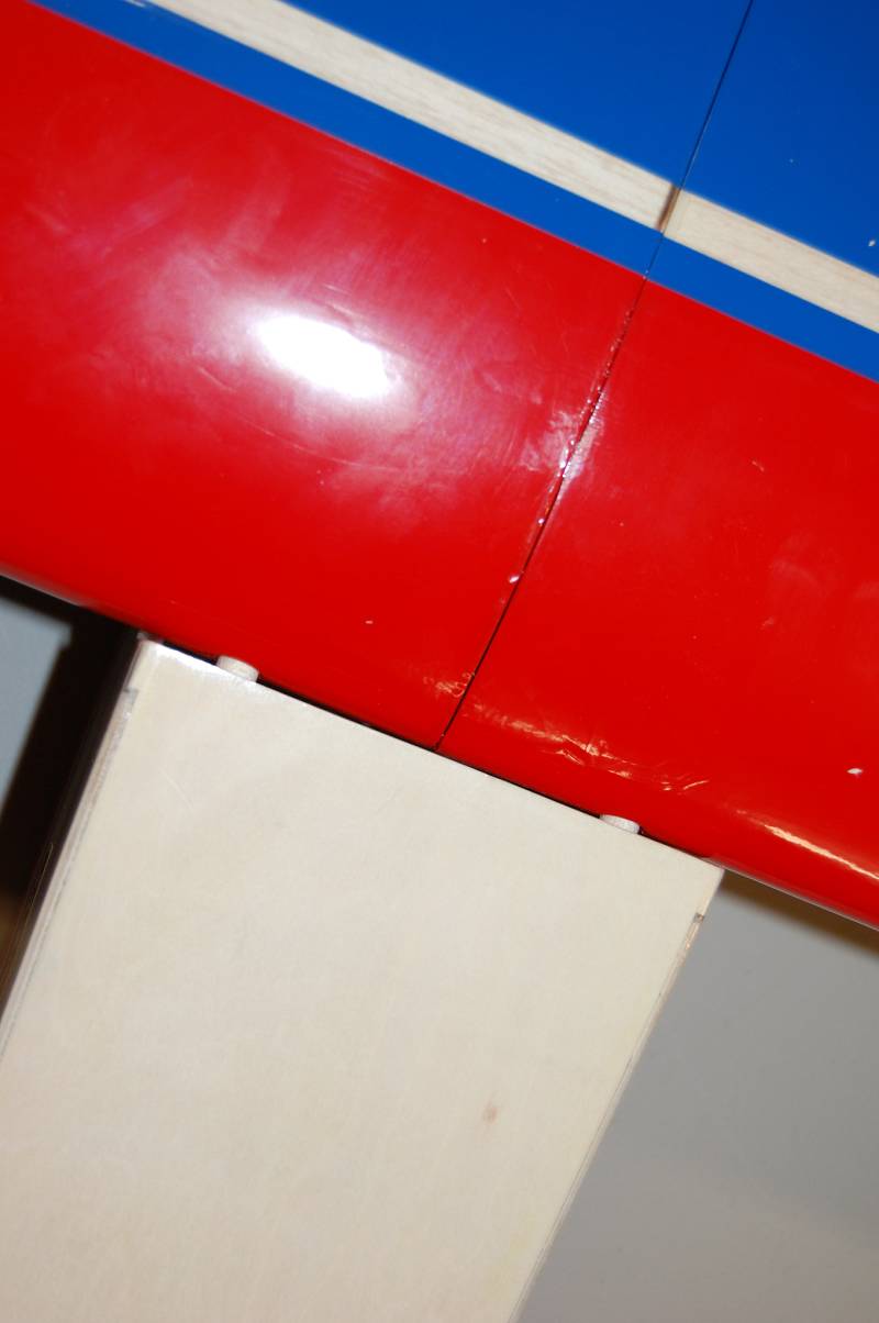

This is a trial fit for the wing. I read somewhere that people were having problems with the wing dowels. Does this gap look normal? With the wing pushed all the way against the fuse you are able to see alot of the dowels. There are hundreds of images of the US lite here on RCU and I cannot find one of this view.

Hey Hill...I'll be real honest, I've had 3 Ultra Stick 60's over the past few years and yours looks a bit on the "wide gap" side to me. I'm building my first 120 but H9 is H9 as far as Sticks go and I have seen better fitting dowel to wing joints on most! [8D]

Thanks, I thought it looked wrong. Maybe someone will come along with a picture I can compare to. I have not glued the dowels in yet. I'm not sure if there is anything I can do to correct it. I'll probably just let it go.

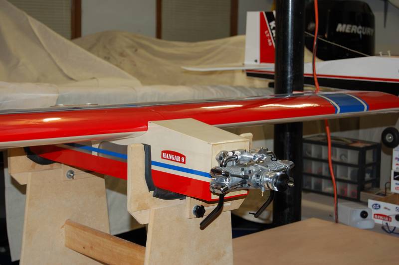

Here's the progress on mine so far. I have no idea how I'm going to run the throttle linkage yet.

Hey Hill......is the wing fully setting down in the wing saddle..............if she is bolted down she is just fine as long as the dowls are long enough..........they need to go inside the fuse a little ways. My dowls were visable, ......Sorry can't give a photo mine just crashed........had a G26 on the front, flew great.

Thats lookin great Hill...which Saito is that? I'll take a look at the motor layout and see if I can give you a little help on your throttle looking at it through another pair of eyes.

Check, sorry to hear about your crash.Yes the wing sits in the saddle fine. I cut the dowels a little long to make sure they fit in the fuse.
Rick, thats the Saito 182, not a huge amount of power but I had the engine and it needed a home. There's not much room left on the firewall to drill for the throttle linkage. The one area that is left to drill into will cause the nyrod to bend some in order to route it to the carb. i'll figure something out.

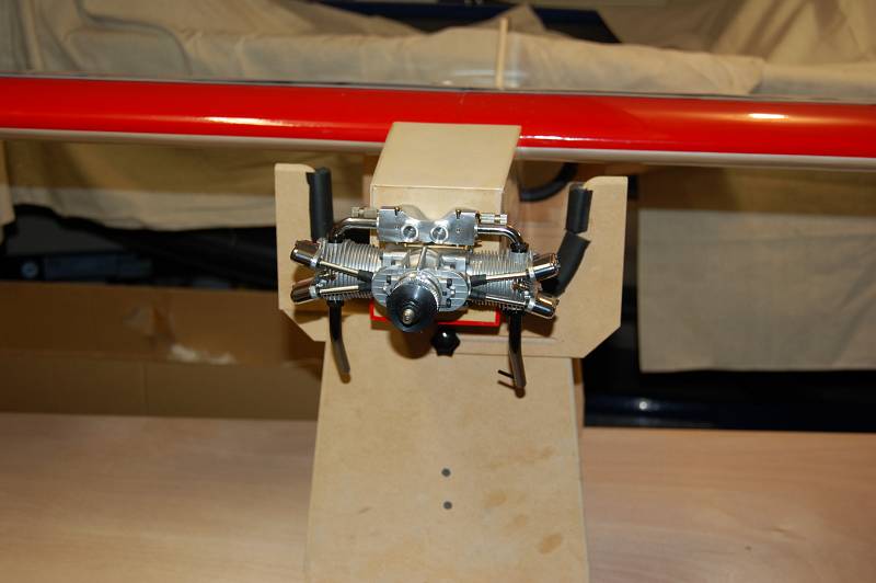

Well my build is coming along quite well...as per others posts and experiences I have moved my 220 Saito's top engine mount up about 3/8", I am using a Ohio Superstar rear tail wheel assembly, have moved my fuel tank back to just in front of the servo tray, and have mounted my rudder and elevator servos in the rear of the plane, just in front of the horizontal stabilizer. From my preliminary tests my CG is looking real good weight wise to the rest of the planes overall weight distribution.
I’ll post up some pics in a few hours to show you all how my bird is looking…

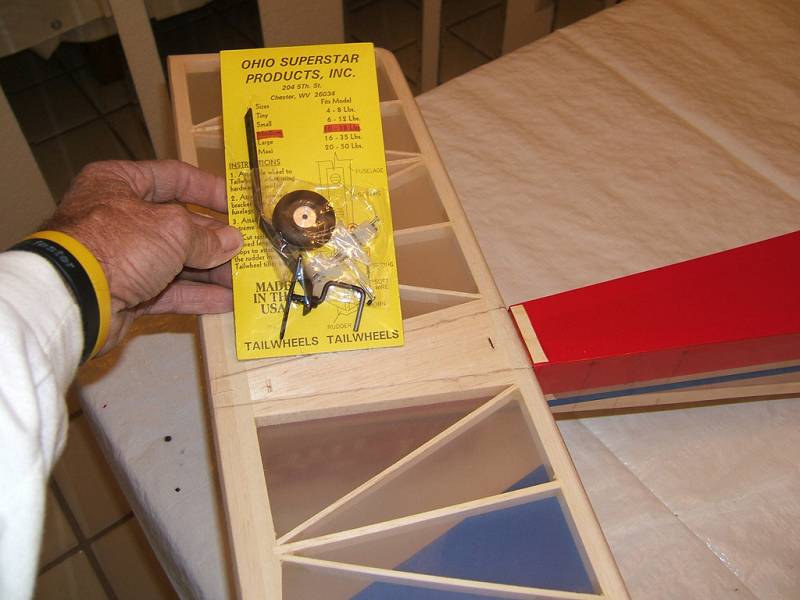

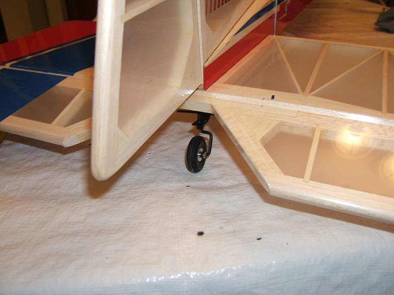

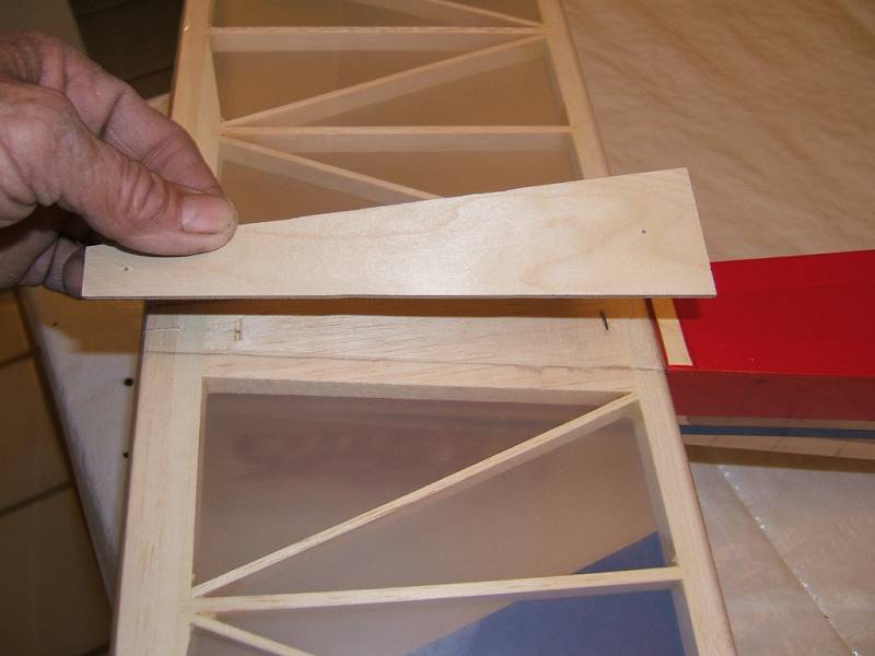

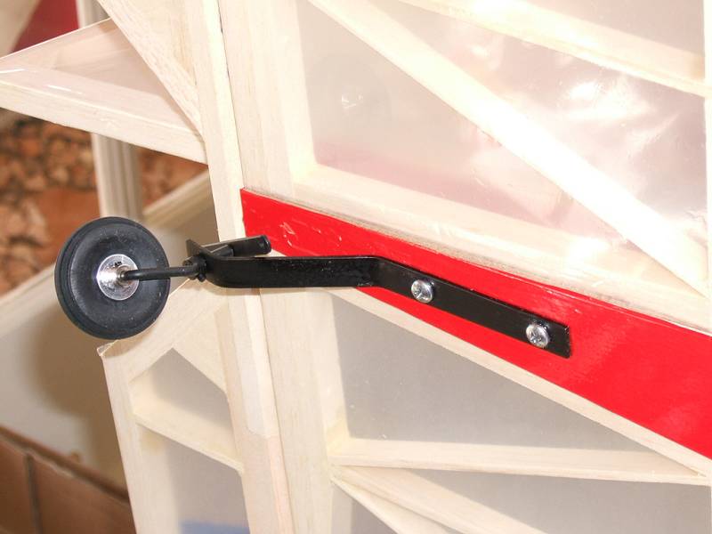

For my tail wheel I decided to go with an Ohio Superstar 8-15lbs class. To use this tail wheel I needed to beef-up the rear tail section of my US120 by adding a piece of 1/8" (cut to fit) maple ply. Here are some shots of the tail wheel area...
