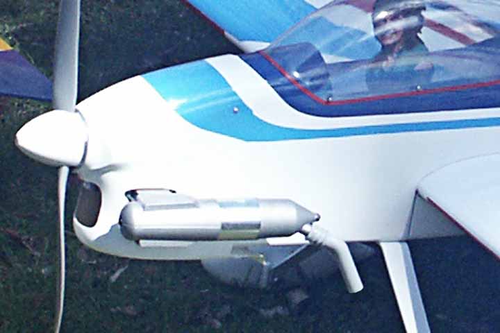

1. OS .91FX fits entirely inside the cowl except for the stock muffler (see photo).

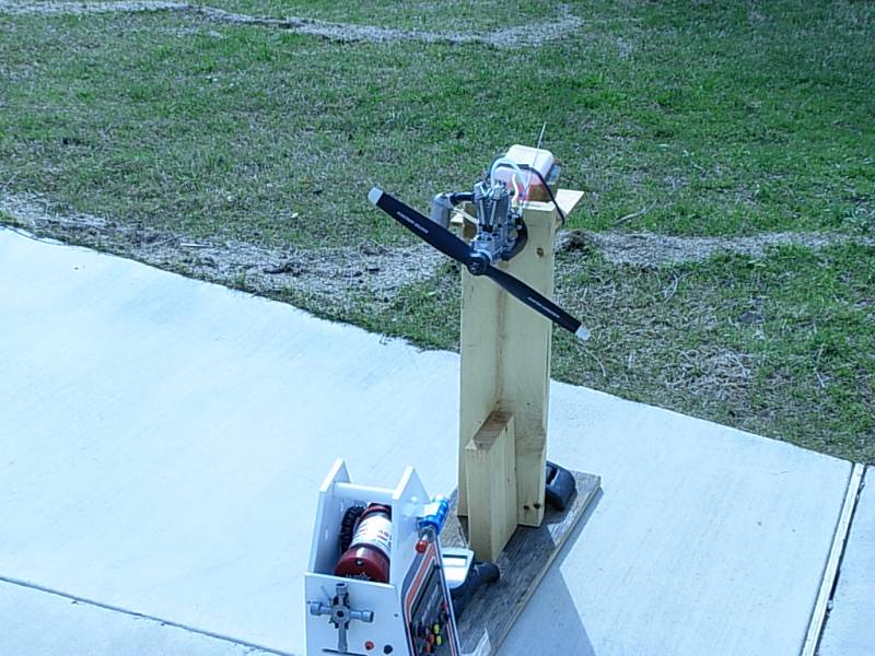

Update: I have a new Saito 125A and I think I will go with that engine instead of the 91FX.It will save some grief shuffling engines with the Big Stik. There is some information that indicates this would be OK. I have no experience with 4 strokes but this engine seems to get good reviews. I liked it because it was same size and weight as the 91FX. The weight (not to mention cost) of the 4 strokes has been the main objection. I mounted on my test fixture today and will start. breaking it in next week.
Not much build time today due to the local swap meet. Will have a little time tomorrow. I plan to trial balance the plane as soon as I can get all the surfaces to stay on.

Spent 2.5 hours breaking in the 125A. It is running very well and should do nicely.

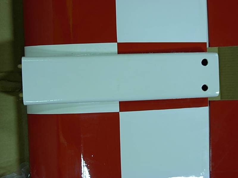

All surfaces are hinged. I added a piece of ply under the landing gear and added a 1/4x20 nylon bolt in the middle. I plan to use 6x32 nylon bolts for the other two holes. This should be plenty of support. I have found that the Fiskars paper cutter makes quick work of cutting those hinge strips.
I trimmed the covering on the bottom of the wing for the belly pan. This was not resommended in the manual and probably not necessary sinve it weighs almost nothing and there is no load. You have to be really careful on the sides, the sheeting does not come out much past the belly pan. It is easy to get too close to the edge. I saw trimming noted in a number of posts but I would recommend only trimming the leading and trailing edge areas. This will make sure there is good adhesion without the risk of getting to close to the edge of the sheeting.

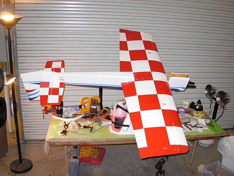

Pictures
The Saito is ready for the first start.
There is a view of the cut-away I did for the belly pan.

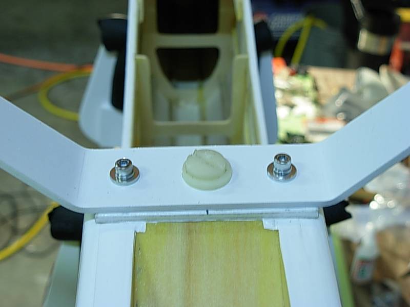

The modifications for the landing gear. There is a piece of ply added and a 1/4x20 nylon screw added to the middle. The 6x32 screws have been replaced by nylon.
