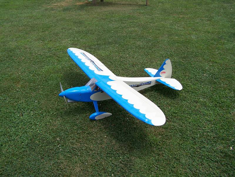

Got mine together but it was to windy to fly. The only problem that i ran into was that it calls for 4 1/2" from the firewall to front of motor and that was to short to clear the cowl. Should go about 4 3/4" but i will have to get a new mount and see.

skippy; a couple of questions if you don't mind, what size wheels does it have? and what engine are you using and how is it mounted? I fly off grass so I'm wondering if it needs bigger wheels and if the wheel pants will hold up, then I have a nib magnum 52fs that needs a home

The wheels are the stock 2 3/4" i have a os 46ax in it and it flies this plane with plenty to spare but the 52 should do well. The engine is mounted slightly down from a 90 degree. I flew it this morning in some wind and it handled it very well. Our club has a paved runway but i did taxi it in the grass and landed in the grass once and it did fine. The wheel pants are pretty strong so i don't think you would have any problems with them. I will post some pictures later that i took yesterday.

I am having the same exact problem as Pault. Using the recomended Satio 72. The distance off the firewall must near 4 3/4 and not 4 1/2 as the manual states. The engine mounts that come with the plane are bent. Horizon Hobby shipped me another pair and they are bent also. I am prob. going to order the Saito mount for the 72 (RR) and make more holes in the firewall. Not that I want to. The distance that the Satio mount brings the engine flywheel out to is 120 mm or 4.724". This should clear the cowl face.
