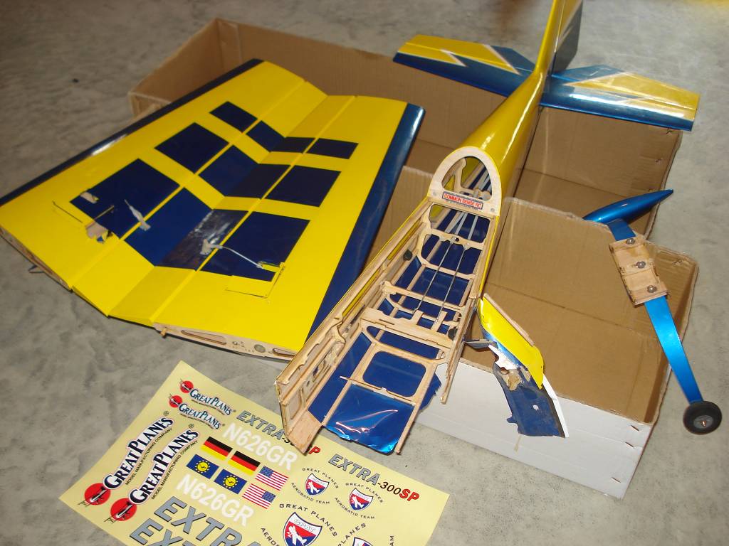

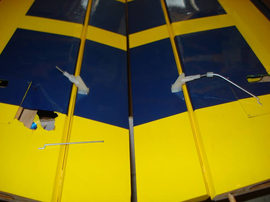

Flutter plain Sucks! Be careful of the pushrods in the kit. I sent mine in for warranty. they said it is possible that i had play in the linkage. I had No play at all! JR ds821 servos, dubro arms, and kit hardware. if anyone else is having same problem please post!.
oh and wire for this massive surface was 2-56
Best to junk the hardware on reputable companies' kits and arfs, as they do not support their product (at least Great Planes). Especially when they see it convenient to tell the moddeler that it was their lack of skills/knowledge in assembly/flying.

I was also using a saito .80 with a 14x4 prop.
i flew and went vertical from straight and level, hammerhead, then pulled out coming back, advanced to half throttle at the bottom to get ready for next maneuver, then it fluttered. I remember the guys at the field were like " woa what caused that!"...then commented on the rods after i picked up the peices. if you look at the picture you can see one rod is snapped in half at the start of the clevice threads and the other is bent at an S shape.
oh and My primary airplane is an OMP Edge 540 Hybrid with a DA-50 up front. If I were one to not practice throttle control, I wouldnt expect that airframe to stick around too long, but it is intended for 3D, and i was hoping that was what id get outta my extra too but obviously not. Thats me holding my hybrid Such an awesome flyer!
However, i cant help but feel screwed over by the warranty company... is the warranty company owned by the manufacturer???how does that work anyway?

Hello,
I am sorry to read about your experience with the Extra 300sp.
I noticed your clevis is connected to the control horn rather far in. We have had one other customer report a similar issue (but did not lose his model). We sent him the PDF which I have posted here. It is hard to say what his results were after he looked over the information, but we have not heard back from him. I have included a pic of his wing and the linkages.
I have been flying the same model (very hard) with all stock hardware, and have not had any failures. Every model is stress tested with added ballast during development...and we do not have any record of a flutter issue. With that said....there are many variables in our hobby...and sometimes it is difficult to determine the root of issues like yours.
Please feel free to email me directly, and I will look into your situation with our service department on Monday.
Again...I am very sorry to hear about your model, and I hope sharing some of this information can be helpful to others.

Myself I have owned and flown many GP models. Even on my U Can Do .46 I used HS 5945 servos (180oz torque) and had CF pushrods with 4-40 hardware. Having owned several U Can do's and similar smaller models its a night and day difference using ball links and heavy duty push rods vs. 256 rods.
Looking even at the GP setup from their R&D I would never used a bent rod like that. I would use a clevis at the servo and the control surface end. If the control rod has even a slight amount of flex without the plane flying then you can imagine what happens when you stress it in the air.
Even on the smaller models I would seal the control surfaces for ailerons and elevator halves with at least packing tape.
