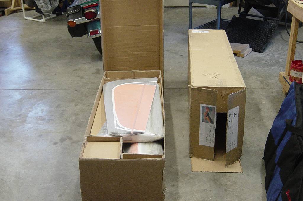

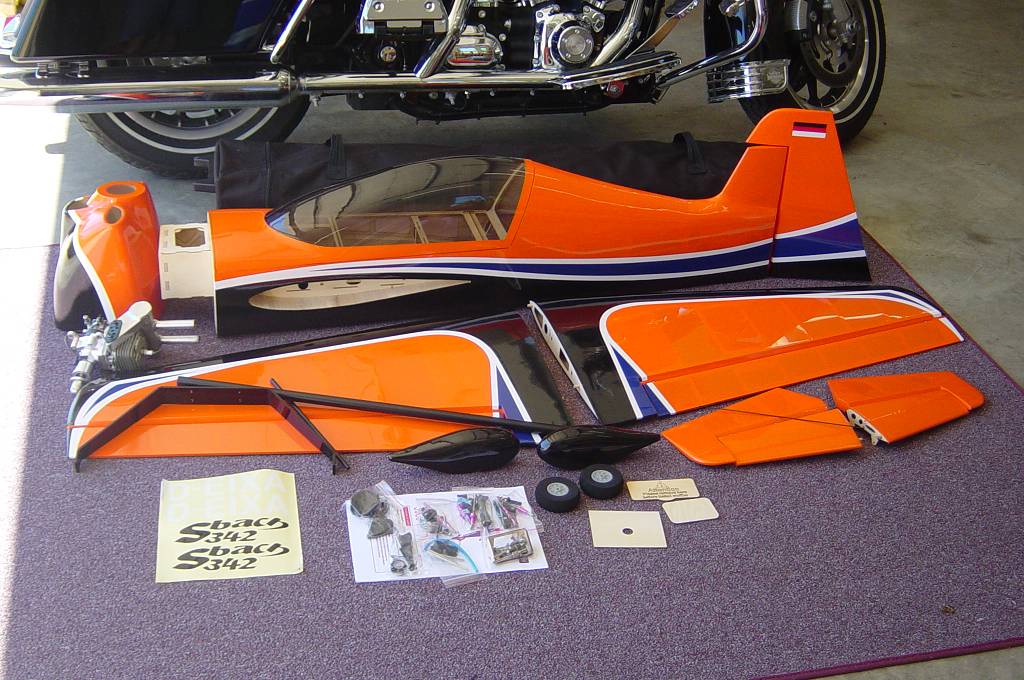

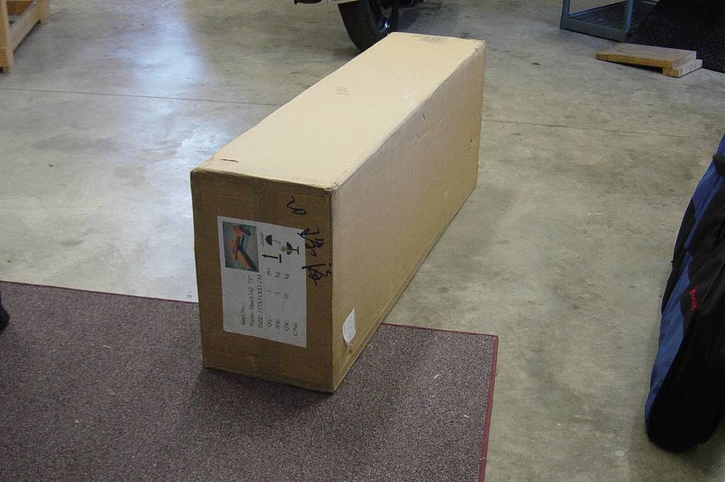

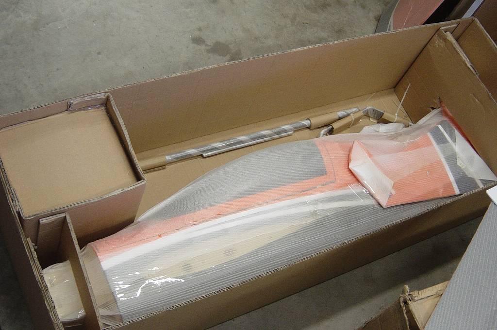

Here are the pictures of the package and the un packing Stage.
The plane came in doubled up cardboard boxes. and Fed Ex did a nice job delivering it in one peace.
The Planes covering was in excellent shape, did not find any wrinkles anywhere.
the Hardware package looks to be of High Quality and came with turnbuckle push rods and ball links. I'm going to use all the Hardware that came with the plane.
Most of all I like the Smily Face Cowl.

Hi
The last picture ,......................... is that youre JC 28 , with a J-Tec wrap-around . Whats that weight doing on it ? And please stop distracting me with that Harley

Yes that is the JC-28. And I would never try to distract you with a Harley

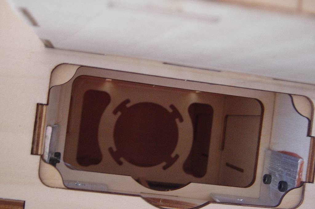

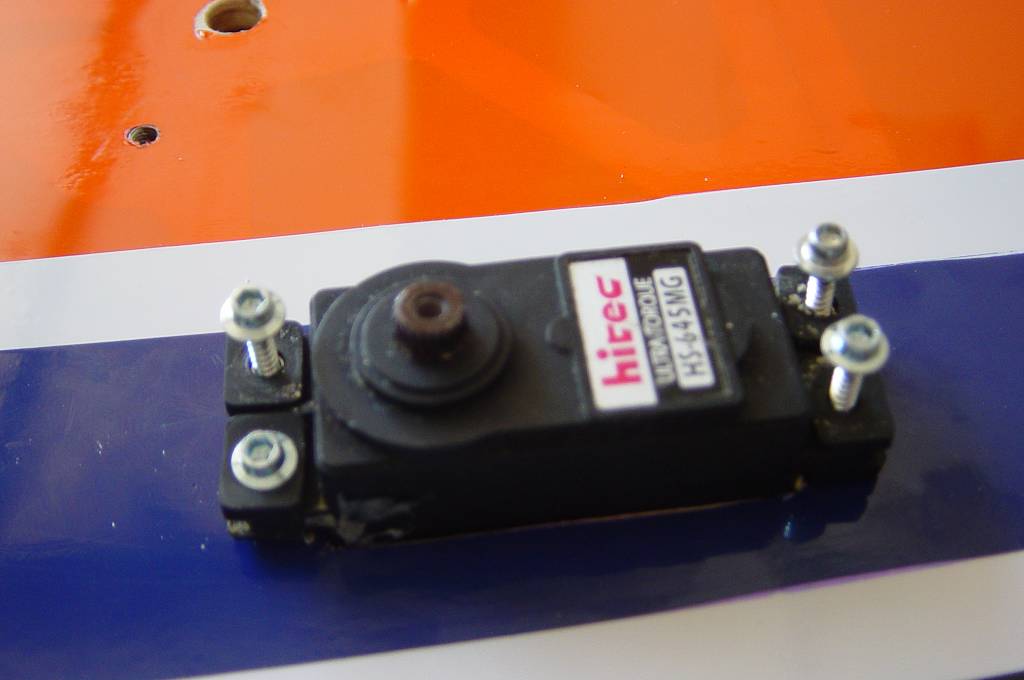

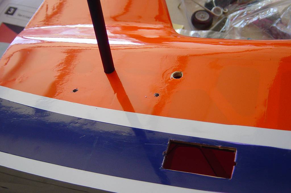

I did get a little bit done on it after supper.
It did have a few bubbles in the covering on the fuse. They were hard to see till I started to go over the covering with the Iron.
I was pleased to find triangle reinforcements for the firewall.
I got the covering cut out and the two elevator servos mounted and the wood is hardened around the stab alignment dowel and the servo area with CA. I'm going to try and mount the engine tomorrow after flying. Man can't live by building alone. Then I'll fuel proof the firewall and inside the wing socket with 30min. Epoxy thinned with 20% alcohol. It is amazing how much more strength it gives to the wing socket. Also planning on pining the firewall at that time.

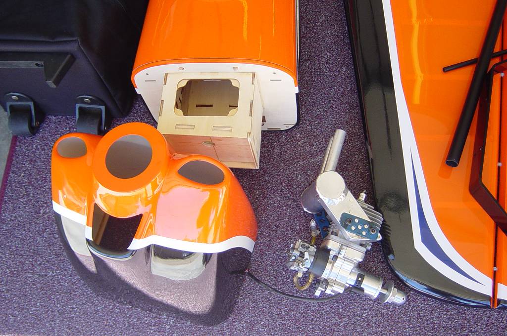

I have piddled a little with the engine mounting. Looks like It may not be so easy.
The prop hub is a little short for this air frame but worked great on the Cub. I may have to cut the front of the cowl out for the engine to fit. I don't really want to ruin that great Smile. Will see what I can come up with tomorrow.
Also the instructions aren't that good. It it's better if you have built some planes of this stile before you attempt this one. The plane itself builds just like the rest of the ARFs that I built before and is not anymore difficult then the others.

Quick Note - IDOhave a build video, but it won't be done till tomorrow. Then I'll have it online. It will make it easy to put together for even the most novice.(Ithink!Feedback appreciated).
Yeah, the firewall was moved back for that "other"engine...
I'm with ya, Ihate to cut out the cowl too, but that's the one thing with the JCon this plane, is that the cooling head is go close to the prop hub, that you are going to HAVEto cut that out, ORif you get a machine shop to cut you an extender somehow?Not sure if that would work (if the thread on the engine shaft would be long enough or not?)
IFYou do deicde to just use the hub where it is on the JC(this will mean moving the engine up about 20mm), I would cut blocks of 1/4"plywood. See my horrible digital drawing!Start with 1 1/4"x1 1/4", then 1x1, then 3/4x3/4 for example.This will give it a firm seat on the firewall, and use a smaller amount of wood. I'm not sure exactly how many you'll need but this is the idea.

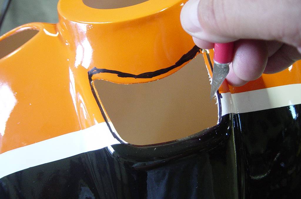

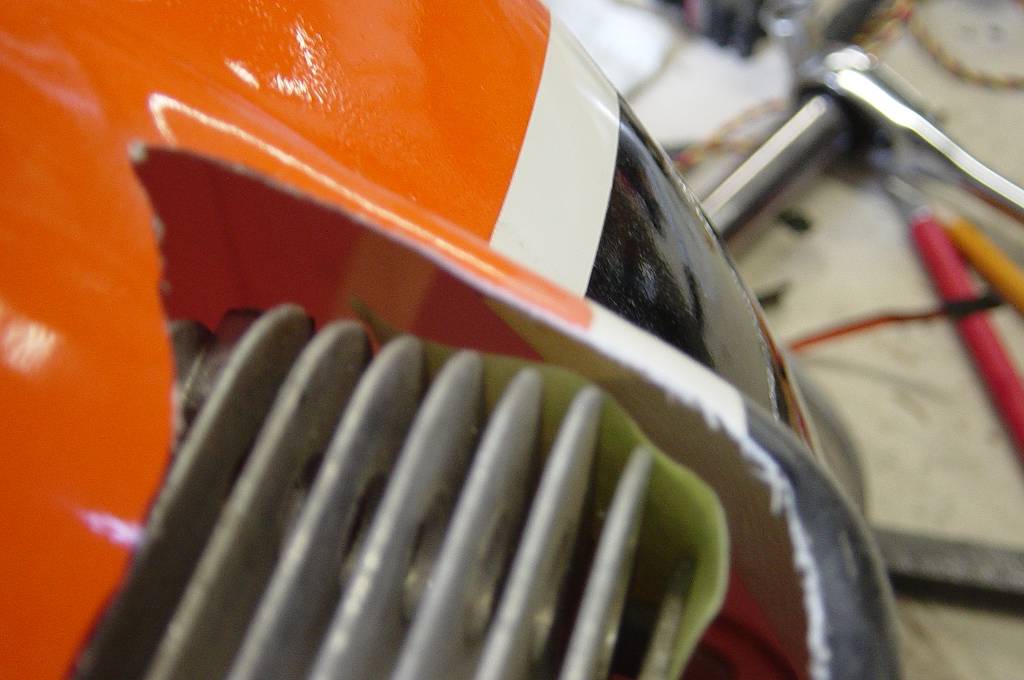

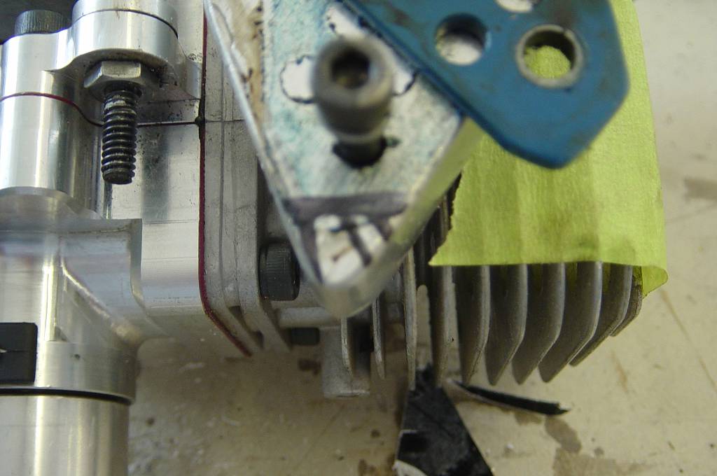

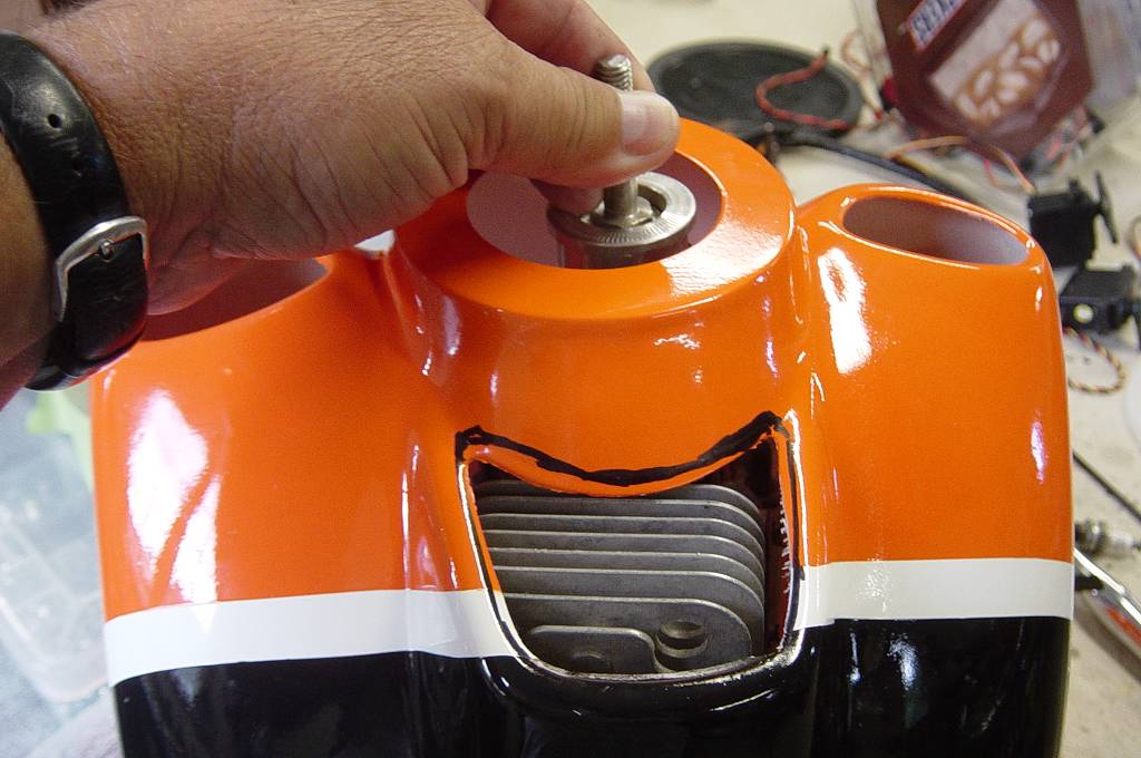

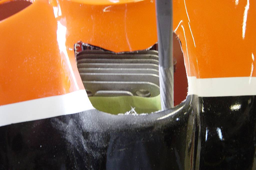

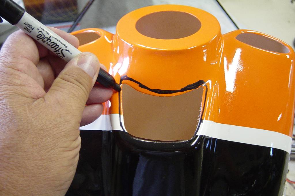

This morning While topping off Batteries to go flying. I decided to take a closer look and found that you will be able to use the JC-28 in the Sbach without much trouble. As it turned out I took more then I needed to on the top of the smile. I didn't need more clearance in the corners of the smile. Remember that when you guys are doing yours,

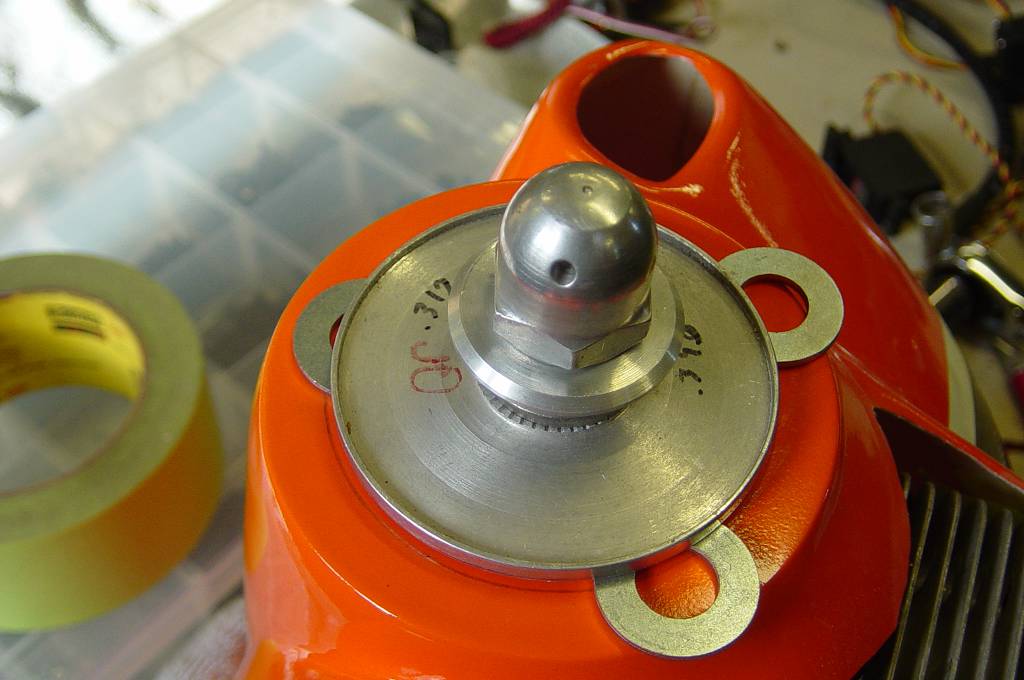

This is the first step in mounting the engine. Centering it up to the Spinner.I didn't have the right size on hand so I had to improvise. I used a smaller one centered it and drew a pencil mark around it so I can keep it Visually centered while I cut clearance for the cooling fins. On My 50cc planes I found that you need around 1/4 in of clearance between the finns and the fiberglass or the vibration is going to shake the glass and the finns together and will crack there.
First I put a black marker line for an outline to go back to. I used an Execto blade to carve some of the glass away then went by hand with a file to get it closer to what I needed. This is just roughed in and I used a round and a flat file to get what I wanted. Now I'll finish the edges with sand paper when the time comes. Have other clearances to cut first.

Tom, I should have just done the JC 28 on the prototype! That looks cool with the fins right there! And the quality / cost is fantastic on the JC.

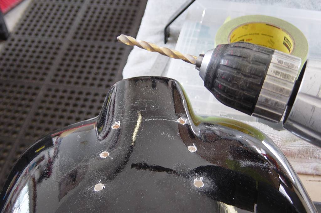

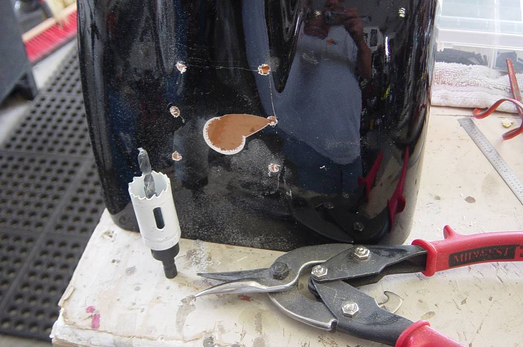

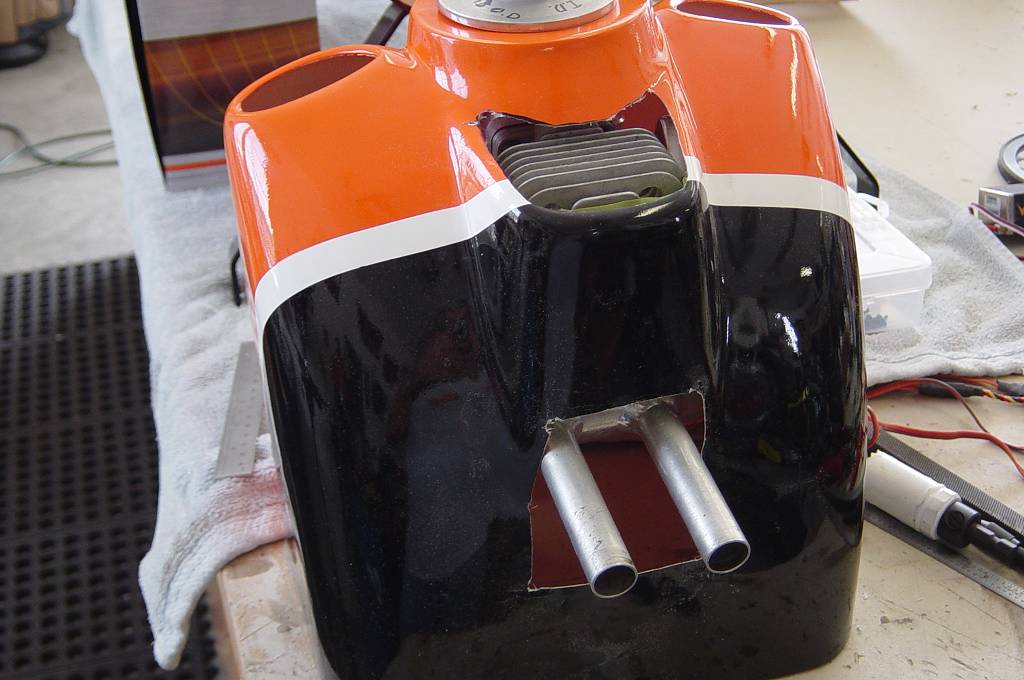

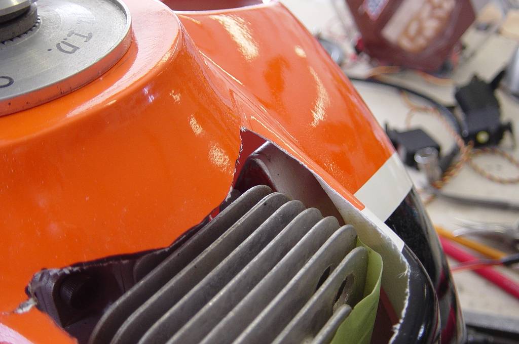

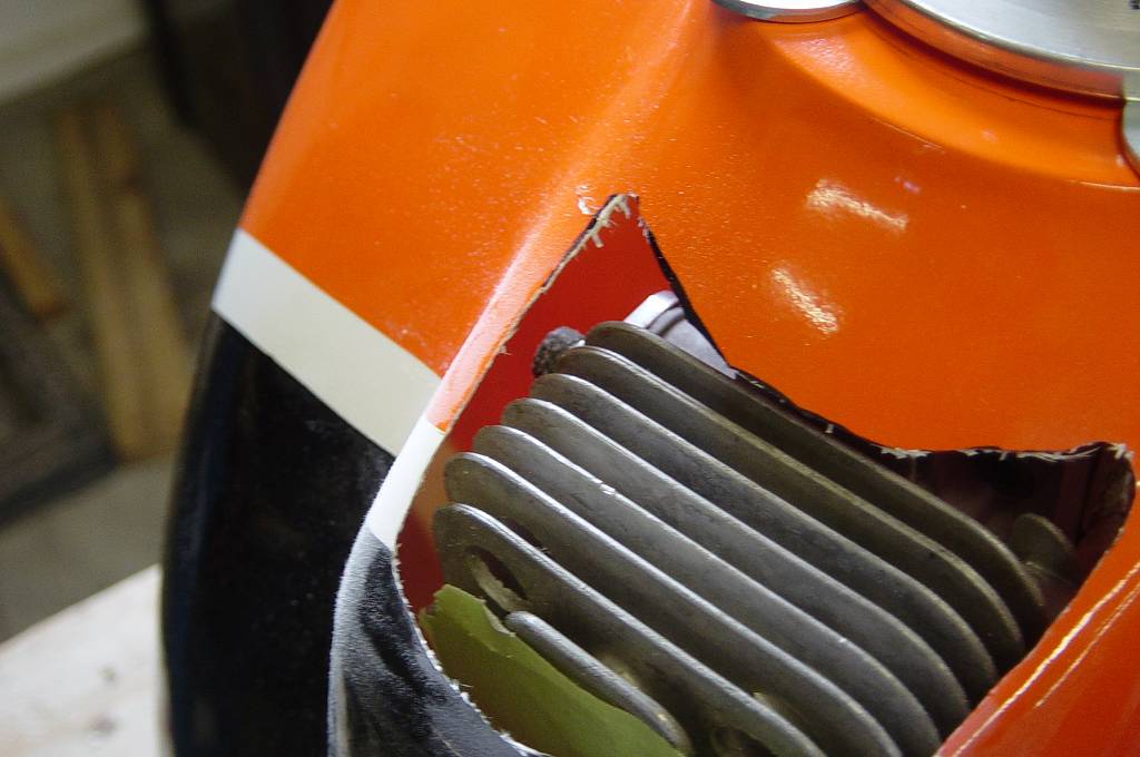

While in piddling I decided to put some rough clearances in for the J=Tec muffler. I'll pick on it first. All the manufacturers of these mufflers don't take into consideration that these mufflers have to fit inside of cowls. Most of them extend to far in front of the front mounting screw. I've had this problem before. I'm one of the lucky ones that can fabricate and even weld aluminum. If you will notice the front of the cowl is touching the tip of the muffler. I have it marked and will reduce this area as needed. I have in the past cut a hole in the cowl to clear that area and it cracked. So this time I'm changing the muffler.
You can probably guess by now that I don't like to use a dremel tool for grinding fiberglass. I try to avoid F/G Dust at all cost. It makes me itch. So i used a drill to outline the corners and then a hole saw to give me enough clearance so I can get my tin snips in there to cut the clearance hole for the exhaust. Will be nibble ing on this in the future.

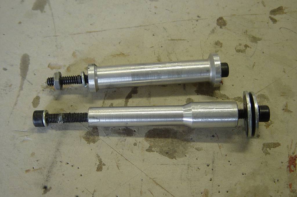

I also need 3 1/4 in. standoffs to properly set the hub of the engine. This is my second gripe. If JC would have made the prop hub 12mm longer I would have been able to have the engine mounted already and wouldn't have had to butcher up the cowl. It doesn't matter how well Henry or Milton listen. Roomer has it that Standardizing falls on def ears at JC. So this problem will probably never be solved. Even if you say that you know other engines already do this.
I don't have Standofs that size but have some longer ones and the rest I'll make up with Aircraft Ply. Lite ply is no good cause it crushes to easy.
Thats it for now.
