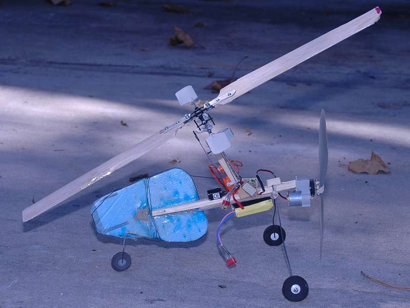

Finally got around to finishing my electric autogyro design.
Spend a morning messing with trim, finally added a third
cell to the battery and flew all around my street.
Around 12 ounces. No horizontal surfaces at all.
More details if anyone is interested.
Picture attached.
m. nowell
longwood fl

Hopefully I will post a flying video by the end of the week.
The fly in @ Spring Hill, Is it at the field
on the Boy Scout Reservation? There are two of us
here in Longwood that plan on attending. The dates
look like a Thursday and Friday, is this correct?
What kind of pictures? Other views or details?
I have repaired my blades, since I created a few dings
learning to fly this thing. I did manage to get it trimmed
and learn to fly it on one set of blades.
I did learn several things in the process:
1) Don't horse it off the ground too early.
2) Enough power is important. The inital flights
with the two cell lithium (1000mah) would barely climb out.
This made for some intersting moments trying to
clear the 75 foot oak tree at the end of the street.
When I swapped in the 3 cell 1200, it suddenly was
a whole new aircraft. Flew around the neighborhood
and landed in the street.
3) My 30 foot PVC extension pole will reach to the top
of my neighbors palm tree (see #1 and #2)
I have left myself the ability to add a pre-spin mechanism
with this model. (Running down the street with the gyro
makes my neighbors look at me oddly.)
I have not seen anyone doing this on this
forum. Anyone have any experience?
BTW this model is $35 worth of GWS Dragonfly helicopter parts
and the rest is out of the junk bin. I think anyone can repoduce it.
Blades are 12 inch, balsa with 1/32 ply root reinforcements, TLAR
airfoil and weigh 8 grams each. I'm not entirely pleased with the
rotor speed changing so rapidly in flight so the next set will probably be
weighted some.
The blade attachments are thin steel, so the blade angle and blade
tracking are easily adjustable.

Flew 3 more times this morning after repairing and lengthening
the rotor blades. Went from 12 to 14" and covered them with
chrome monokote trim sheet. Made a longer tail skid to improve
the previously awful ground handling.
Longer slick blades added some performance, now can cruise
around about 80% throttle.
Launches are improving due to operator skill level increasing.
Landings still have some work to do as shooting the hole
between the pine and sycamore tree is a little exciting.
The good news is that I have good control at all speeds,
from takeoff to touchdown.

Default RE: My electric autogyro flies!
Are you using rudder control?
Wahid
Old 11-10-2004, 11:02 AM
mnowell129
Join Date: Aug 2004
Location: longwood, FL
Posts: 469
Rudder, yes. Also steerable tail wheel.
Also roll and pitch through the head.
Full three axis control plus motor.
Two successful takeoffs yesterday, plus
several hand launches.
Two long flights today until something broke
in flight, should be back in the air by tonight.

This gyroplane inspires me greatly. I would want to build also something as simple as this but I'd like to build the head by myself. Is your gyro following the "CG just ahead of the main shaft axis" rule?
Thanks for sharing the vids. I would have hoped them to be a little longer ones... Just interested to see more of your gyroplane flying
It seems to have much power. How much watts does the motor take? What is the flying weight?

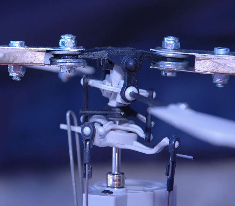

I just veiwed your landing video and I am still wondering if all your neighbors are afraid of you or just asleep. Being an electric helps.
I was wondering , are you using the heli setup to change the pitch of the blades? How are you pre-spinning the blades?

I considered building the head myself. I had built one years ago. However
the GWS dragonfly parts are so inexpensive it seemed silly. The entire head,
swashplate, linkages, head bearings, etc. came to less than $40. I assembled
it in about 15 minutes. I took longer to make the shaft mount and anti-rotation
loop than it did to build the head. I included a closeup photo if you want to
reproduce it yourself. There are however simpler head designs that accomplish
the same thing and can be found in the various model helicopter design books.
As to the CG. When I hold the gyro by the rotor(flybar actually) it hangs
such that the rotor mast is vertical, i.e. nose down. I have flown it
with various CG configurations by moving the battery and it doesn't seem
to matter a whole lot where the CG is within a range. It gets a little "pitchy"
with aft CG but not impossible to fly.
The flying weight is about 12.1 ounces (342 g). Total rotor span is 26-1/4".
The power plant is a GWS EPS350, "D" ratio, with an APC 10x4.7 slow flyer prop.
The Motor is slightly retimed as has been widely published but if need be I can send
a photo of exactly how much retiming I did. It is a simple matter to twist the end bell
with snap ring pliers.
Speed control is the Castle Creations pixie 20 P.
Battery - Apogee 1050 3S1P ( 3 cell ).
I think the motor draws in the 7-8 amp range in this configuration so
I believe this about 75 watts, likely 40 delivered to the propellor.
I considered putting one of my brushless setups in so I could use a smaller
battery but decided to hold off until I build a new gyro that I spend more than
two hours building. The chassis is pine stock cut on the table saw with no
attempt at lightening, the next one will be lighter.
Thanks for your interest.

Yes indirectly, I am using the heli setup to change the pitch of the flybar, which in turn
changes the pitch of the blades. This is what alleviates the control forces
and slows down the response. The short flybar with small paddles has
a slow contolled response to input and the main rotor follows suit, like
a slave servo mechanism. I posted a closeup pic of the setup in another
reply. The swashplate applies cyclic pitch to the flybar, the flybar then precesses
like a rotor would. The flybar is linked to the main rotor and applies cyclic through
the little short links. THe main rotor then follows the flybar. If the main goes too far
or gets gusted around the linkage applies the corrective cyclic to bring the main rotor
back in line with the flybar. Because the flybar is very stable the whole rig is stable. The
main head is therefore very simple semi-rigid rig, with no flapping hinges, delta-three etc.
It only has the teetering bearings to allow the flybar to manage the main rotor cyclic.
Because the head is semi-rigid you get good control authority. Seems to work like a charm.
Pre-spin is by hand flip when taking doing ROG, or no pre-spin
when hand launching (just funny running).
thanks for the questions.

I have still pics of my rotor airfoils cross
section if anyone wants to see them.

High resolution side view of the electric gyro.
