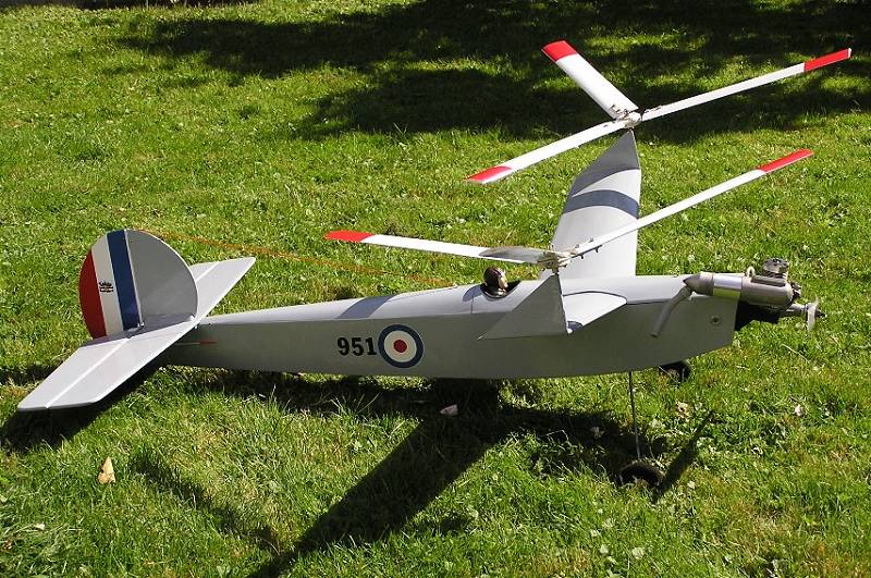

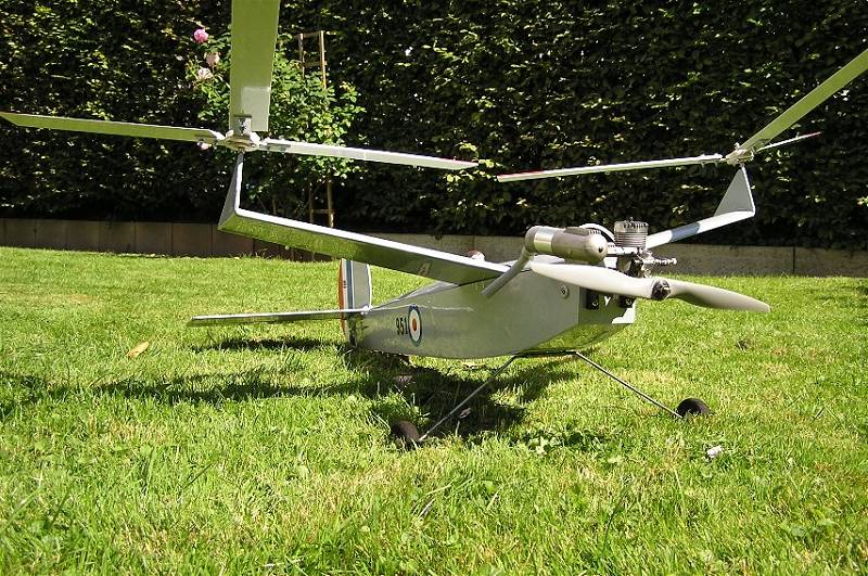

Join Date: Nov 2005
Location: Aalen, GERMANY
Posts: 24
RE: Problems with the Tango Autogyro
Hi Phill!
Thank you for your help.
Here are some pictures of my new built rotor head and blades.
A Merry Christmas!
A Merry Christmas!
Join Date: Feb 2002
Location: Wimauma, FL
Posts: 511
Hi,
Looks good. However, you will get more lift from the blades without the coning angle. The coning angle adds stability to a single rotor gyro but doesn't help with dual rotors.
Phil
Phil
