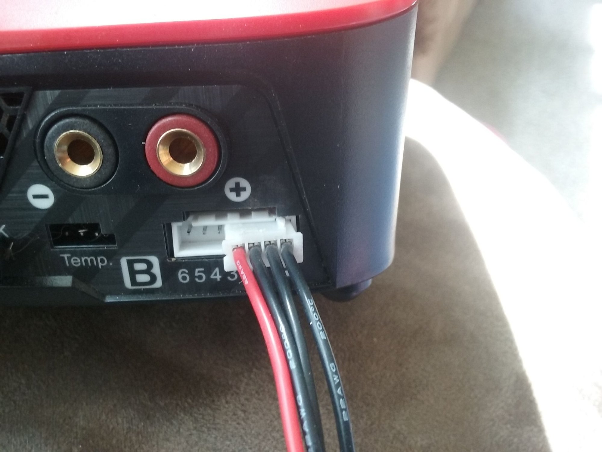

Hello everyone,
Recently I bought a Hubsan Zino and to be able to balance the batteries better I want to buy a SkyRC S65 (2-4s). Zino's batteries are 3s. In order to charge the Zino battery, we need to make an adjustment on the connector welding a banana or XT60 connector to pins 1 and 4:
The problem is. Zino battery cable has 4 pins and S65 cherger has 5 pins [4 3 2 1 -].
Can I just ignore the fifth pin of the charger and use only [3 2 1 -] pins? In this case IŽll make a cable with jst-hx 4 pins in one end and jst-hx 5 pins on the other end.
I see people using the SkyRC iMAX B6 mini because it already has output to the various cells. I prefer to choose the S65 because it connects directly to the power outlet without the need of power supply.
Thanks in advance.

I skip the whole JST-XH balancing board adapter, and just plug into the charger's balancing port. I just grind down the left tab/guide on balancing plug.
3S balance plug (four wires). Left tab on plug is taken off with Dremel tool, or Xacto blade.

Bingo
Take another plug like in the picture. Cut it down to be put into those unused pins showing. Will prevent a accidental wrong plug in. A touch of tape or glue would hold it in place.
