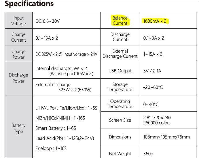

For me, it's all about specs and ability. Every time I buy a charger, I learn some things about specs and my needs. I started out in 2010 with 2S LiPo packs and iMax-ish 80watt chargers. Many RCs, and 4S packs later...one needs a charger with better power to be able to run non stop all day long. I am happy to be able to charge a 4S, or 6S pack at 2C~3C charge rates. A 15Amp charger will do me well. Stock/spec class racing is always about pushing the limits of batteries and motors. If I plan to get back into spec/stock class racing ("money pit")...I'll head in the direction of a iCharger 30A~40A charger for sure.
The spec that I now look at when picking out a charger is IR (internal resistance) measuring, and balance current. Balance charging is sometimes a waiting game at the end of a charge if cells are not close. The charger (arriving at door step shortly) I just purchased, has a balance current of 1600mAh x 2 (dual port charger).
That's three to five times faster than my past chargers that were only in the 300mAh ~ 500mAh balancing range. A lot chargers out there fall into the 300mAh ~ 500mAh range.
