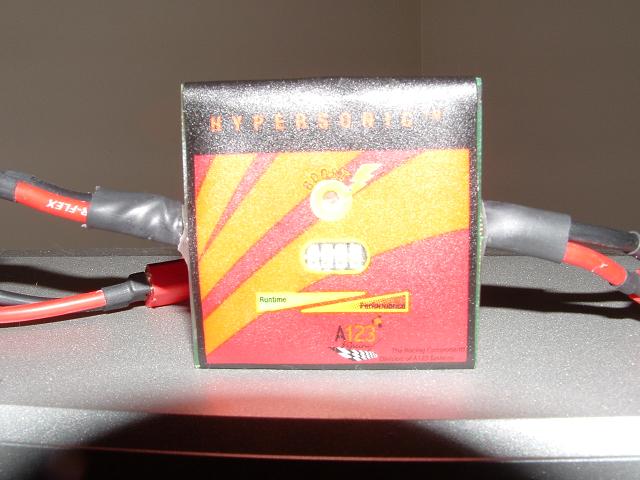

A123 recently sent me an updated Turbo Module in exchange for my old one. I apologize for not having many of the details (A123 is probably updating their documentation) but I was told:
[ul][*] Max Current Capacity Increased[*] Thermal Shutdown logic @ 100C (That's 220F)
[/ul]
Physically, the module looks exactly the same as the old version, but the similarity ends there.
Over the next week I'll be posting individual settings results for running the new module in my HDE 450. For those new to the thread, here are some shots of my project:

The Turbo module isn't for everyone. Your typical 11.1V (3S) Electronic Speed Controller will be unable to handle the voltage output of the Turbo module, even at it's 10.8V setting. If you have an ESC that can handle the output supplied by the Turbo Module (such as a Jazz 40-6-18) A123 allows you to select from one of 4 voltage settings:
[ul][*] 1 Light - 10.8V[*] 2 Lights - 12.0V[*] 3 Lights - 13.2V[*] 4 Lights - 14.4V

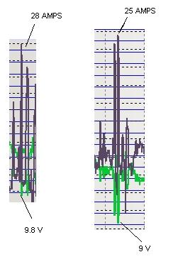

Consider the following charts (shown in a previous thread)
Voltage Cut off Relaxed
One of the biggest benefits I see in the new turbo module is its ability to manage the voltage dropoff much more effectively than the original release. It's almost as if it's acting pro-actively watching the voltage drop in preparation for the ultimate drop. I bet they've got some sweet assembly code managing that trend, and it appears to be working very effectively.

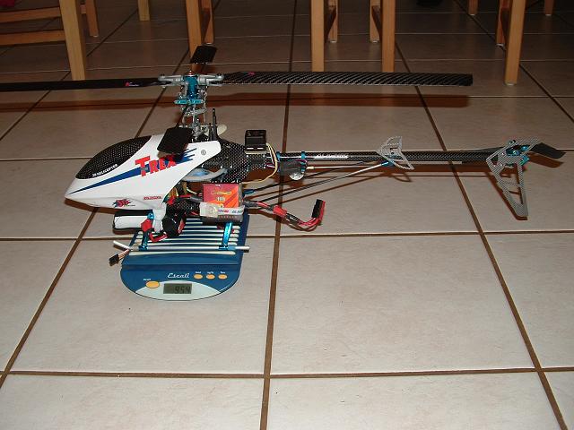

So long as you can handle the extra weight (mine comes in at a a hefty 954 grams) A123 can deliver on their promise for variable voltage which translates to on the fly variable Headspeed for us heli addicts.

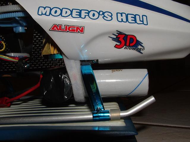

My T-Rex

Modified 2300 3S pack
Original Turbo Module Voltage Cutoff
Measured 5 VOLT DROP in under 10 seconds
New Turbo Module Voltage Cutoff
Measured VOLT DROP from 12V down 11.5V at 4.2 minutes then a gradual drop down to 9V over the next 90 seconds

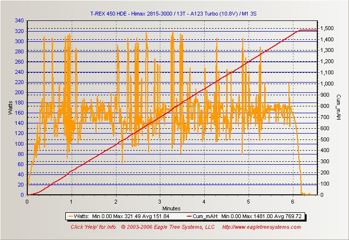

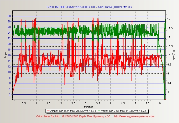

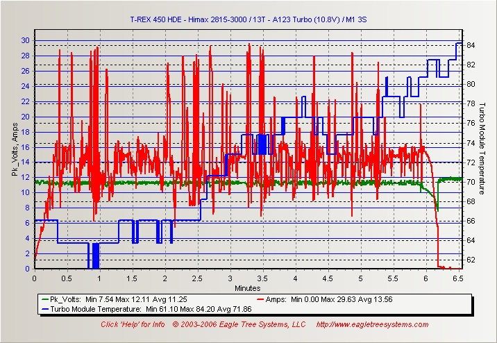

10.8V Flight Data
Measured 0 pitch Main Blade Headspeed: 2,790 RPM
Ambient temperature outside was 55.9F.
Volts and Amps
Watts and Cummulative mAh
Amps / Volts and Turbo Module Temperature

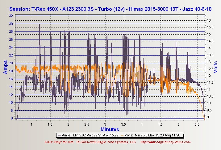

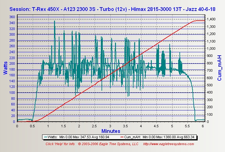

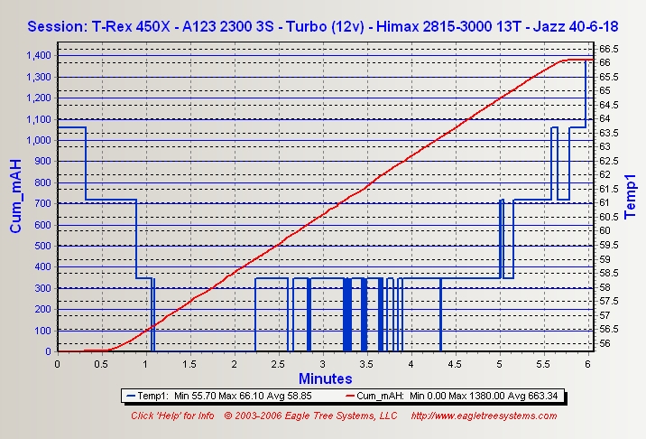

12V Flight Data
Measured 0 Pitch Headspeed: 2,910 RPM
Note: It was a mere 55F here today.
Volts and Amps
Cummulative mAh & Watts

From that data I calculate an efficiency of the turbo module of
- 80 % at 12.0 V (Wh)
- 56 % at 14.4 V (Wh)
In the later case 44 % of the Wh of the accupack are turned into heat.
I think this underlines kraeterbutters and my point of view.
