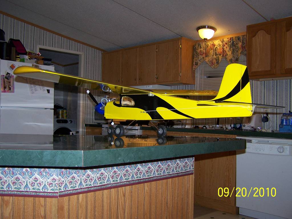

Guys I was given this plane that my wifes father built in the 80s. He and his son were going to learn to fly but they were forced to move and it never got flown.
He died having it never being removed from the crate they built to ship it in. I am honored that my brother in law decided to give it to me.
I have gone over it with a fine tooth comb.I am nearing maiden flight but I would like to know what it is, I know it is a SIG, other then that I am clueless. I also would like to know what is the proper CG for it if anyone has any idea. If not ill put it at the spar.
All the radio gear was Kraft AM stuff and servos were all seized. It never had an engine I am using an old magnum .52 4 stroke seems like it should be perfect.
If you guys could be of help on the ID and the CG and maybe any idea what the cowl is supposed to look like....... I thank you very very much.
*edit* Lol do not worry the blue spinner is history, it is wearing black now.

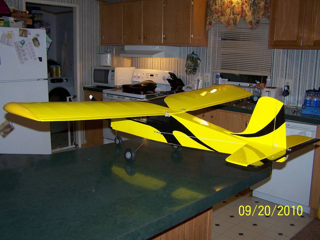

Cannot ID the plane but that elevator push rod set up with the rod exiting a gap in the rear fuse is classic Carl Goldberg design. I remember it from my Gentle Lady glider.
Maybe if there is some sort of display of old Goldberg designs.

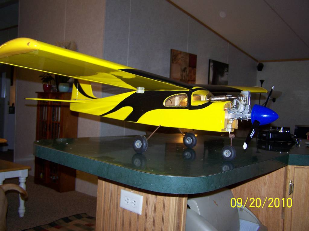

Thanks everyone, knowing what it actually is, well thats nice, where should I put the CoG before I fly ??

John, I only have the magnum 4 stroke to work with at the moment, I will be turning large diameter low pitch, have several variations to try.
Any suggestions are welcome. It is a really big deal to the wifes family, they do not part easily with treasures from Dad. I really took my time making sure it is solid.
It seems he really knew what he was doing and took care to build this thing well. Thanks all.

Other Sig trainers balance on front of main spar.
Have flown a Magnum 52 on a Seniorita. Should work fine if you throttle back.

One thing that the original Kadet really needed, but SIG never made the change until some later versions, is DOWNTHRUST.
Your Kadet, especially with that BIG engine, needs a minimum of 5° downthrust. It will make the flying and trimming a whole lot easier. Using the standard .40s of the era, early '70s, the downthrust did not fit the cowls, so mostly we convinced the newbies to rid themselves of the cowl and set the downthrust in. Those that refused to do so, usually crashed quickly (no buddy cords back then) and had to rebuild.
The downthrust allows the engine to pull down when powered up, and revert to trim when at idle. You will trim some "up" when under power, then when you idle back the trim takes over and the model doesn't try to dive out of the sky. You can either play with the downthrust and get it fine tuned or just try some and go with a "Good 'Nuff" amount. But a straight thrust line will allow that flat bottom wing to make life "Interesting".

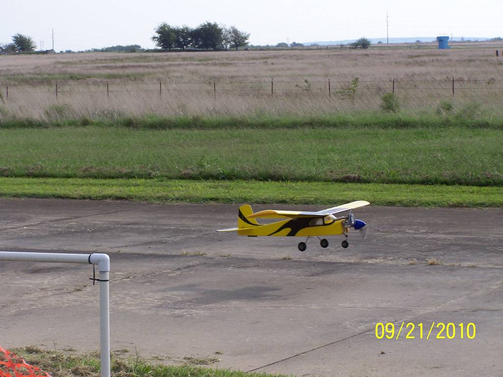

I took it out today, trimming was....interesting.... I finally got it flying really nice. I like this plane, and it is good that the wife was there to see "dads" old plane.
The Wife is getting good at catching photos of things. That makes me happy LOL
Forgive the state of the field, we have like 3 people that use it currently, more members but no one goes out..ever......before I had my heart surgery it was better. I was mowing regular at least
