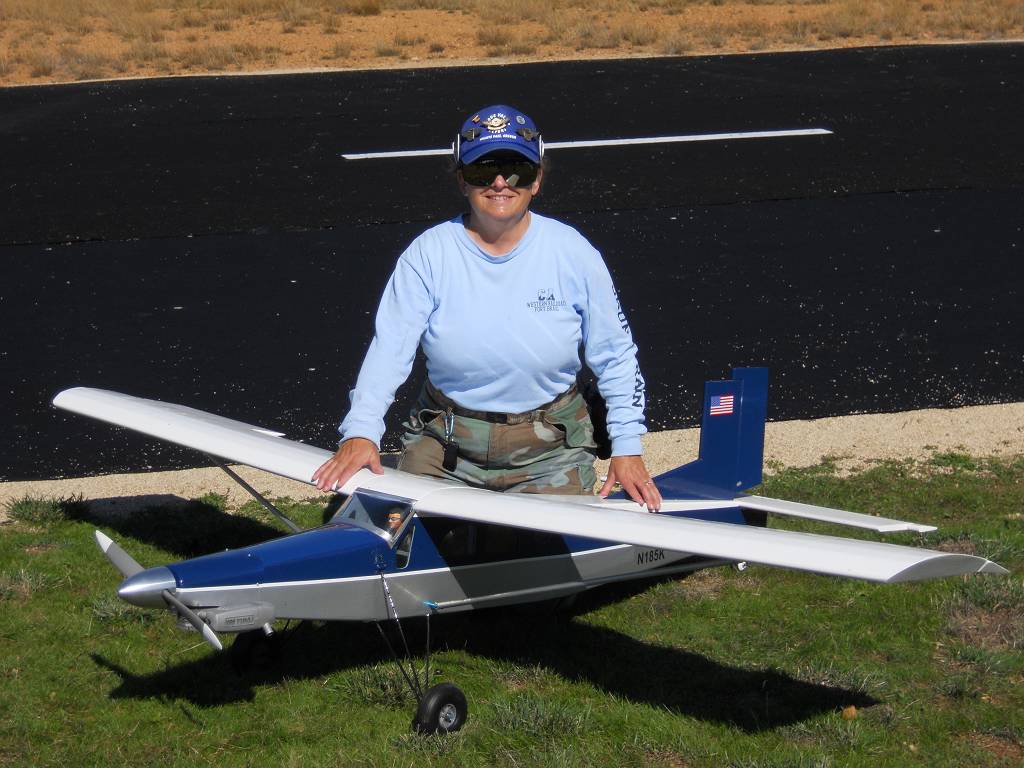

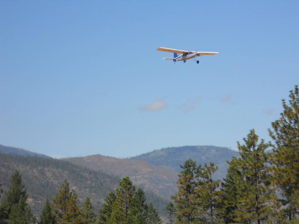

This is my 96" Wingspan Turbo Porter. It weighs 10lbs and it has a OS 1.20 AX engine with APC 16X10 prop. I flew it today for the first time in 8-10 mph winds. The wind had so little effect I hardly noticed it. I think you find a 10-11 lb 120 size Decathlona pleasant experience.
ID:	1510634   Click image for larger version

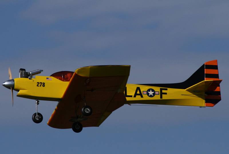

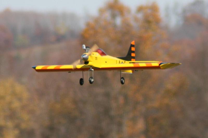

I guess my wind fighter is my Contender 60 (though my Giant Super Sportster can handle anything I'm apt to fly in).
Narrow wingspan, no dihedral, symmetrical airfoil, relatively small vertical stab, plenty of power. Trike gear does make landings easier but Idon't care for it on any model on a roughgrass field as it can make take-offs rough.
ID:	1510922   Click image for larger version
