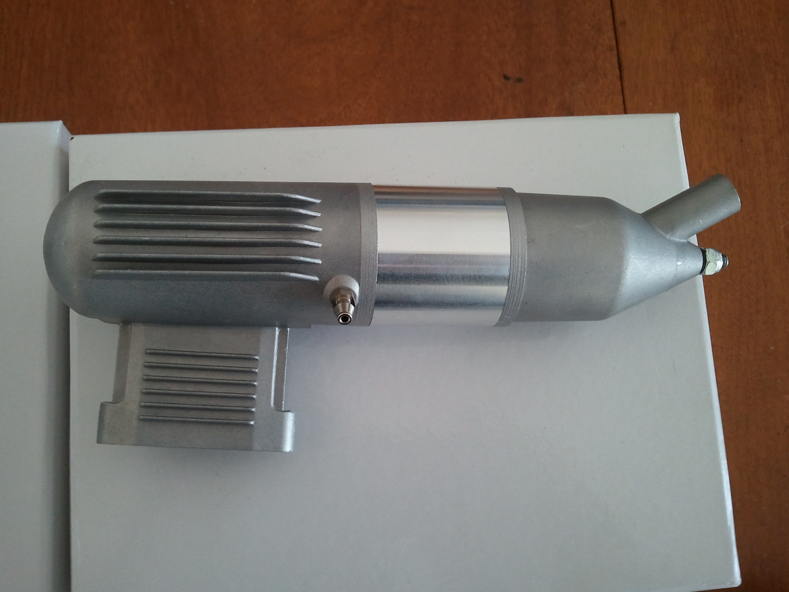

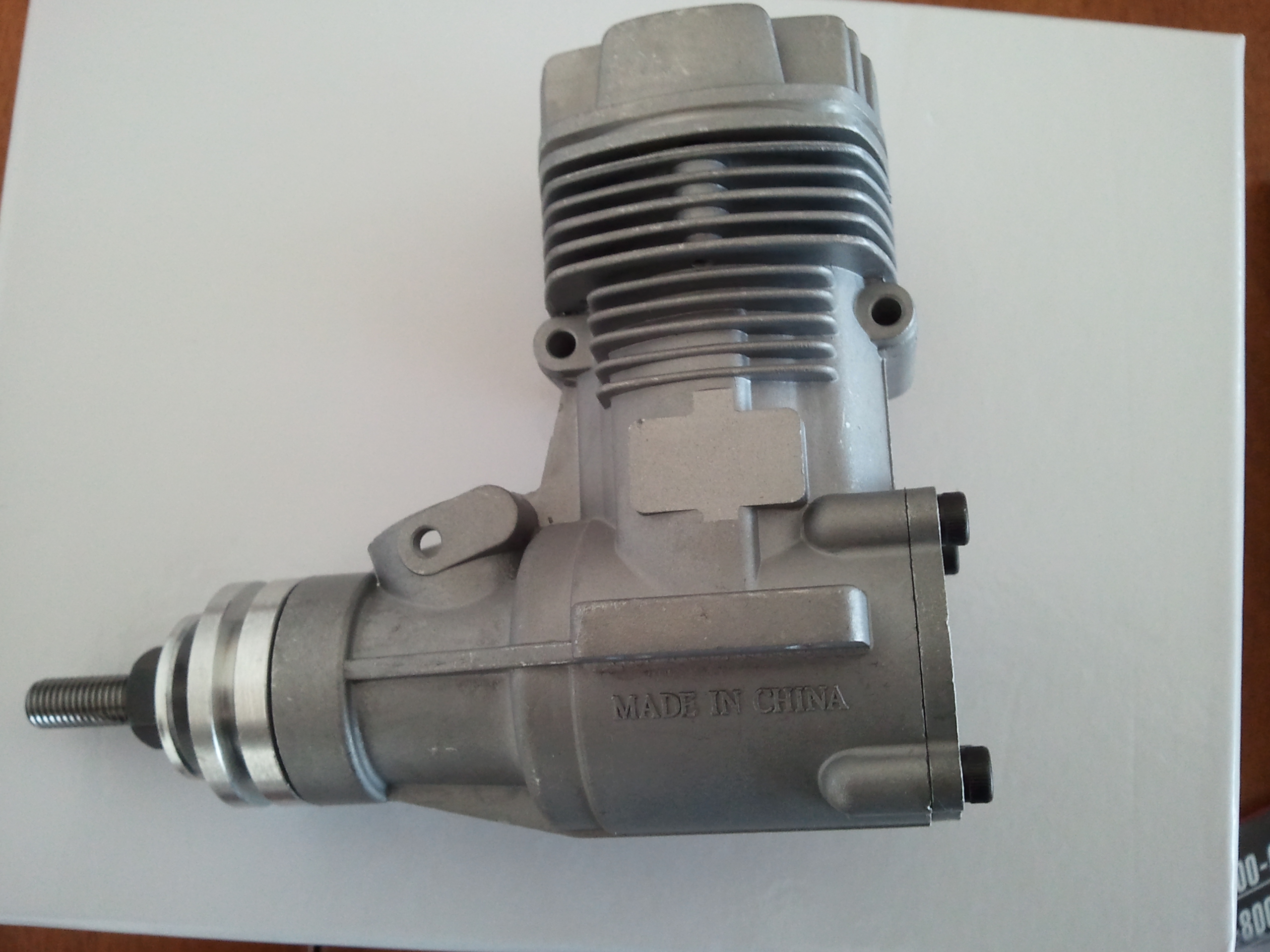

Some pix of my ASP .52 which I posted in other post that somehow does not have the name ASP engraved on it. A video to of breaking in, which is not complete yet, I'd be breaking it in on weekend, but on rpm my bench would easily be 70 to 90lbs and that engine was moving it and it started scooting so I had to put my foot on it.
Why the engine does not have ASP name engraved on it I don't know, if somebody knows why is it so please lemme know.
Here is a short video of breaking in process -> http://www.youtube.com/watch?v=kj1HEb2A04Q
