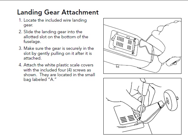

The only problem encountered and I'm having is the front wheels are connected and are supposed to go into a slot so I get it into the slot but it isn't going far enough down and I'm afraid I'm going to break or crack the foam somewhere. Has anyone else experienced this with this model of RC airplane(s)?

Who makes this model? Maybe we can look over the manual, if there is one, and give you some useful help.
Is that the Hobbyzone SuperCub LP?
Is this the page for the landing gear?
If so, it looks like you grab the gear and squeeze it and push it in the slot, then secure it with the screws provided.

That's the one!!!! What you said makes perfectly good sense. Thank you!!!!

You were right, all I had to do was squeeze the wheels together some and presto worked like a charm!!!! Thank you!!!
