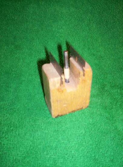

Since you bought that hand held balancer, here's a tip for you. Held in your fingers, there is usually too much friction to see the smaller imbalances. If you will make a long "V" with cardboard or wood for it to sit into it will work a lot better.

Here is a simple way to make your shaft and cones work better. Two single edge razor blades slotted into a block of balsa and set level.

I sand off the flash, never have noticed any drag and I don't slice my hands if I need to flip the prop with my bare fingers or get a prop out of my flight box. Take an old CD, DVD and cut in in half. Glue the two halves into a piece of flat balsa wide enough so the finger balancer fits between the hole halves, Shazam, a balancer. I use clear lacquer paint to balance my props. Just spray it on the light side until it is in balance.
