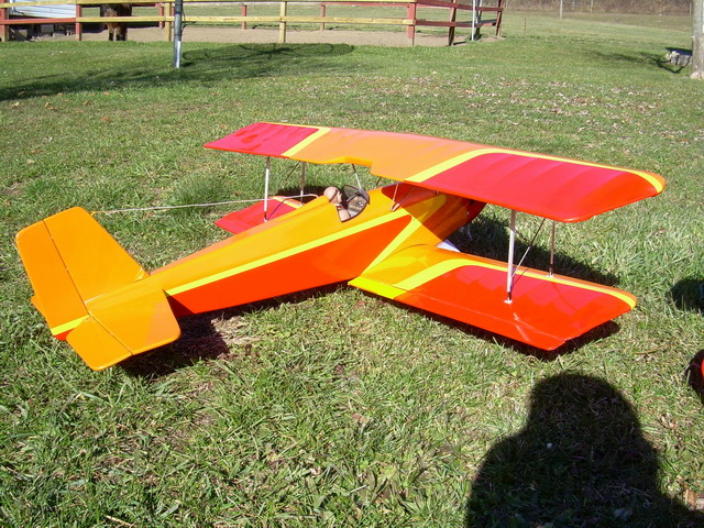

Old 02-08-2014, 06:37 AM
buzzard bait
Join Date: Jan 2003
Location: Ithaca, NY
Posts: 3,286
Received 5 Likes on 5 Posts
deanz406 has a nice gallery...have a look! Great collection of bipes, very nicely built and I like the colors. That red and silver Aeromaster is my favorite.
Whiptail, there aren't many bipes out there these days. Yet I went ahead with a biplane event in September and about a hundred people showed up, 18 registered pilots and 38 biplanes! They do have a special appeal.
If it must be an ARF, then Maxwell has some. But I really suggest you try building! The Phaeton II suggestion really seems the best for a first bipe with a 46 size engine. Just go for it.
Another route is swap meets. I picked up my Big John for $150 with engine. Then I fixed it up and repainted. Lots of fun...before and after...

Old 02-12-2014, 04:47 AM
charlie1960
Join Date: Dec 2007
Location: Palestine, TX
Posts: 518
I would vote for the "Bolt" too. was an excellent plane. easy take off easy landings.
Looked very nice in the air and always drew comments. Reasonable on the pocket too.

Old 02-13-2014, 07:13 AM
buzzard bait
Join Date: Jan 2003
Posts: 3,286
Thanks Gizmo, it was really fun to fix up and fun to fly. Note the "was". Wouldn't it look great doing a low slow roll in the evening light? I thought so too.
Next up will be a Flair Puppeteer from a kit I just picked up.
Jim
