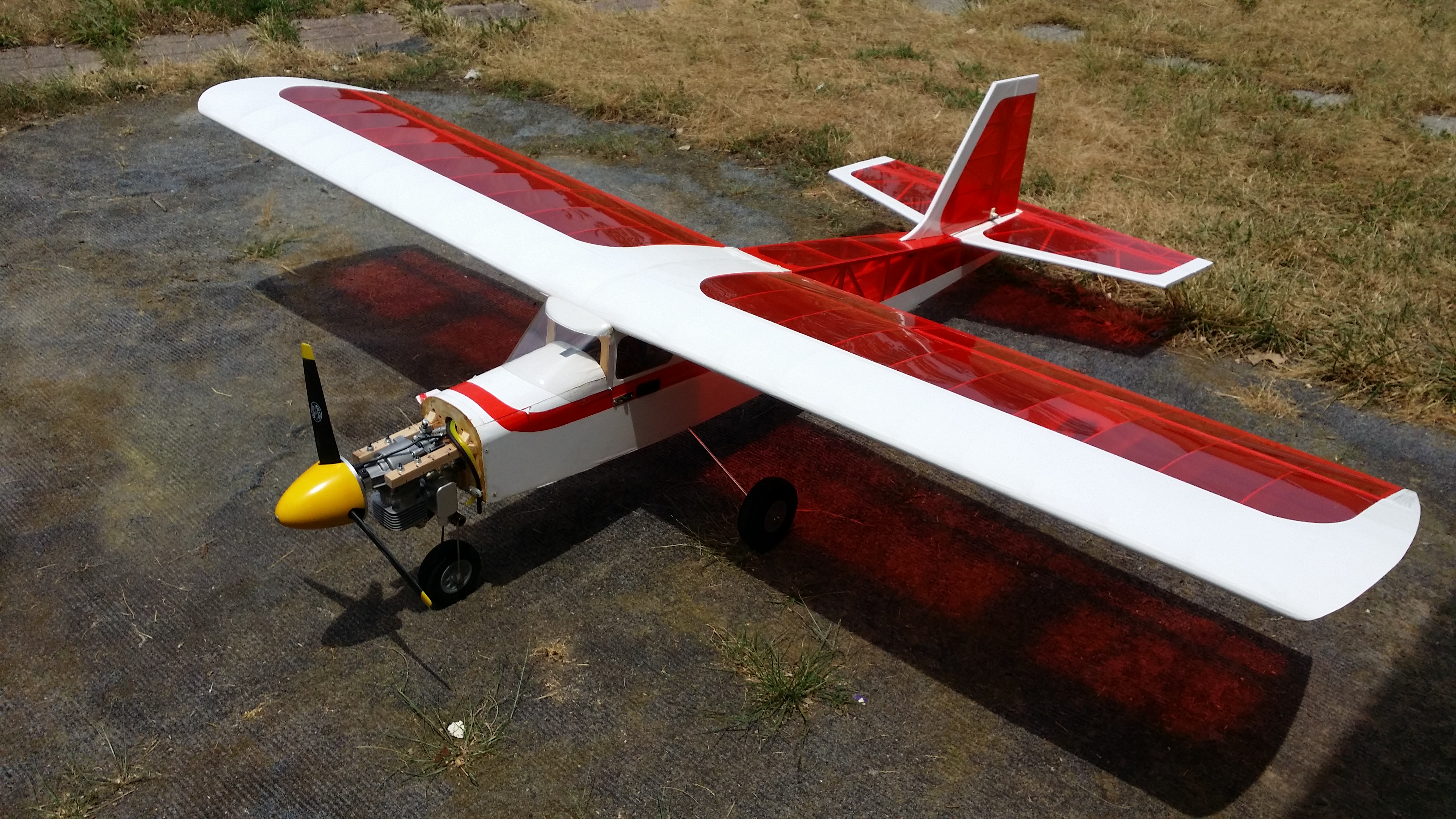

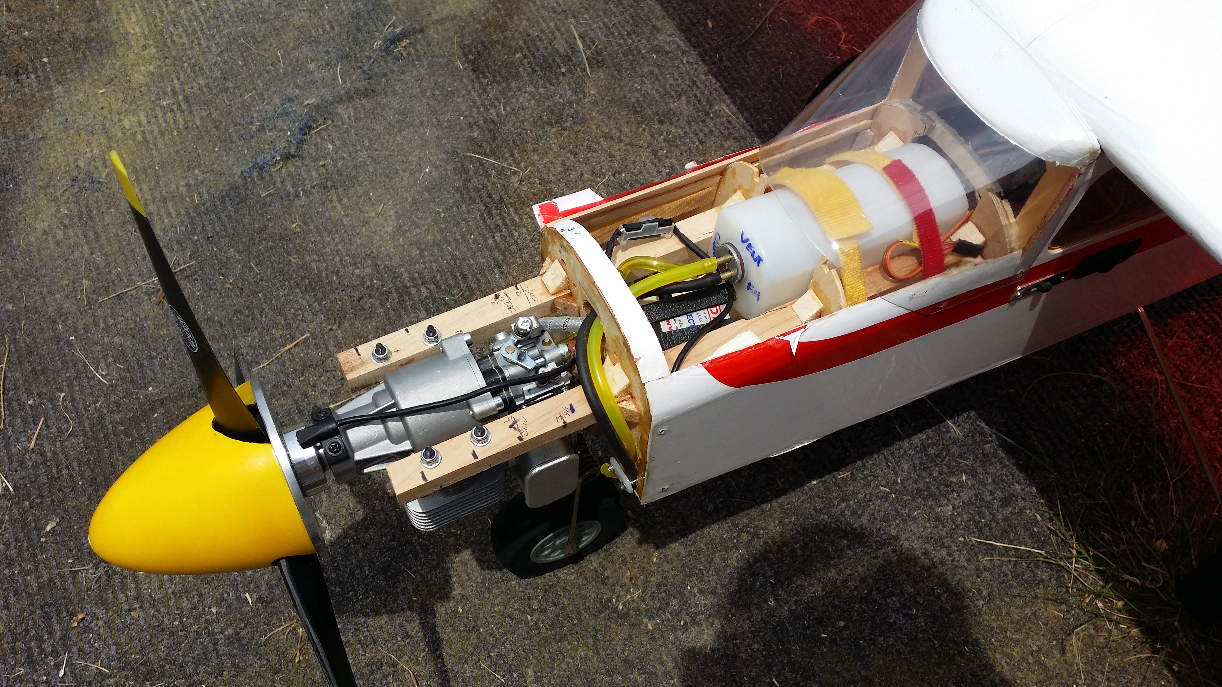

I put a DLE 20 RA on mine to test 3 blade props for my 94 inch span P38. A master airscrew 15 7 turns 8000
A 16 8 turns 6300. Both seem to perform about the same. The maple mounting rails go all the way back to the cabin bulkhead. 1/8th lite ply bulkheads with balsa triangle reinforced. Originally it had a .46 glow then .61. Had a pound of weight to balance. Balance now perfect with 20 RA and no nose weight. Receiver and ignition battery under rudder elevator servos. Weighs 9lbs. Replace the nose strut with a Fults dual strut. 4 1/2 inch main tires. 3 inch nose wheel
Make sure the wing bolt block ine fuselage is glued good. Mine was loose.
A 16 7 or 8 2 blade will work on the,20. A smaller gas engine would work fine too

Old 07-11-2016, 09:35 PM
egldriver
Join Date: Sep 2006
Location: Us
Posts: 317
Received 14 Likes on 13 Posts
Here it is buttoned up. Didn't bother with the cowl. It could be done though. A 15 with mount s to the firewall would be easier. Reinforce the firewall with triangle

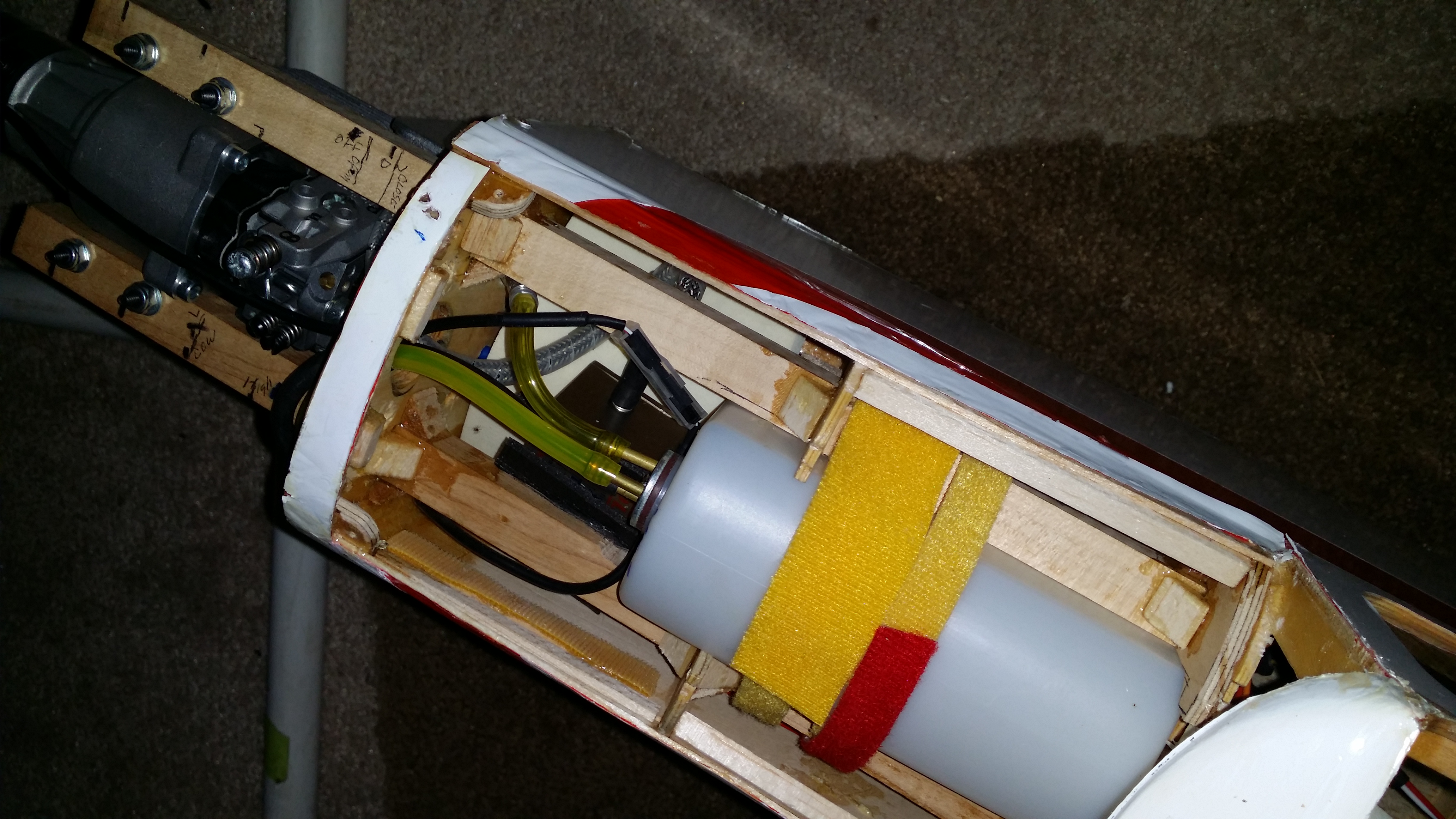

Egldriver, how do you reinforce the fire wall with triangle? Thanks
Old 07-12-2016, 08:03 AM
egldriver
Join Date: Sep 2006
Location: Us
Posts: 317
Notice in the,first picture the small pieces of triangle balsa glued to the beams and firewall. Cut pieces of triangle balsa the full height and width of the firewall. Glue these with epoxy to the inside corners of the firewall and fuselage sides to make the firewall strong enough to support the gas engine and stronger nose wheel strut.
I just cut a hatch open like u see. The windshield is secured with screws to allow the hatch to be removed. Two screws at the front of the hatch hold it.
The ignition module is in front of the tank on foam rubber
This photo shows the hatch support rails on each side. The small plywood blocks in the front corners for the hatch screws. Note that I used long maple rails to mount the engine. If you use mounts similar to the stock ones,that is where you would reinforce the firewall from the inside corners described in previous post.

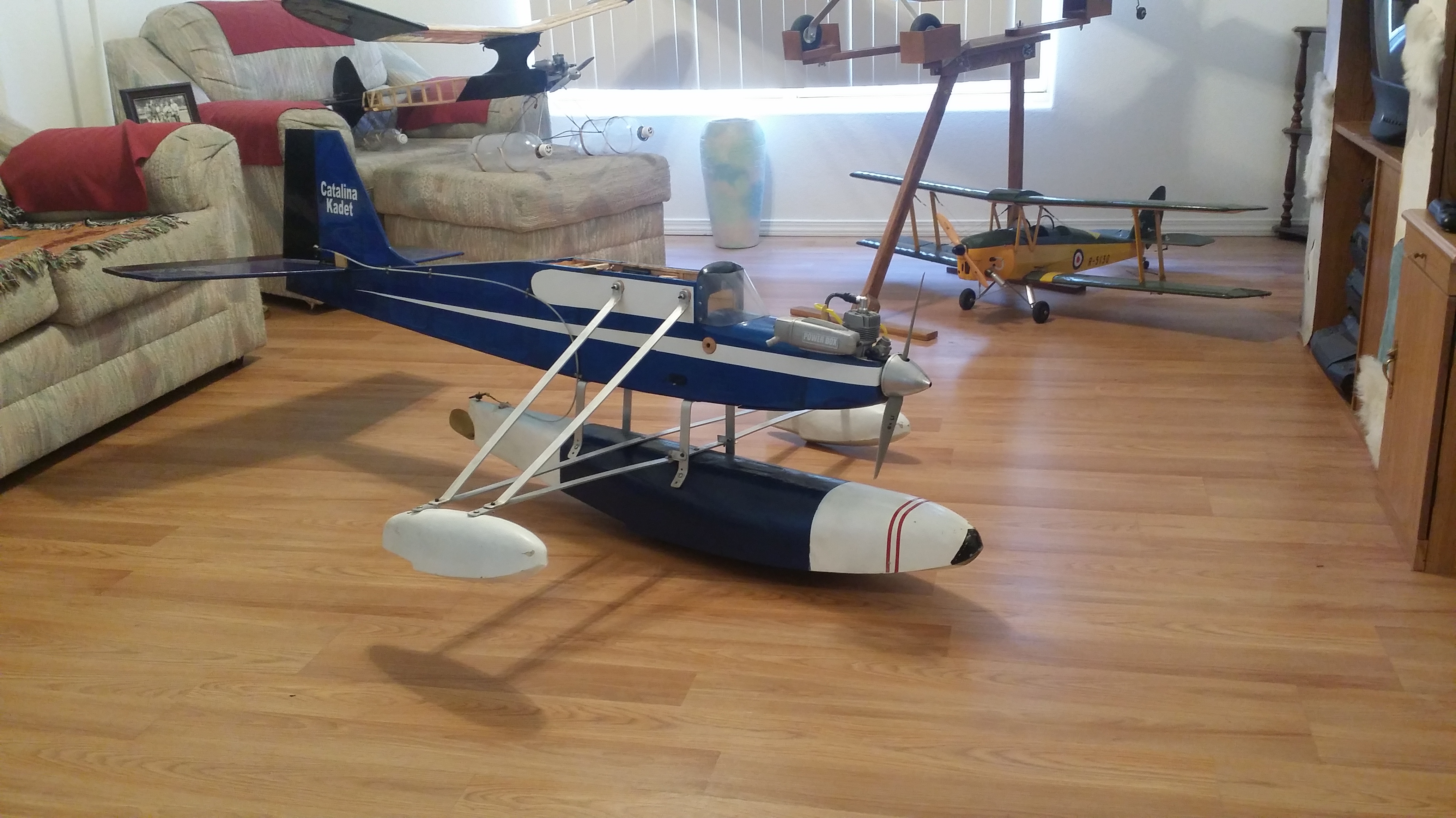

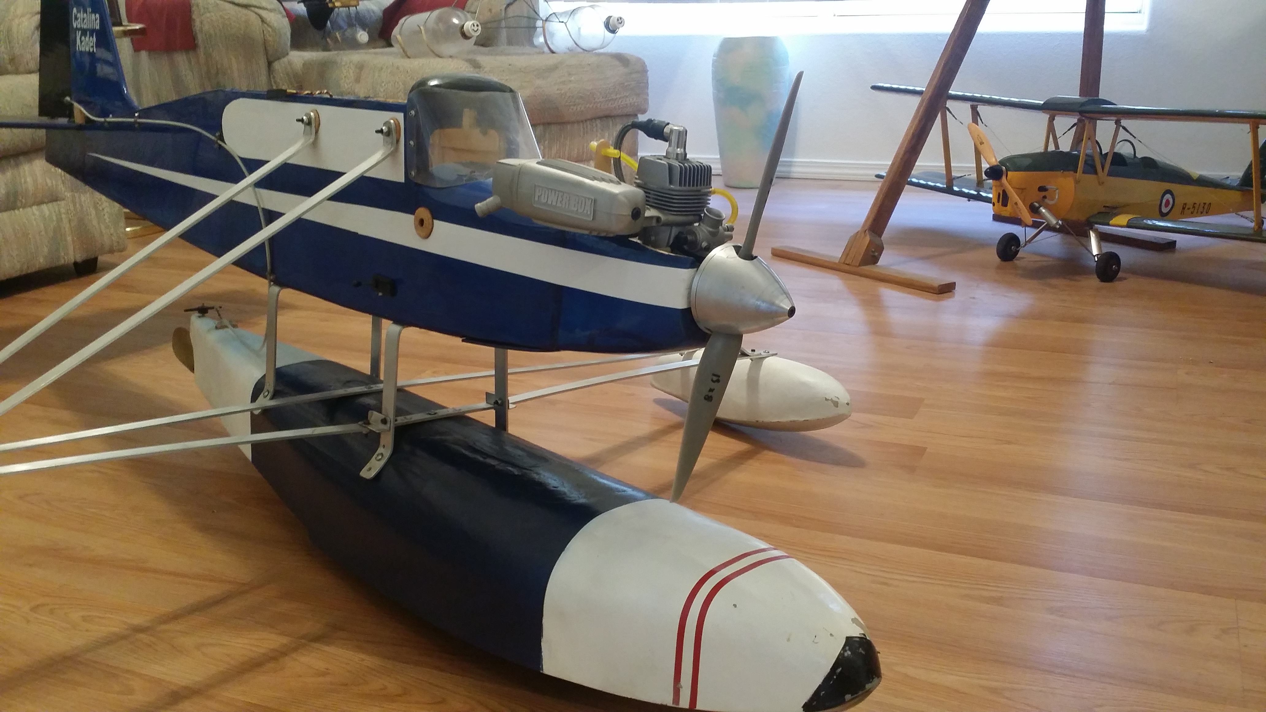

Join Date: Dec 2001
Location: Kingman, AZ
Posts: 10,441
Received 10 Likes on 10 Posts
Originally Posted by MARK JR
Hello, I have a sig kadet senior with no engine. I'd like to know if I can put a 15 cc gas engine on it.
Yes off course you can and as I noted on your other thread of the same subject It is an ideal combination for the cadet senior wheels or floats.
In my case I built it from a cadet senior kit and use the OS 15cc spark ignition version a superbly reliable engine to date.
John

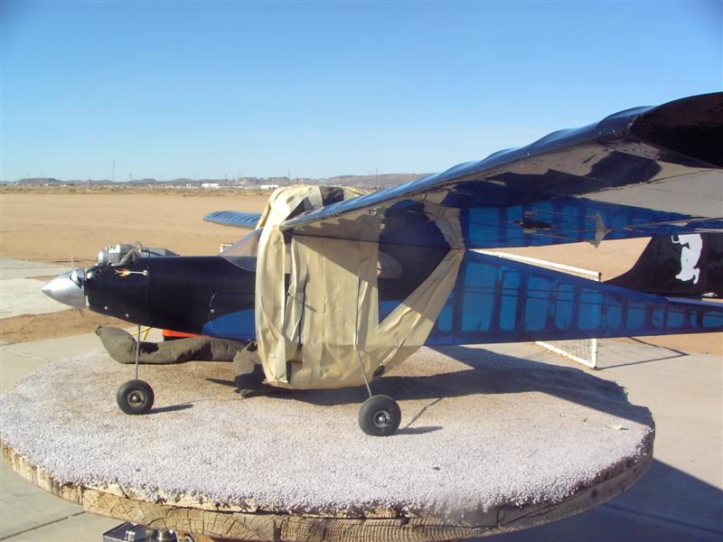

Larry I have had considerable experience with the clone 'Super Seniors' which occurred when Sig had their problems with CMP and for some time Sig could had nothing to sell but CMP sold considerable numbers of the Super Seniors with a much cheaper hardware package including useless pushrods and etc.
It was during this gap for perhaps a year and a half that I was running a popular series of pylon races (I think there were six over three years) Just for Senior Cadets any version kit, Sig ARF or the clones Super Senior and the world models Super Frontier version.
The Super Seniors were drastically cheapened and started to come in heavier and heavier with the heaviest I ever weighed was 11.5 pounds. I actually had the opportunity one time to weight the tail feathers (fin, rudder, horizontal stab and elevator with no hardware) but covered just as you would remove them from the box, of both the replacement Sig arf when they got going agine and the feathers of a Super Senior. I do not remember the numbers but do remember the Super's weighed in over twice as much as those from the Sig!
Now rest easy Larry I think you will be happy with your Super even with the extra weight they all flew fine and the sixty one is a good choice. There were a large number of them at one time in our club and none could be called anything other than a cadet even with the extra weight.
Heck I think I have powered senior cadets with just about everything from an OS 35AX all the way to 13 pound thrust Kingtek turbine and loved them all.

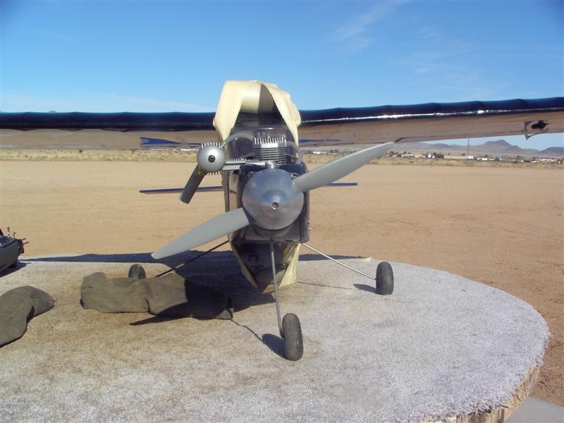

Now this is an overweight Cadet Larry
Engine OS 55AX, payload eight pounds of deadweight sandbags at the center section. While it was no aerobat the airplane flew controllably in a reasonable fashion, a successful experiment.

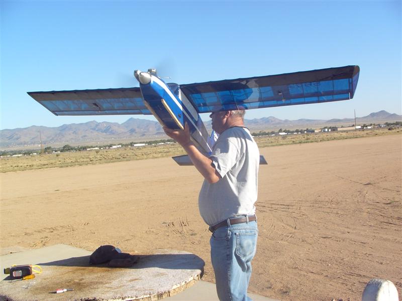

Old 07-19-2016, 10:47 AM
JohnBuckner
JohnBuckner's Avatar
Join Date: Dec 2001
Posts: 10,441

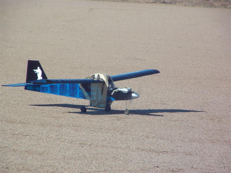

Mark that required about 400 feet with a light winds down the centerline, runway length is 900 feet.
Here is another variation that required no runway for take off, No landing gears at all just some balsa strips taped to the bottom for landing:
John

John, do you launch that plane?
