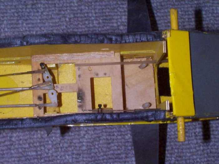

Ghostbear here is a picture of the main, you can see where the original wire gear was mounted. I added a 1/4' plywood doubler in side the fuselage and tapped it 1/4-20 to accept the nylon bolts. you can see the doubler in another picture.

One last one the business end. I added 1/8" plywood doubler in side the tail and installed 4-40 t-nuts to attach the leaf spring.

Very Cool
I'm saving your pictures. They are very good.
Question, it appears that one of the arms on the rudder servo actives both the rudder and one of the pulls. Is that correct?

The servo arm that operates the rudder also operates the pull-pull on the tail wheel. The servo arm has four holes in each side, the rudder is in the third hole from center and the pull pull for the tail wheel is in the fourth hole on each side of the servo arm.
