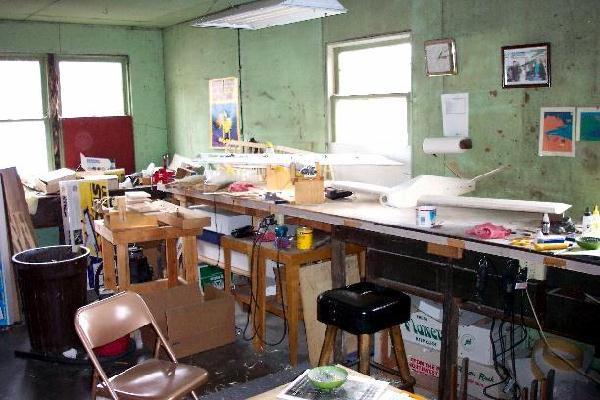

RE: Kit Building..
Jumping right in here, head first, I use a solid core door.
You may be able to get one cheaply (or free) from your local building supply store.
Mine is a 24" wide by 80" long and weighs about a ton!
Get a flat one, with no decorative cut-outs.
They too make mistakes and sometimes cut the hinge pockets and door knob hole on the same edge!
Put this on a pair of saw horses and you have a flat and sturdy building surface. I turn mine over about once a year just in case.
Common cieling tile, 2' by 4', makes a great work surface that holds pins well.
I secure them to the board with sheet rock screws and turn them over for a second work surface.
Look for a package of damaged tiles and ask for a price break. I got 12 panels for $3.00 once (lifetime supply, or close to it!)
We modelers are really cheapskates, aren't we.

To make my building board I got a sheet of 4 X 2 MDF. Can't remember the thickness (I'm at work so can't measure) but it must have been close to 3/4".
This takes care of flat, to be able to get pins into it I also bought a sheet of soft board (not sure what other use it has) the same size and glued it to the MDF.
By the time I was done the cost was mounting up, however I expect to be using it for some time. My theory is that if you build a flat wing anything will fly, so far it seems to be holding up!

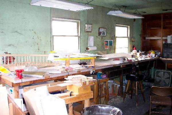

RE: Kit Building..
Like Dick said, a door makes a good table.I use a hollow-core door that someone licked a hole in one side of... Got it for 3 buck at the local home improvement store.
Rather than go the saw horse route, I built a simple 1x6 frame with 2x4's for legs
