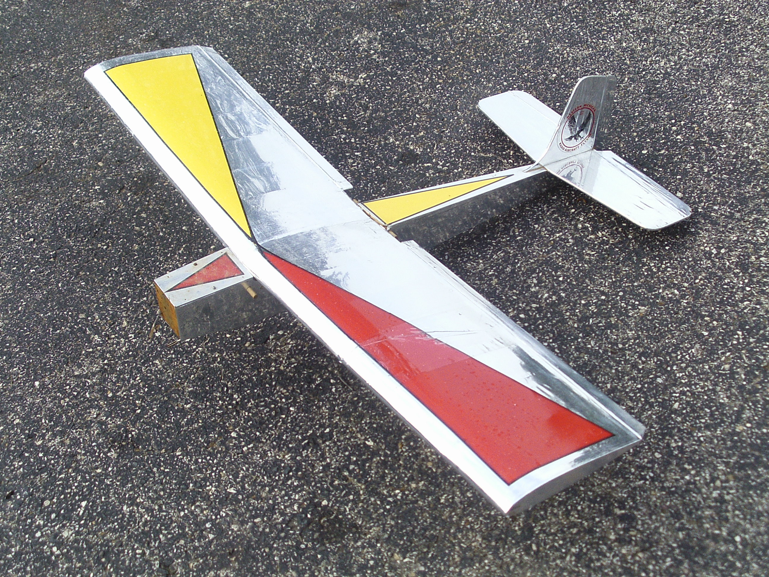

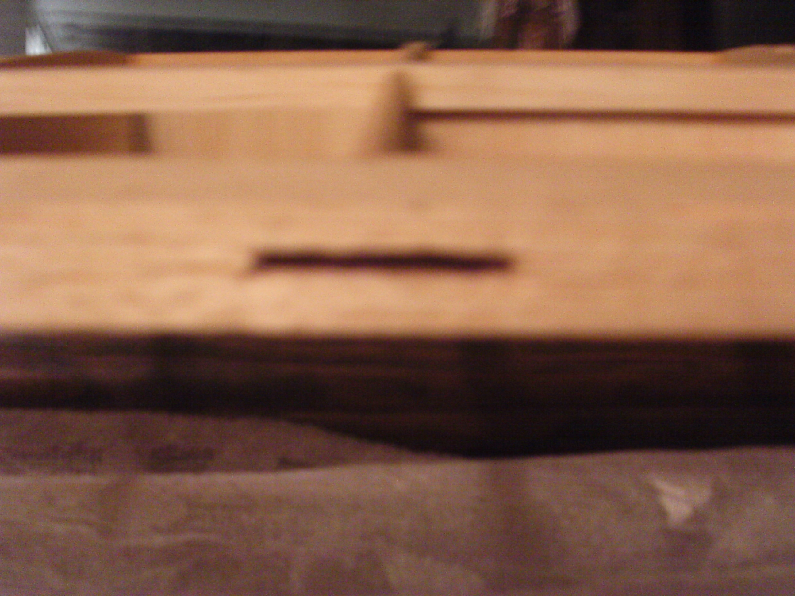

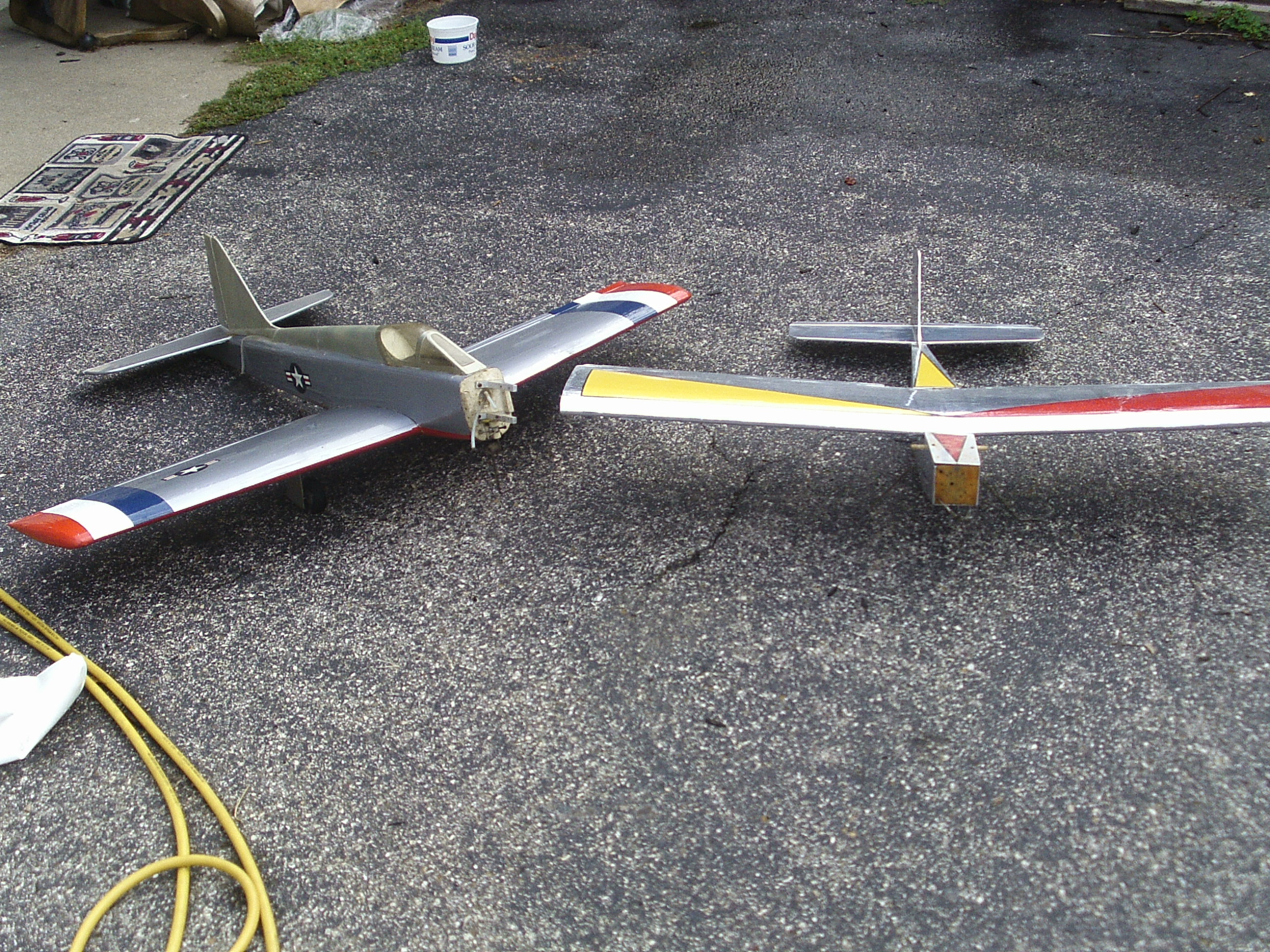

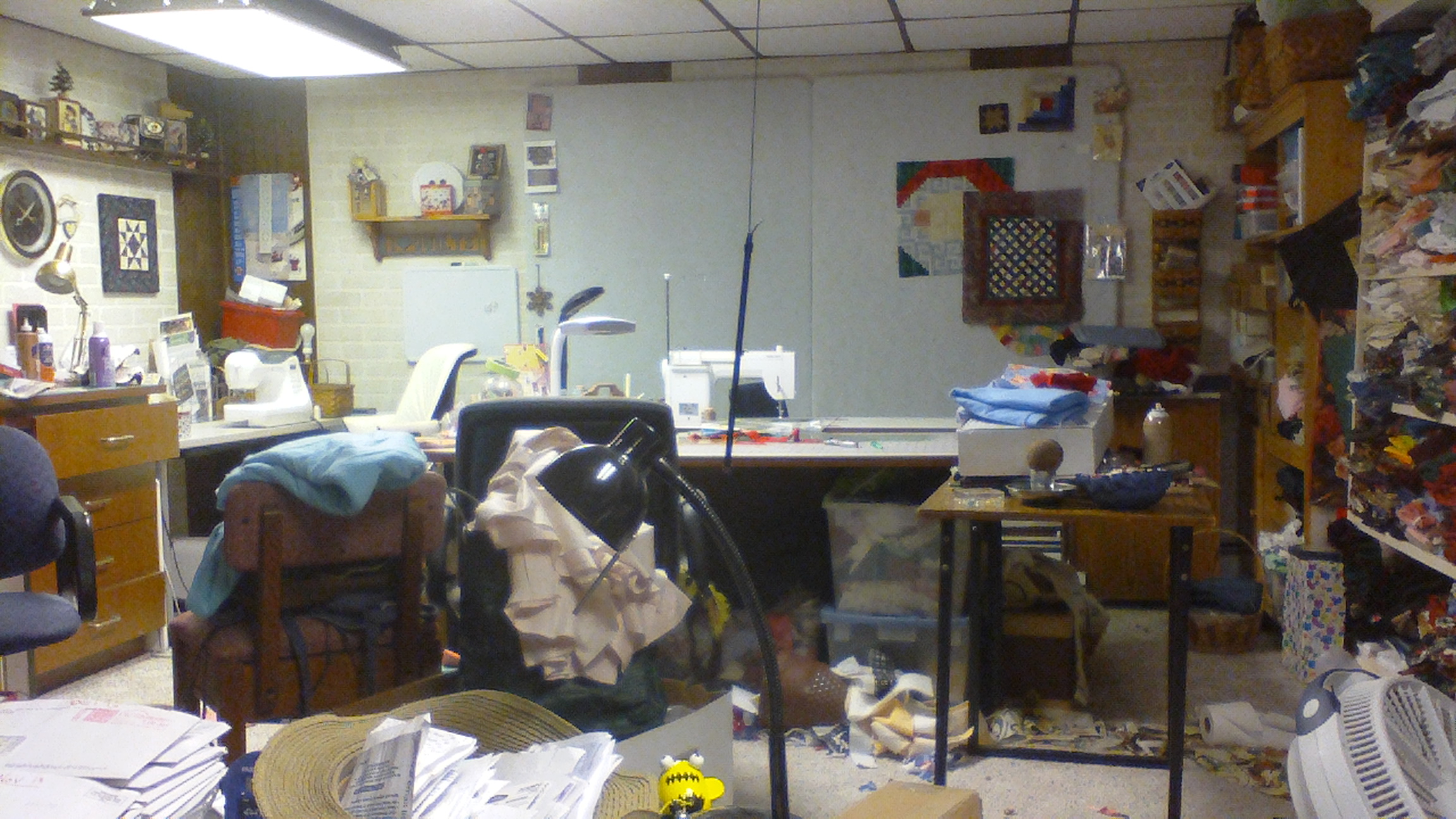

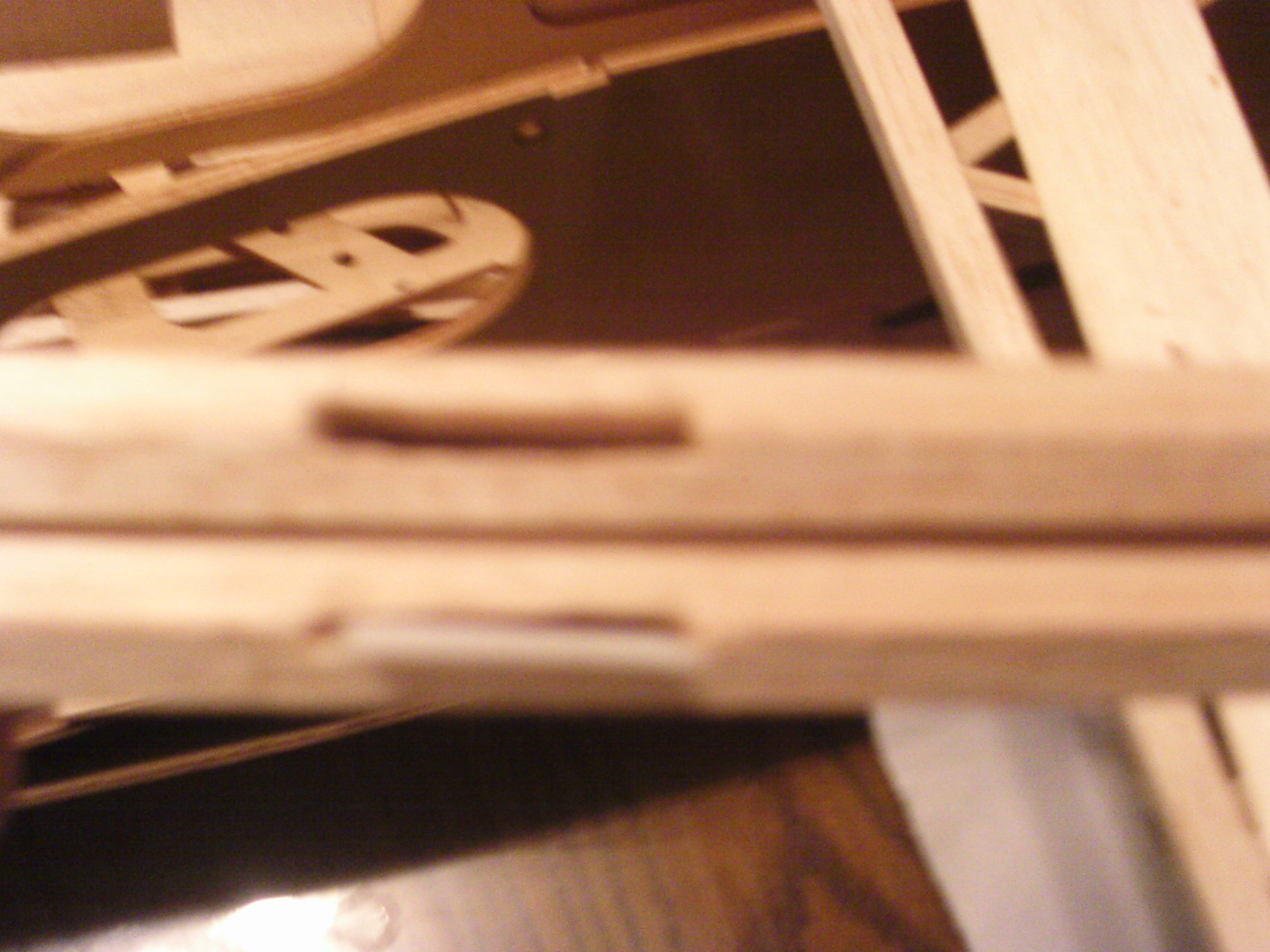

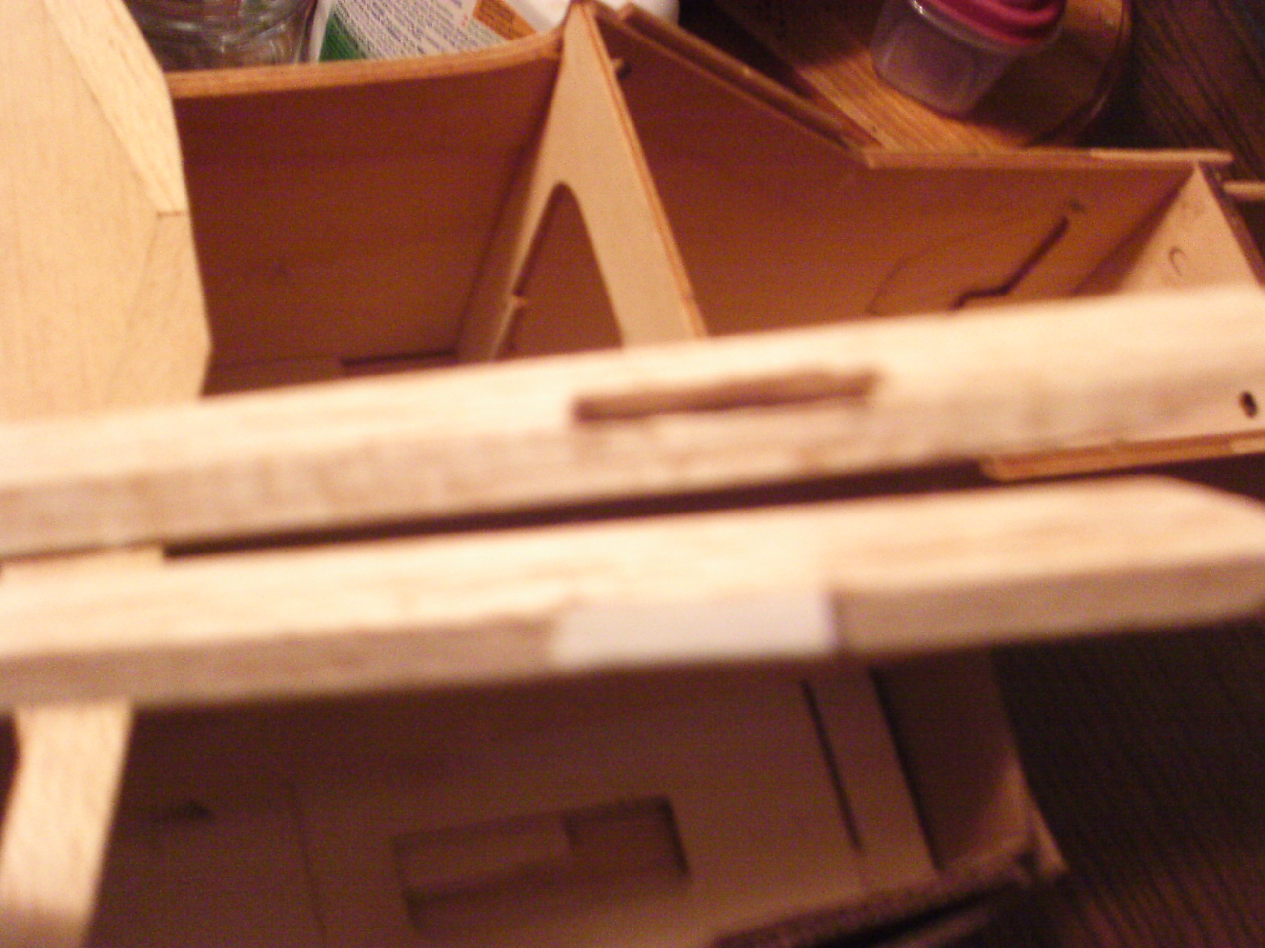

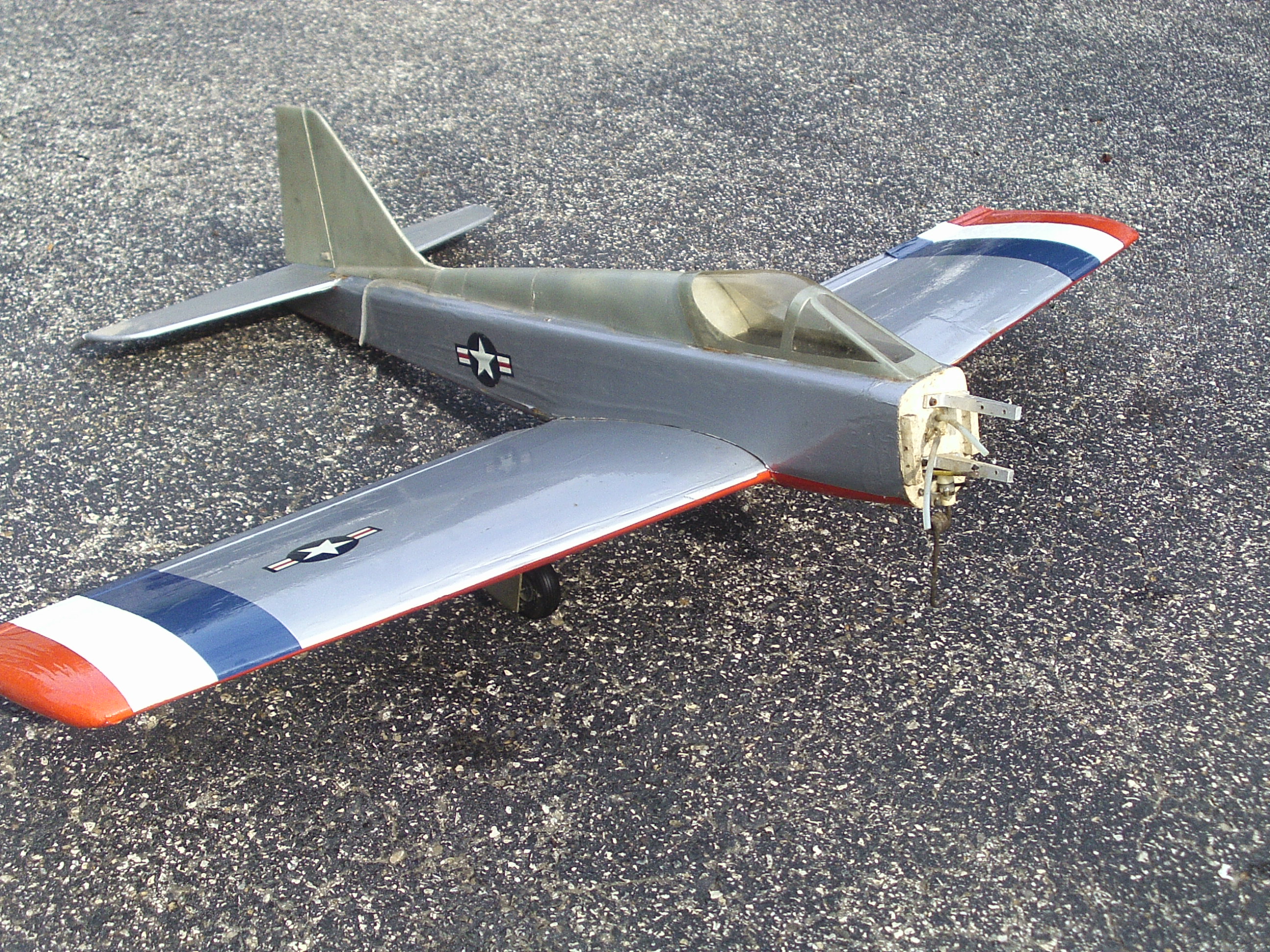

RCKen - First off I want to Thank-You for all the time and information you have invested in this build thread. You have contributed a very considerable amount of your valuable wisdom and knowledge in building this Airplane. So much so that you've given me the confidence to build one myself! Well. almost by myself.
I bought three planes at an auction. Two of them are ABF's ( Already Been Flown ) and one is a Semi completed LT-40 Kit. The Kit looks like someone started with good intentions, tried to follow the instructions, got confused and gave up. I checked the parts inventory and all the pieces are there, so I just need to fix a few problem areas and should be airborne by next spring!
The most obvious problem is the former builder hacked the slots for the hinges. I don't know how thin of a slot the power hinge slottter tool makes, but what this guy did was carve out a cavern in the TE and ailerons. I would appreciate your advice on how to fix these oversized holes, as I don't think Thick CA would be appropriate to fill the gap and get a good hinge joint. I've included some pictures for you viewing pleasure. Again, Thank you for making his build thread
1 - Pic of the two ABF planes
2 - Could this be a Sig Kougar ?
3 - Top Wing Trainer
4 - Close up of the Wide Gaps for Hinge slots
5-Close up of the Ailerons 6- Future site of my Building Table and OOdle's of tools...

Hi Renegade,
If I could toss my $.02 in here, I had a similar situation with an LT-25 I'm currently completing. Someone with good intentions and bad skills got to it first but I've just about fixed all the issues.
FYI, when I use my Slot Cutter, even with the thicker blades, sometimes the slot is still a very snug fit on a CA hinge. I think that these 'caverns' (well said) are going to be a problem. I don't think that thick CA is the answer and the loss of all that wood will create a weak spot in the spar. One of those is going to get you someday when it buckles in flight.
IMHO, and for what it's worth, I would cut some filler pieces (called a Dutchman) for each of those slots and insert them. Carve them for a snug fit but DON'T glue them in yet (more in a second). Between the slots, you could cut fresh holes for Robart pin hinges. Once these holes are properly located, you could then glue in your filler pieces in with THIN CA. The Thin CA will wick in nicely and strengthen that weak spot.
If you should glue the Dutchmen in before you drill holes for those Robart pin hinges, the thin CA could migrate through the surrounding wood and make it as hard as a rock, and difficult to drill for those Robart hinges.
As I said earlier, just my $.02
