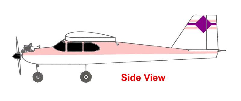

I went with the K.I.S.S. principle. This is a trainer and it will get dinged up. I envisioned somebody having to fix the plane. With simple shapes and all straight lines, the little girls could help with this (at least the 7 year old).
Decals could be made and applied as seen fit. I'm not that handy with Paintshop, so I'll leave that up to the experts.
Kerry
EDIT: A pattern could be made for the 'diamonds' to make sure they're all the same size. This 'tool' could be given with the plane.
Kerry

Kerry, Your thinking ahead approach is pretty wise. While being a " simple design" as you put it, it is still is an attractive one too. I gotta learn how to play with photoshop, it looks like fun. Maybe Minn gives lessons, lol. Well done![sm=thumbup.gif]

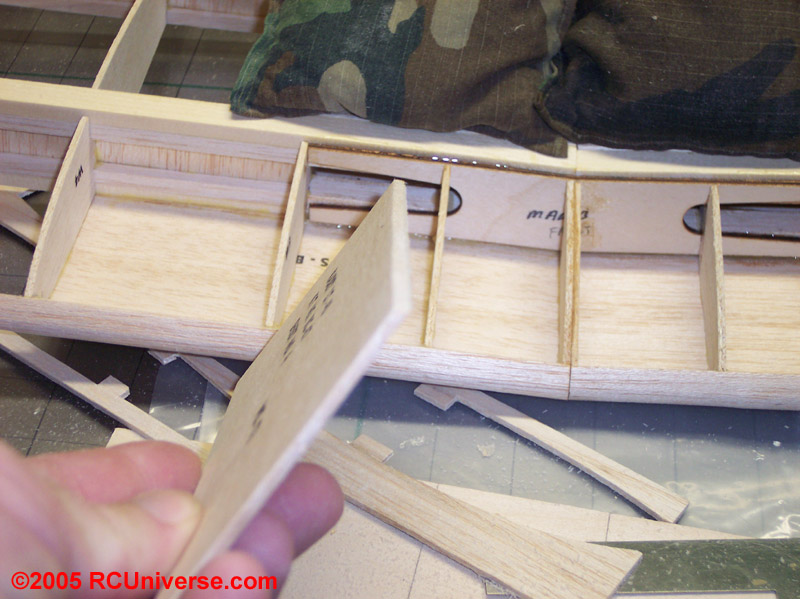

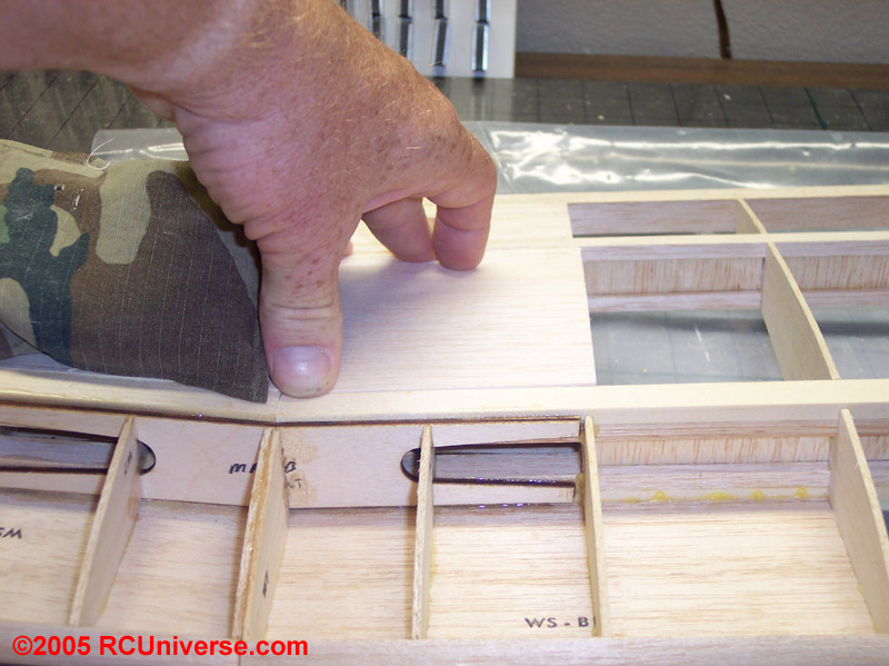

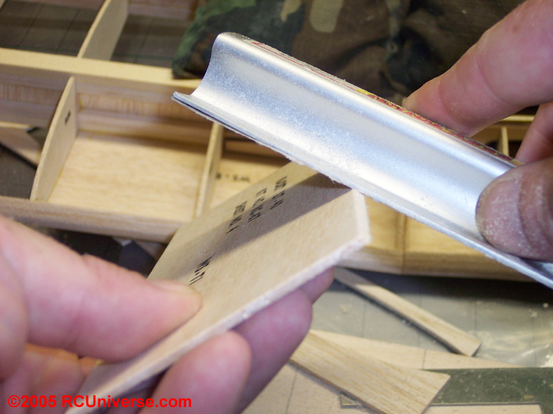

I guess that I owe some people an apology, it's been a few days since I posted here. I do apologize to those following this thread. This past week was pretty hectic for me at work, and until I can figure out how to put my son through Veterinary School by building RC airplanes I got to take care of work first . Although I was busy at work, I did have a little time to work on the plane here an there. The biggest thing that I didn't have time for was to keep up the posts here. So let's fix that now. As it stands right now, I've completed the wing. Well, at least to the point where it needs to be sanded but I won't do that tell later on in the build. I usually try to do all the sanding at one time, unless I need to sand something off while building to get ready for something else.
Alright, back to the build. With the 2 wing halves joined the next step in the instructions is finish out the sheeting by applying the sheeting to the top part of the wing. Before you do that, this is your last chance to double check all the joints in the wing. Take a little bit of time to inspect everything to make sure you have a good joint. If you see any joints that a bit iffy or don't look quite right to you, use your glue to run a small fillet of glue along that joint. This will ensure that the joint is nice and strong. Better safe than sorry if you ask me.
Once I'm satisfied with all the joints I glued into place the WS-T2 pieces. I know that I'm starting to sound like a broken record here, but it's worth saying again-- “Measure twice, cut once.” This advice never gets old. Double check that the sheeting fits BEFORE you put the glue on. If the fit is a little bit off, use a sanding block to trim it to size. Once your happy with the fit go ahead and glue it into place (Pictures #1, #2, and #3). Just like the bottom sheeting I wasn't at all happy with the way that WS-T1 fit (picture #4), I just can't bring myself to lay huge bead of glue in there to fill a gap. Nope, nope, nope. I'm not going to do it. So, like the bottom sheeting I beveled the edge of the sheeting so that it fit properly against the leading edge. And also like the bottom sheeting, there is now a gap at the back of the sheet. This is easily taken care of by cutting a strip of balsa from the scrap wood and gluing it to our sheeting. (pictures #5 - #9). Once the sheeting is in place I used pins and weight bags to keep it all secure while the glue dried. Picture #11 shows the sheeting all in place and ready to move on.

1. The first WS-T2 sheet in place.
2. Test fitting the WS-T2.
3. Gluing the WS-T2 in place.
4. Test fit of the WS-T1 against the leading edge.
5. Beveling the edge of the sheeting in order to get a better fit with the leading edge
6. Finished sanding the bevel.
7. Test fitting the sheeting in place, measure the gap in order to cut scrap wood to fit.
8. Cutting a piece of scrap wood to add to our sheeting.
9.Gluing an addition strip of wood to our sheeting.
10. Glue set to dry
11. Sheeting finished

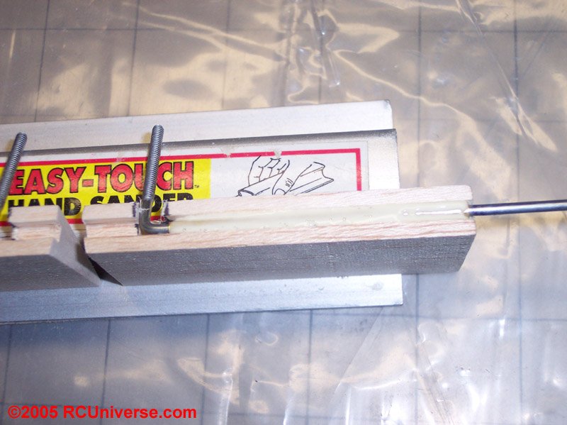

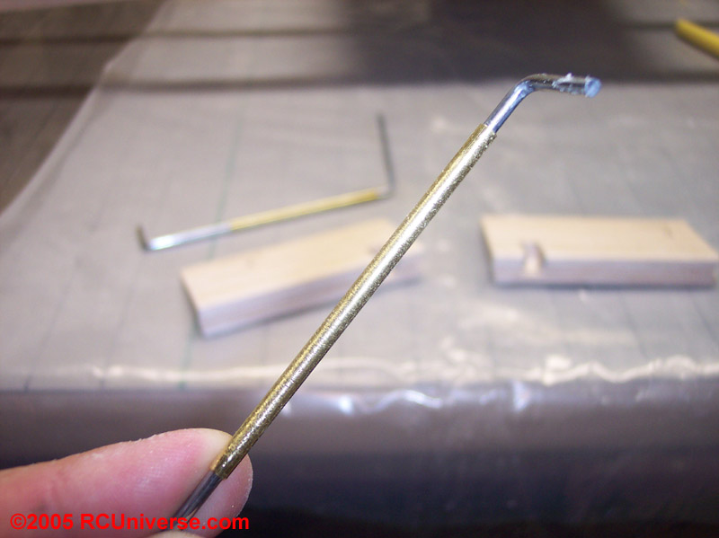

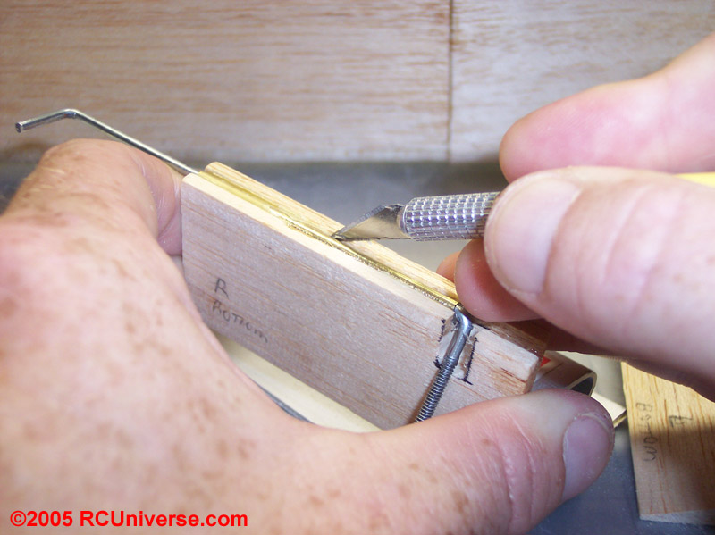

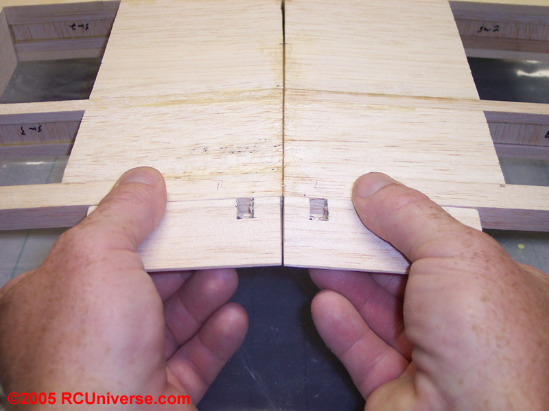

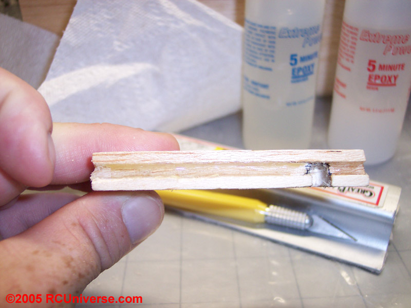

I know what you all are thinking. I promised you a screw up, and I haven't delivered it yet. Don't worry, I always live up to my word. If I promised you a screw up I'll definitely deliver a screw up. In fact, it was in this next step where I screwed up. Before we get into the step (and the screw up) I'll let you know what caused the screw up. That's easy, trying to hurry a step while I was tired. This is one of my cardinal rules, don't build when I'm tired. I know better but I let myself get into a bit of a panic because I wasn't getting anything done on this build, so I sat down to work when I was tired. And I was quickly rewarded with a mistake. Luckily it was an easy mistake to recover from, but not all of them are. I've had mistakes that the only way to fix them was to buy new wood and cut out new parts. So here is my advice, don't force yourself at the building table. If you're tired, or you just don't feel like sitting there to build, trust your instincts and get away from the building table. Go spend time with your family, read a book, watch tv, surf RCU (my personal favorite), just do anything but build. Trust me on this one, personal experience speaking here.

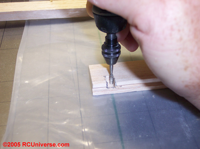

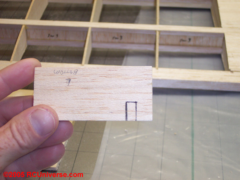

The next step is preparing and installing the Center Section Trailing Edge Pieces. These extend back from the trailing edge and contain the torque rods that move the ailerons. The pieces themselves come with the groove for the torque rods already cut into the pieces, but you will need to cut a notch into each one for the torque rod to exit and also give it room to move back and forth. First take the 2 pieces and label “left bottom” and “right bottom” (picture #1). A lot of you might think that you don't need to mark the pieces Left and Right because you can keep them straight, and it seems a bit silly for someone as smart as you to label the parts. Trust me, mistakes happen. It's easier in the long run to just mark them now. If you look at picture #6 you will see that I also lightly marked the trailing edge with left and right. Why did I do that? Because when you are working on the wing in this step you will be working with the wing upside down and it's very easy to get mixed up and get your left and right backwards. Hopefully a few of the other experienced builders watching this thread will speak up and point out that they too mark thinks like this as they build (Bruce? Paul? You guys watching?). Use the dimensions that are provided in the instructions to mark the notches for the torque rods (pictures #2 & #3). The instructions call for using a razor knife to carve out the notch. Although it's possible to it that way, I much prefer to use a dremel (trust me, this is a must have tool for any builder) and a routing bit to carve out the notch (picture #4). If you don't have a Dremel you can still use the razor saw, hobby knife, or razor blade to cut the notches. Whatever you use to cut the notches just take your time and do a little bit at a time. Getting into a hurry is probably the biggest cause of mistakes when building a plane. Picture #5 shows the finished notch. Picture #6 shows test fitting the parts to the wing, I'm not gluing anything in place at this time but just testing.

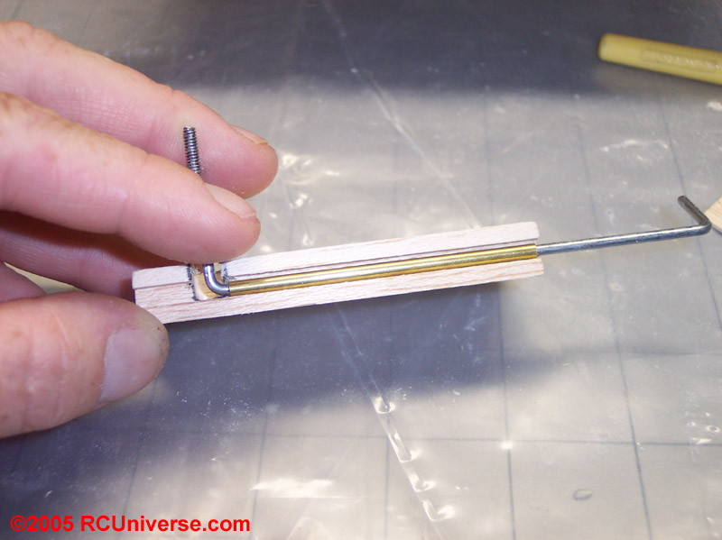

The next step is to prepare the torque rods for installation. Identify the correct sides to install these on. Picture #9 shows a test fit of the torque rod. Notice the brass rod on the outside of the torque rod, this is used so you can secure the torque in place and it can still rotate inside the brass rod. To prep the torque rod for installation use a piece of sand paper to “rough up” the outside of the brass rod. This give the glue something to “grab” to when you glue it in place. Picture #10 shows using Elmer's glue to glue these in place. What?? You can use Elmer's to glue to metal? Actually, no you really can't glue metal with Elmer's. That's they lucky part because I used the wrong glue. You guessed it, we're to my screw up. Although you can't see it in picture #10, I installed the torque rods in the wrong sides. I didn't realize that I had done this until I was at the next step, which was gluing the Center Sections to the wing. When I was gluing them in place I checked to make sure the torque rods didn't have any glue on them and that's when I discovered that I put them on the wrong side. So I quickly removed them and wiped all the glue off before it set. So I lucked out. I was also lucky that I had used the wrong glue, because it was pretty easy to get the torque rods out of the parts (picture #11). Picture #12 shows the remains of the Elmer's after I removed the torque rods, this needs to be cleaned up and removed before re-attaching the torque rods.
Ok, that's all the pictures I can post at a time, so I'll take a break here and continue the posts this afternoon.

1. Marking the parts “left” and “right” as per the instructions.
2. Marking the notch for cutting.
3. Marking the notch for cutting.
4. Using a Dremel tool and a routing bit to cut the notch.
5. The finished notch.
6. Test fitting the parts in place.
7. Preparing to install the torque rods
8. Rough up the brass rods with some sand paper so the glue has something to “grab”.
9. Test fit the torque rod.
10. Opps, using the wrong glue for the torque rods
11. Cleaning up after a mistake. Digging out the torque rods after putting them in the wrong side.
12. Need to clean up the glue after the mistake.

When I built my PT-60 I did something similar; but didn't notice it until after the epoxy was fully cured. On one side only, I ended up with the part of the rod that should point back to the aileron pointed toward the wing. I said several bad words and thought I had made a horrible error. Luckily I was wrong and the fix was really simple.
I was able to recover by cutting a groove in the other side of the TE stock and rotating the rod around. The plywood plate that glues on the top of the wing center covered up the slot on the wrong side of the TE.
