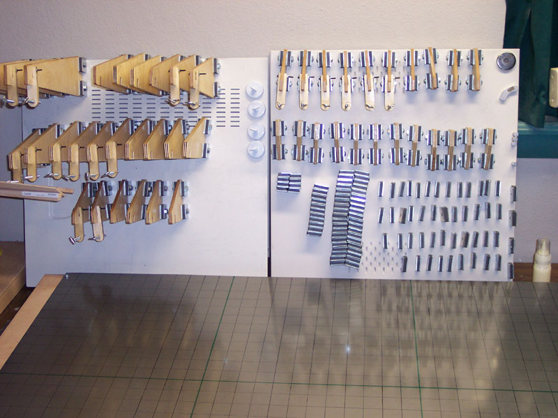

Ok, before we officially get going here I do want to point out one big difference in they way I build as opposed to others in the hobby. Most builders will have a board that they build on where they can use pins pushed into the board to hold the parts in place as they build. I used this method up until about a year ago and then I converted to using a magnetic building system. For instructions on building a magnetic system please reference, [link=http://www.airfieldmodels.com/information_source/how_to_articles_for_model_builders/tools/magnetic_building_board/index.htm]Magnetic building system at www.airfieldmodels.com[/link] . My building table consists of a 24”x72” sheet of 18 gauge steel which is placed on a hollow core door. The door is what makes the building surface completely flat while this steel is used for the magnetic building fixtures. The difference between methods I will use and those used using pins aren't enough to really make a huge difference.
The other difference you will notice in the way I build is that I don't use the CA adhesives that are popular these days. I use Elmer's Carpenter's Glue (another good brand to use is Titebond II) for building. For steps in this kit like installing the CA hinges I will use CA, but for the main build I will use Elmer's and epoxy for the build. I used to use CA when I build, but I made the decision to switch to wood glue about 2 years ago. My main reason for switching was the fumes, they can be very harsh on your eyes, nose,and lungs and I just got tired of the discomfort. When you build with CA your parts have to be positioned correctly when you apply the CA, otherwise your part is stuck where it is out of place. With wood glue you have time to get your parts positioned correctly before the glue starts setting. Also, CA will make the wood it is applied to very hard and when you start sanding it can be difficult to get a good finish. The surrounding wood will sand away quicker than the wood with CA applied to it. With wood glues, the glued joint will sand just like the wood itself.
Pictures
1. Magnetic building system fixtures
2. Magnetic building system
3. Magnetic building system
4. The very "basic" tools

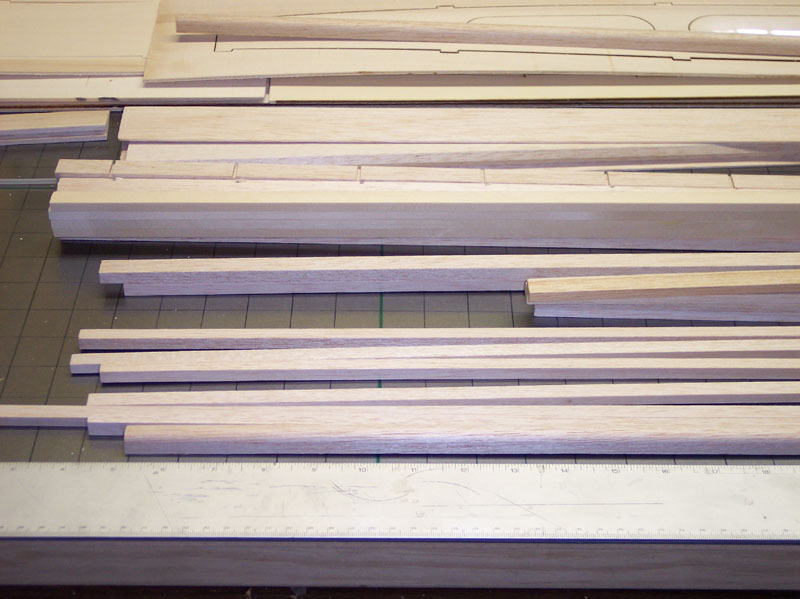

Now we get to finally dig into the box!!! Yippee!!! Make sure you have enough clear area to take everything out of the box. What we are going for here to lay out everything and inventory it all to make sure we have everything, also want to make sure that nothing is damaged. We're not going to cut out anything at this time, just label everything and inventory it. Sig does a great job on their instruction manuals in the fact that they will include a key to all the die-cut and laser cut part sheets (see first picture) which will help you identify and label everything.
Anybody who has ever built a kit has at one point or another used the wrong stick of wood. A lot of times kits will have two different sticks with the same dimensions but different lengths. The longer sticks are usually needed for crucial items (like spars) so you can't splice a piece together, so if you use the stick in the wrong place you're going to be making a trip to your LHS to get a new one (yes, I have done this too!!!). Here's what I do, measure and label ALL of your sticks (and flat wood too, if included with kit). Measure carefully because it's easy to mix up sizes that are close, for example 5/16” and 3/8”. When you have to cut a length off of one of these sticks always cut off of the opposite end where you marked your measurements, that way you'll still know what size the stick it.
When you have all the sticks labeled, start to inventory them. Check off the parts on the included parts list (page 3 of the manual). After you have the sticks inventoried then you can do the die and laser cut sheets, and then the parts in the bags. Try to keep them neat as you inventory, because we are going to sort them out and separate them according to where you are a going to use them. As you inventory the parts make sure that every part is labeled with the part number on it.
One important thing you want to do at this time is look for damaged parts. As you can see in my pictures, there is a “groove” in one of the ailerons. This can easily be fixed by filling in the groove with balsa filler, but not all damage can be fixed. If you find damaged parts, as well as missing parts, you need to contact either where you purchased the kit or call the manufacturer and arrange for replacement. I've dealt with Sig before and they are really great about taking care of problems.

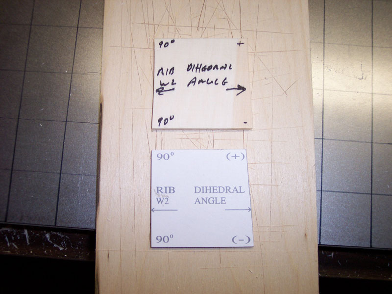

Ok, first change from the instructions. Well, not really a change. I think that Somegeek (or maybe Tigerdude) commented in his build about dihedral gauger. I just didn't like the look of it at all. On one side of the gauger is supposed to be a 90° angle to the bottom, and the other face is supposed to be used to set the dihedral angle of the wing. As you can see in my first picture that both sides of gauger have a “curve” in them. I just don't like the thought of using this to set the proper dihedral angle, so decided to go ahead and make a new one before I got going on the rest of the build.
Since there is a template printed in the instruction manual it's a fairly easy procedure to make a new one. I scanned the template into my computer. I printed out the scan to can compared it to the template in the manual to make sure it was the correct size. Once I was sure I saved the scan into a PDF file (PDF's are great for this sort of thing because it keeps the size correct no matter what computer or software is used to print it out). I've uploaded the PDF to one of my servers in case anybody else out there needs a copy of it.
[link=http://review.infinityok.com/dihedral_guide.pdf ]LT-40 Dihedral Gauge Template [/link]
When separating out parts, the inside of former F-4 is a perfect piece of scrap wood to make a new dihedral gauger from. Cut out the template you printed, making sure to it “oversize” leaving some extra paper around the template. The easiest way to make a new gauger is to attach the template to the wood. I use 3M 77 adhesive spray to attach it with. Spray a light coat on the wood and wait a few minutes for it to partially dry, then press the template onto the wood and then let it dry. I use my scroll saw to cut the new gauger, just cutting close to the line. If you don't have a scroll saw you can use a razor saw (I told you it was a must have too ) to cut it out with. Then you want to sand it down to the lines on the template, sanding down to “just touching” the printed line. Take your time and only sand a little bit at a time. Once you have the new gauger finished make sure you double check it with the template printed in the manual to make sure you have it correct.
Cool, looks like we're just about ready to actually start the build (whew, finally). The instruction manual tells you to cut the left wing panel plan from the plan sheets. I used to cut my plans, but I try not to do that anymore. If you can place you plans on the table without cutting them it would be best to do it that way. If you really think you need to cut your plans you can get a copy of them made first. Any Office Depot/Staples/Office Max should be able to make you a copy of your plans. Just make sure to check and ensure they did an accurate copy of them before you leave the store. Most copy center's will help you make sure. Now attach your the plan to the workbench with the left wing panel showing. Make sure you room on all sides to work with. Attach the plans with some scotch or masking tape, and then put a sheet of plan protector (wax paper or plastic sheet) over the plans. Make sure the planes are completely flattened out on the work bench.
Time to start building!!!
Pictures
1. Original dihedral gauge. Notice "curved" sides
2. Scrap wood from inside of former F4, good size to make new part
3. Verify that scrap wood is big enough to cut new part
4. Spray scrap wood with adhesive to apply dihedral gauge template.
5. New gauge comparing to original gauge
6. New gauge. Verified size with template in manual. Ready to go.
7. Left wing plan layed out on building board. Ready to start building!!
Until next time
Ken
