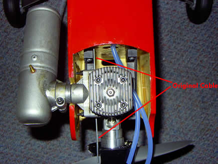

This is a “How To” on changing over the 4 Star 60 braded throttle cable system to a solid push rod system.
This is my first build and so I am not an expert and the following example has not been handed down from God on a stone tablet… But it worked!!! And so I thought I would share it… Being that 4 Star 60's are very popular on this board...
For those who don’t know the 4 Star 60 has a “Snake” system for the throttle pushrod. This consists of a thin braded wire cable running through a plastic tube from the throttle servo to the carb of the engine.
When I saw this system for the first time I thought it looked dodgy… And I now hate it!!! It is very fiddly to install and a general pain in the bum!!! Although I know a lot of builders have used it with great success and some use the system exclusively.
The main reason why my Snake was not going to work was that I cut the plastic tube it runs through off at the fire wall, meaning that the braded cable had to run about 4 inches to the carb outside of the plastic tube causing the cable to flex and the connection between Servo and Carb to become sloppy and indirect. I realize at this point that it is my fault the system failed but I had only done what the plan pictured. To bad the plan was for a 4 stroke engine which has the carb against the fire wall. I put this down to inexperience after saying a lot of swear words…
To complicate things further I want to fly this Airplane in two days and my LHS is not open until next Monday so all I had to work with was what came with the 4 Star and the hardware pack that came with my GP RV-4 which I am building too.
Also… I have a 16 once fuel tank in the Airplane which cannot be removed. (I know I know) and the Engine mount, Engine, and Manifold are already Bolted, Double Bolted and lock tightened down which would be a 2-3 hour job to undo and redo and so this bash had to happen around all of those things…
For those that don’t know the 4 Star 60 has a snake because of where the fuel tank is in relation to everything else. It would be near impossible to route anything but the braded cable through the original whole in the fire wall to the servo. Even a Golden Rob would fail.

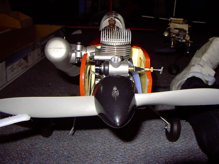

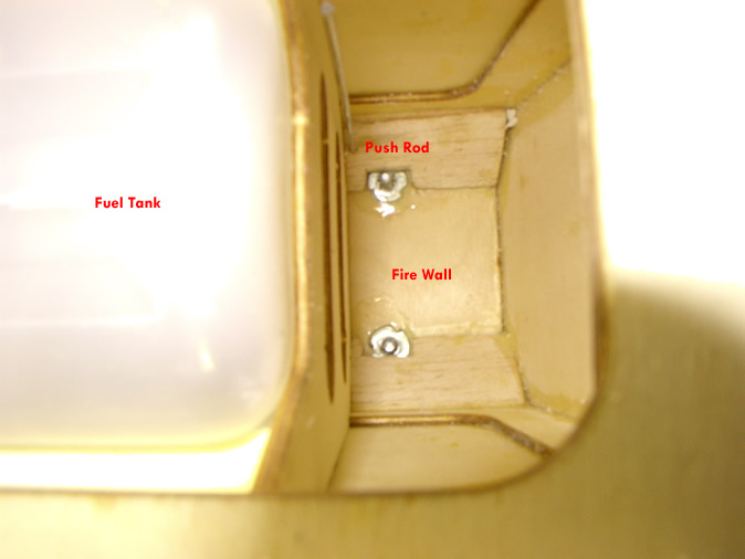

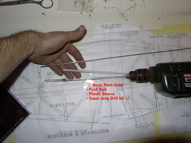

The first thing I did was to drill the new pushrod hole.
This is necessary as a solid pushrod will not work as explained above...
This was very difficult with the engine in but should be pretty easy with the engine out.
It is very important that you drill low enough in the fire wall so that you will not hit the tank or the floor which the tank is sitting on but at the same time you cannot drill too low or the new push rob will hit the wing when mounted.
Of course I could not reach the fire wall with a drill bit because of the engine so I took a piece of pushrod and soldered a drill bit to the end of it so that when mounted in the drill the drill bit would reach the fire wall. If your engine is not in at the time you do this there won’t be an issue.
See pictures…
See pictures…

OK with the new hole in my fire wall I was ready to install a new pushrod.
To my dismay I had to rob one of the nice pushrods from my RV-4… Not pleased but as I mentioned I want this Airplane finished.

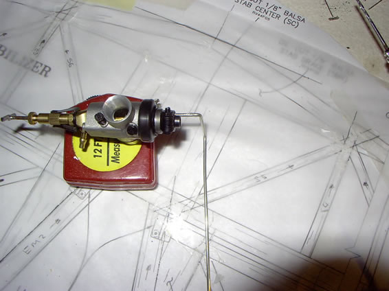

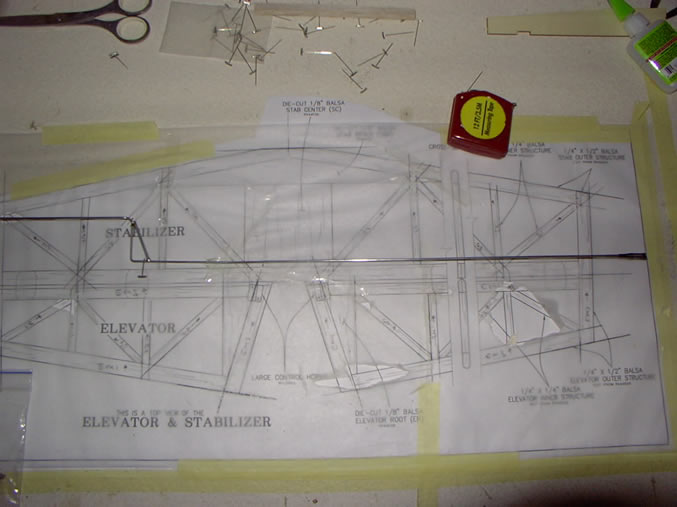

A few bends need to be made in the push rod between it exiting the firewall and connecting to the carb. I can’t really explain exactly how to do this but it requires a bit of trial and error.
I used a piece of paper and pen first to measure the fundamental bends and then used a scrap piece of pushrod to practice on and ensure my bends and calculations worked.
I then worked out how long the push rod needed to be taking into account the bends and distance to the servo. Then I cut the pushrod. The length only had to be exact to the nearest inch because the servo end is threaded and so I have some adjustment in the clevis. I got it pretty much right though.
I tested everything and it all worked out. You may find you have to make very minor bends in the pushrod here and there to stop it binding but it is a pretty straight run to the servo after the difficult bends up to the card.
I also soldered a cross member where the major 90 degree bend is to stop any flex.
See pictures…

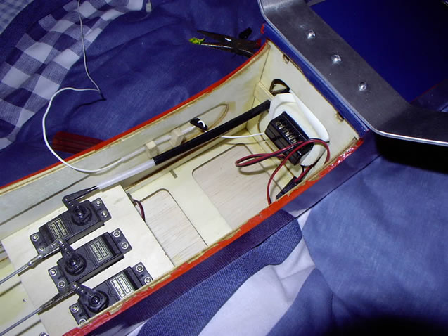

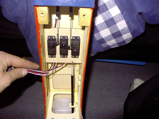

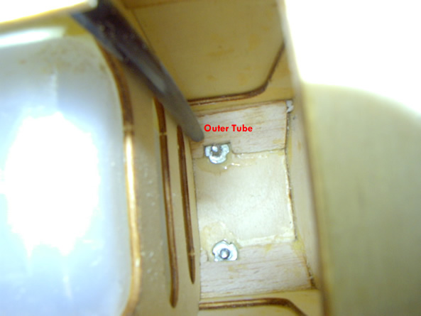

OK with that end done all I had to do was clean up inside…
I thought the pushrod system for the elevator and rudder was pretty good so I just used the left over scrap from those pushrods for the new throttle pushrod.
The white inner tube runs as far to the fire wall as it can without hitting it when the pushrod is operated.
The black outer tube runs all the way to the fire wall to stop flex in the pushrod and also to stop fowling of the pushrod as the Battery and Receiver are tucked in there too…
I also added a tag which you can see the outer tube running through to prevent flex.

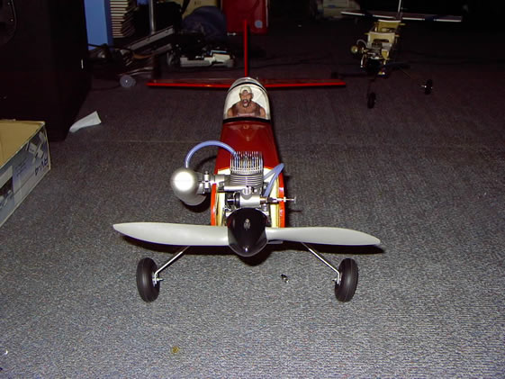

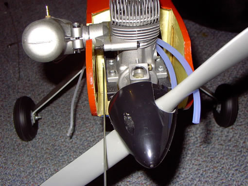

All done… Works Awesome!!!
You need to use the longest servo arm you can without hitting the side of the fuse to ensure full open and shut throttle…
This is by no means the only way to do this, or the best way… And considering the conditions I was working under it took some time but anyone who decides they don’t like the snake should give it a go…
Let me know if anything is unclear…
And sorry all you Snake users HAHAHAHA….

No Duct tape sorry... But I tested the system with the motor running and it works very well...
Nice smooth action and in my opinion much better then the original snake...
