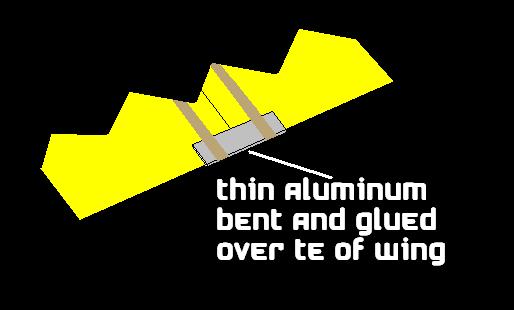

I am ready to maiden my Kadet Senior but have a problem.
The #64 rubber bands seem to short.
The wing root is 17".
I can with some struggle stretch strait accross the root but there is no way I can get any on diagonaly.
How tight should rubber bands be?
What suggestions do any of you have?

Default RE: Rubber bands too tight
I attached a pic of a simple fix Ive used before. take a thin sheet of aluminum (you can buy it at lowes, ace, hobby lobby...etc), cut a small section out and glue it over the TE of the wing...works great and it doesnt add enough weigh to even notice.
AZ
