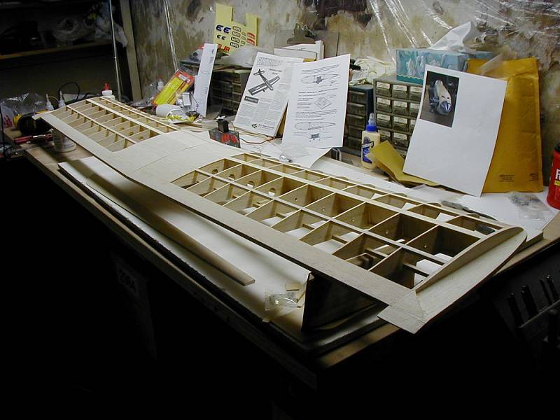

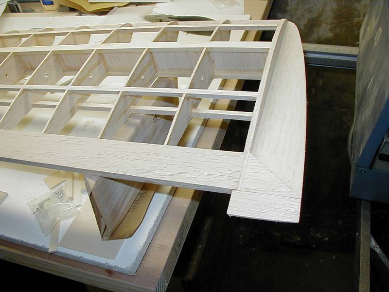

I built the right wing last night in about 3 hours. I layed everything out dry to make sure I had it all right and all the pieces were there. All went very well and yes, I did place the holes in the ribs for the servo wire for the ailerons as well as the ones that are recommended to allow heat to escape when covering. Tonight I want to reglue all of my joints with medium CA and lay out the servo bay. I didn't sheet the bottom of the wing as yet due to having to place the block for the wing dowels. If it isn't too late I will start on the left wing in the hope of getting it close to completion. Question..is it better to wait until the covering in on before you make the slots for the hinges?

OK, second wing is built but I still need to trim the spars and sand. Its dry but the fumes from the CA are killing me.....no windows in the basement....[]

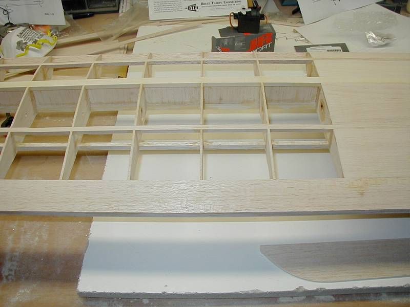

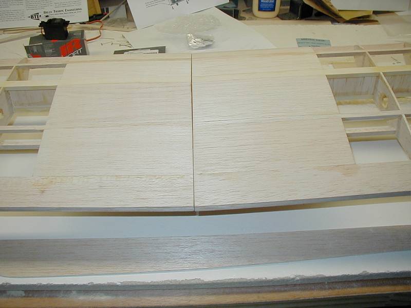

I have just about finished the wings but have to install the dowels before I finish the bottom sheeting. I am now installing the framework for the aileron servos. Let me know what you think up to this point.....

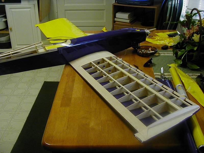

Since you were asking for the 'non-obvious' tips earlier on, here's one concerning the dual aileron-servo mod. When you hinge your Ailerons ignore the hinge locations on the plans. Those are layed out to take into account the control horn for the single servo setup, this control horn provides strength on the inboard tip of the aileron.
With the dual servo setup you will not have that control horn on the tip and therefore if you use the standard hinge locations you will end up with a Aileron tip that can move freely in the wind (flutter comes to mind).
How do I now???? Sufice to say I now have Ailerons hinged using 5 hinges instead of 4 and two of them are fairly close together . I'm just glad I noticed on time to correct it on my Venture.

Thanks Johan, thanks for the tip on the aileron hinges, I have a few extra's so I will throw them in. I also build on a door and was able to pick up a package of ceiling tile 2'x 4' for next to nothing due to damage on the back of one sheet. I figure I'm good for about 16 builds or so I am installing a Saito 100 inverted and will be bulding a cowl, I also want to move thre cockpit a little farther back. I'm in no big hurry to finish this but will maintain a constant speed until done. How did your maiden turn out...great I hope!

I think if you plan for a hinge on both aileron tips and then 2 distributed evenly between them (so total 4) you should be ok. Ofcourse having 5 won't hurt but I don't hink it's necessary.

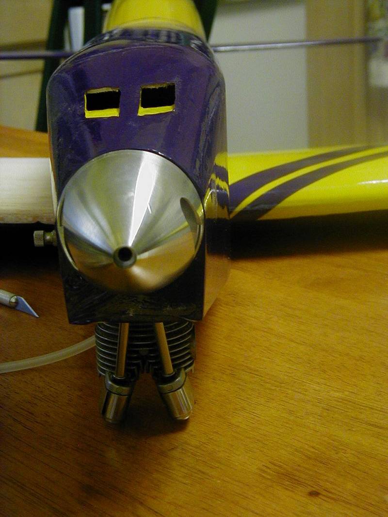

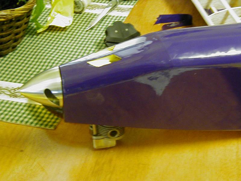

I'd be interested to see how your cowl turns out in the end!

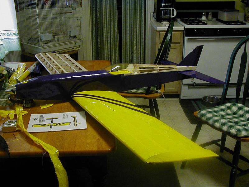

buteos,looking good so far,i would have liked to build a cowl for mine but i do not have the time this time around,so when you do build the cowl lets see some pictures id like to see how you do it. i like flying it so much ill probably build another this winter and do some more mods myselve when ill have the time when the snow flies
