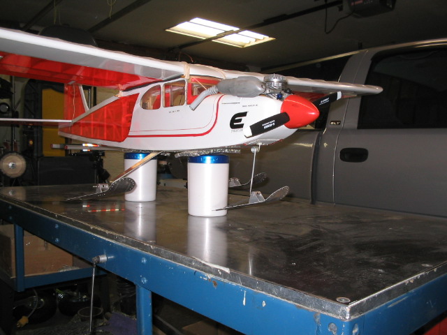

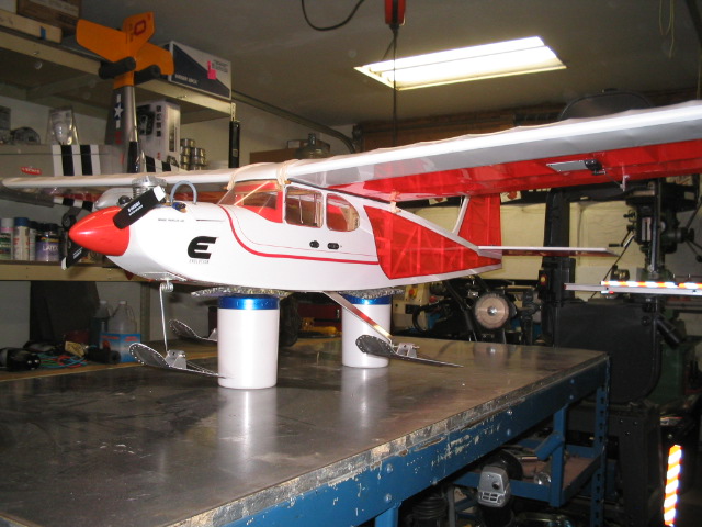

Winter flying
Well the snow is starting to come so I ordered a set of skis today for the Kadet ( http://www.greathobbies.com/products...rod_id=JADS360 ) and was wondering some of the things a person needs to do for setting up the plane for winter flying.
Some of the things I was pondering are:
Run a higher nitro fuel- I'm burning 15% now, step up to 20 or 30%?
Go with a hotter plug- Using OS8 now, step up to an A3?
Larger battery capacity- Have 600 mah now, go up to a 1100 mah since capacity drops in cold temps
Some kind of heat shield for the front of engine cylinder?
How does the covering fair in cold temps? I have the plane covered in Ultacote, will it be brittle and break easy?
Any other things a person needs to address for winter flight that a person can think of.

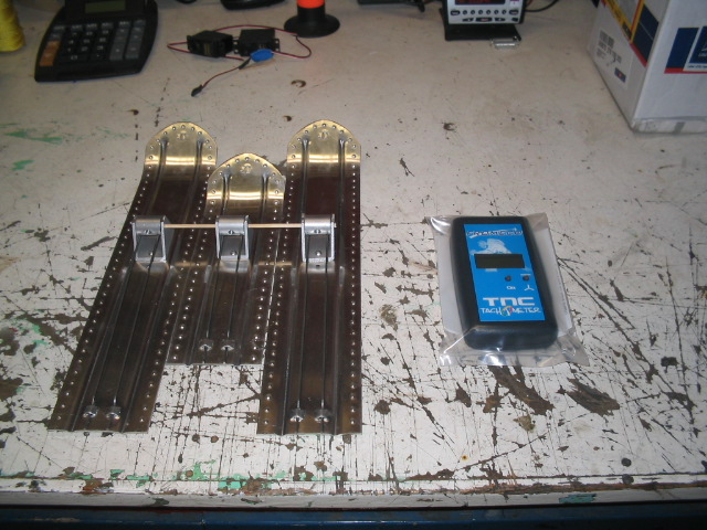

RE: Winter flying

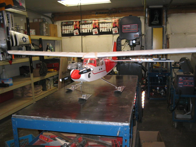

Ooooo. I like those aluminum skis. I have DuBro plastic and they hold up fairly well. I keep spare gear set with skis for two of my planes so I only have to remove four bolts and can swap from wheels to skis without reattaching and tensioning the springs & torque rods.
http://www2.towerhobbies.com/cgi-bin...?&I=LXWH30&P=7
One of the guys in our club laminates his own out of thin ply veneers and they look great on his vintage biplanes.

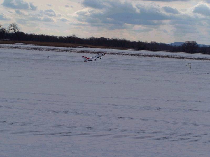

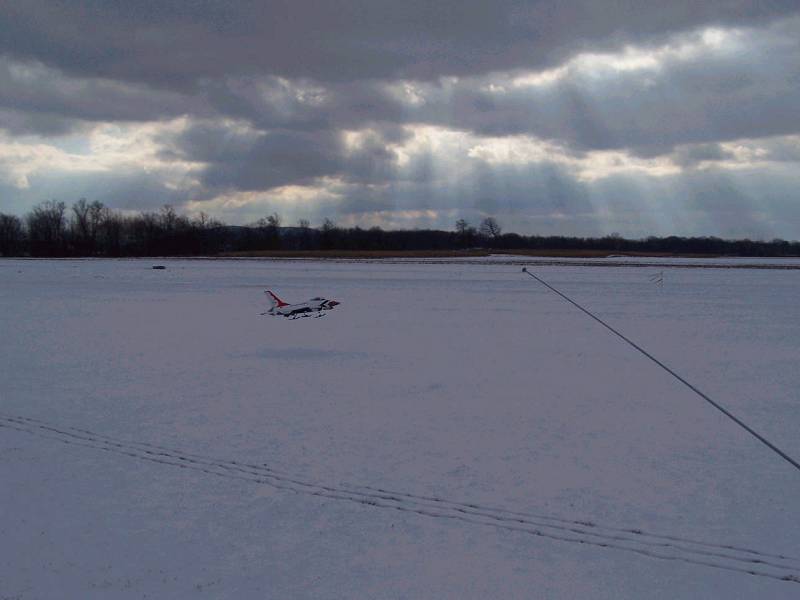

Single digit temperatures build character.
Actually it was a balmy January 1st when this was taken. Note the towels over the engine and flight box to keep the SLEET off things. Ugh.
Got deicers?

Well the skis showed up.. and were going in ! The temp is falling..but the wind is climbing [:@]It fiqures, bought a 13hp snowblower last year and it didn't really snow till March.[]
But will get the skis on the Kadet and if it can hold on the snow I will get the Decathlon up for a madian

Do those skis have runners/blades underneath? That's one thing I wish the DuBros had. I've had crosswinds take my slab-sided & large ruddered SK-50 sideways across the snow if it's crusty. The tail wheel catches and suddenly you're pointing downwind with no brakes!
They look pretty jazzie! Keep us posted.

Charlie P- They have two runners on each ski, you can kinda see it formed in the ski
AKFireMedic- they are Jay Dee skis. I have a link to them on my first post. These are for 60 size planes. They make them for all sizes thou

RE: Winter flying
Got the skis on tonite...not sure of what AOA to put on them, so I went with this (pics). The CG ended to the aft limit without changing anything, so with taking on a 1lb of fuel on full I left it as is. The plane is 8lb 13oz empty. It was late so I didn't get to put the plane in the snow tonite to see how the skis support the wieght. But just looking at it, I think I will have to have a good hard pack for a runway.
What do you guys think?
flynte

RE: Winter flying
looks good.
I know i read somewhere about skis and what angle they should be put at. Don't remember where though. I know that if they are not quite right they can make for a pretty hairy flight. I would say see if you can find some pics of full scale plans with skis in the air and see what the angle is

RE: Winter flying
His look good. Tipped slightly up. That's the way I set them up. They're designed with the pivot ahead of the CLR so the wind striking the low rear tends to level them out in flight. Tipped down is bad. The more air they catch the worse they tip. Drag brakes. And you'll also catch every depression in the snow when landing and taking off. Tipped up you can even almost occasionally sometimes get over a boot track without sinking it and stalling the prop in the snow.
Yell at anyone who tries to walk directly out and retrieve a model on the runway. Better to walk along the edge or the long way around so you keep the main strip ontrodden.
