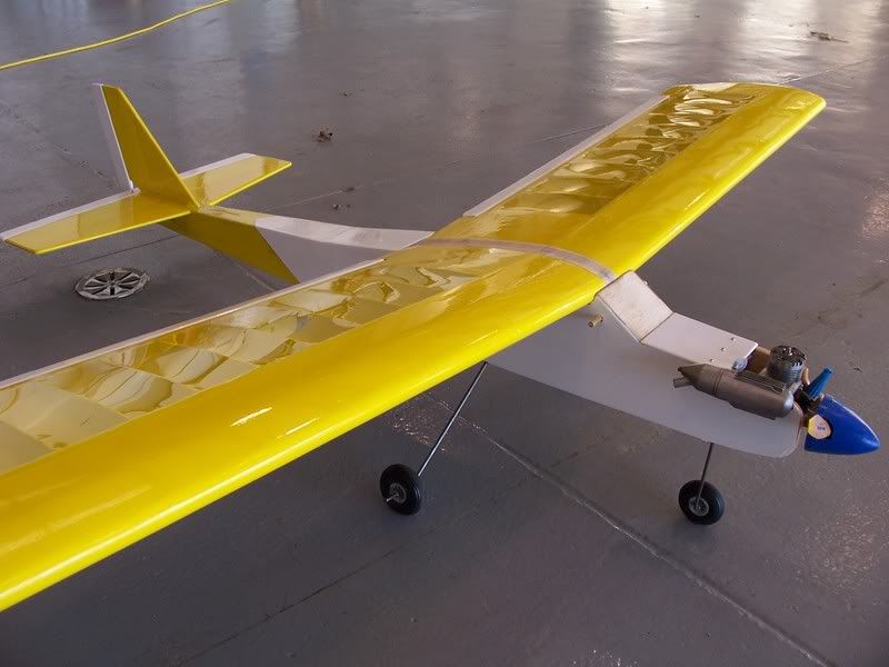

I built a pt-40 for my first plane and it flew very nicely. The only problem I do beleive was the lenght of the landing gear, I found they were way to long for our grass runway and flexed consideably which made it hard for a straigth takeoff sometimes. but other that it was a good plane to fly (when i had it).
Adam

It's easy to replace a trainer's wire gear with sheet aluminum gear. As already suggested, it will make ground handling easier and will still be springy enough for novice landings.
Leave the wire gear wood blocks out of the construction sequence. In place of that, install a 1/4" plywood plate the width of the fuselage and as wide as the gear you're planning to use. Install 1/2" tri stock along each side to reinforce it. Drill four 3/16" holes in the gear, near the edge dimensions of the block (about 1/4" away). Use this as a guide to mark and drill 4 #21 tap holes in the ply block. This is a .1580 drill. A 5/32" (.1562) drill can be substituted. Tap these holes with a 10-32 tap. Soak the holes with thin CA. Re-tap. Soak and re-tap again. The threads will never strip out. Use 10-32 x 1/2" pan or round head nylon screws to secure the gear. It takes less time to do it than to explain it.

ORIGINAL: Dr1Driver
Thats what I should of done I knew they were to flimsy it nevery accurd to me to do that. nothing i can do now, what happend in the past stays in the past(or in a garbage can at the feild) and we just have to learn from our misfortunes.
