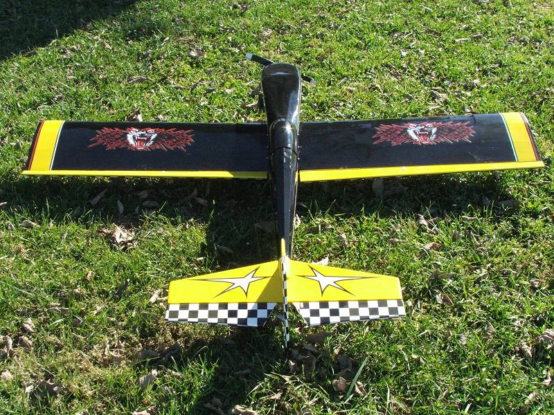

Here's a pic of my "re-kit" Origionaly built frim a kit crashed,Re-built.........Broke my heart when it went in ! But, as they sat they all have "expiration dates".Used a Funtana cowel,flies as good as it ever did ! Flew a half gallon of fuel on Monday!

Wow. Did you just cut the orginal canopy down and blacken it? Where did you get the cowl? Any photos of the mounting for the cowl?
How did the drilled landing gear hold up in the crash? Neat plane. Thinking ahead, I might go that route.

Thanks ! Yeah the canopy is a cut down blackened version of the old one. Sorry don't have any pics of the build, but all I did was lay the remains over the blue print and widen the front of the fuse. evenly on both sides to accomidate the 40 size Funtana cowl. Found it at our local hobby store just looking for one with measurements close the the 4*. She's got an inverted Saito 100 and after some fine tuning,runs like a champ ! Also bought some heavier landing gear,old ones held up o.k. but figured while I was at it why not upgrade. Took care of those bouncy landings,for the most part. Now if could only learn to flare at the right time I might just grease one in !

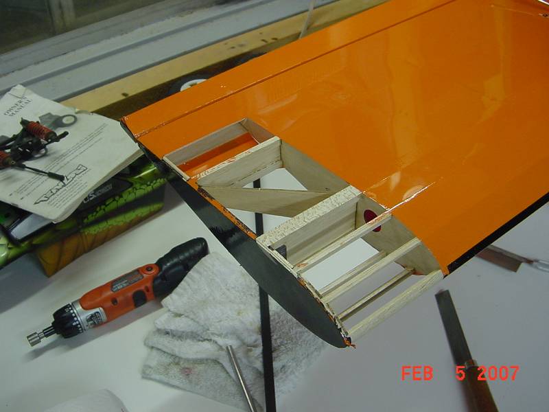

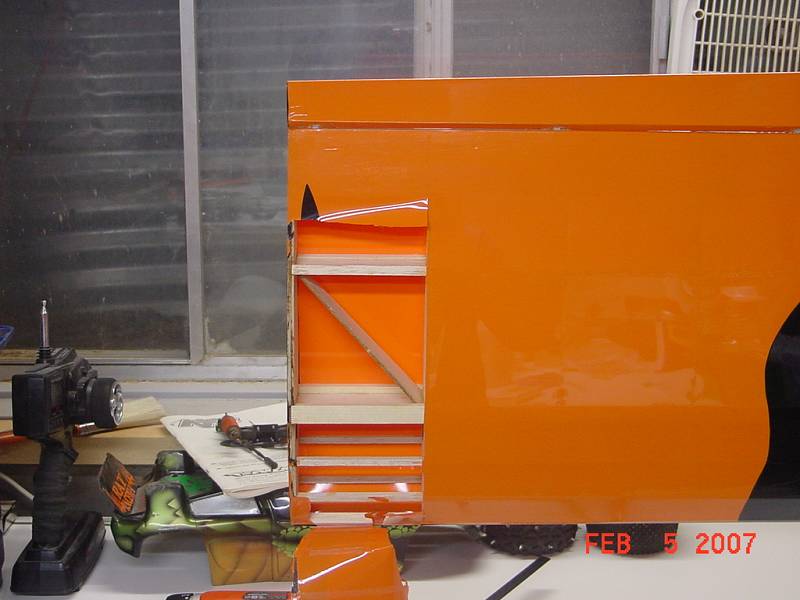

The the hinges didn't have as much as much wood on them as the one in your picture. There is a little right where the hinge entered the aileron/wing but very little, if any, towards the ends. The part that was sticking out was sort of stiff like it had glue on it.
When I assembled the ailerons I noticed that the hinges slipped into the slots very easily, like the slots were too big. Maybe I should have squeezed the surfaces on the top and bottom of the hinge slots after I put the glue in to get better contact. I have the pinned hinges on my shopping list.
I now have the wingtips repaired. I need to cover the wing and install the right aileron and remove/install the left aileron. I have started on the fulelage and have it repaired and braced from the middle of the cockpit to 3 inches forward of the leading edge of the wing. I have cut the wood that goes from where I am up to the firewall.

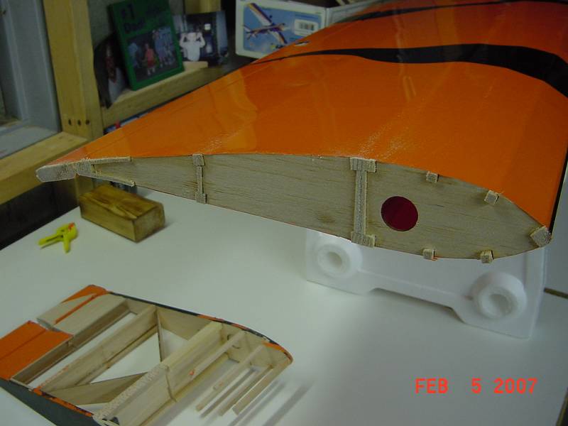

Cecil, you said the wingtips were badly damaged?.. Was it just the outer edges of the wing? If so you can cut the entire bay off the end of the wing on both tips, this will shorten the wingspan 6" total (3" on each end). Then just add a piece of 1/4 or 1/8"ply to the end. It will not change the landing characteristics at all and it does improve the roll rate bit as well. It also took about 6oz off the weight of the plane. Heres a couple pics of it in progress.

Thanks for the tip and the photos. The damage was on the outside bays on both wings as you suspected but I already repaired them. The damage was only to the leading edge and a couplle of the little 1/4" sticks. It wasn't as severe as I first thought.
After I am more experienced I will cut the outside bays off like you suggested. I need to get a saw something like you have there. Looks like it could be a big help to me at the rate I'm going. Seems like I'm always needing something better than the saw that I'm using.
