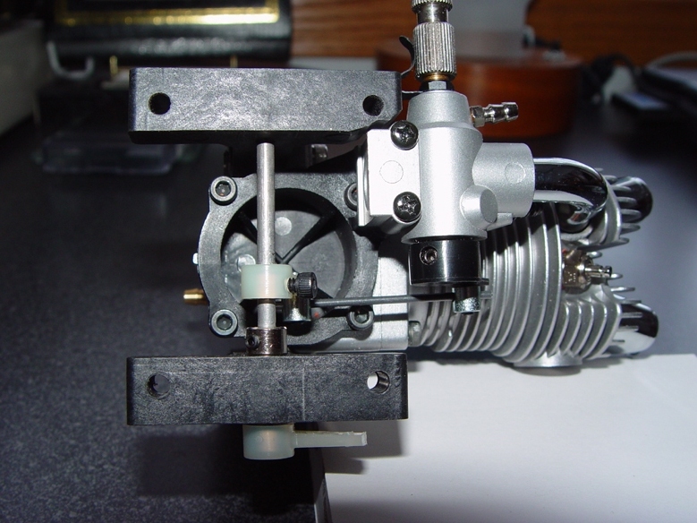

Here's what I've done:
ID:	691349   Click image for larger version
ID:	691350   Click image for larger version

ORIGINAL: krossk
krossk,
I love that setup. How does that work with the fuel lines, coming through the firewall?
EJ

So far, it's worked pretty well - but I've only flown it once. (The first 2 pics are from the .72 in my SSE. The last one is a .82 going in my Tiger .60 and is still under construction.)
There are no problems with fuel lines through the firewall - in fact it allowed me to set the tank height a bit lower to match the engine position. The only (minor) quirk is that the linkage is not perfectly linear. That is that half throttle on the stick is more like 3/4 throttle. That is most certainly caused by the geometry and alignment of the linkage, but that was the only way that I could operate the throttle with the carb oriented with the needle accessible from the top of the plane. It wasn't really enough to be a major issue, but I'm going to play with a throttle curve to see if I can even it out a bit once I get the rust off from the winter hiatus and comfortable enough to take it up again.
It was also a personal challenge just to see if I could make it work cleanly. I made a few other mods to the plane simply for the challenge too. (e.g. built-up cowl, larger rudder, pull-pull rudder & elevator, etc.)
