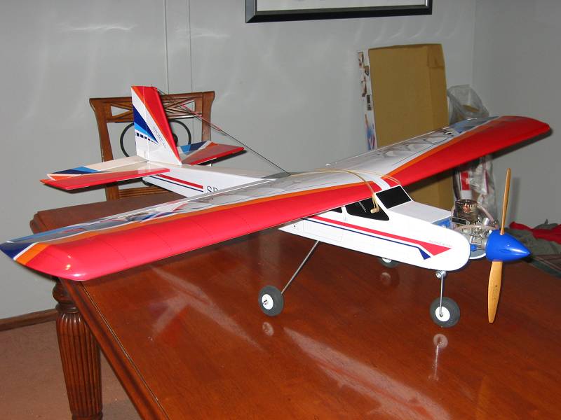

The Solo Star is a pretty good package overall, but there are a couple of things about the plane that are bugging me. The covering sucks. The Solo Star is a Value Series ARF, and it uses a shelf paper type covering rather than Ultracote. It splits easily and wrinkles don't respond very well to heat. I already have enough box tape on the wings that you'd think I've been flying it for a couple of seasons already. The wing tips also feature plastic caps instead of being finished with covering. They look pretty good though, and the plastic isn't brittle, so they're not too awful.
The other problem is that I can't get the ailerons to move. The torque rod setup just keeps getting jammed up and I can't get any significant roll rates out of it. I've tried carving out the torque rod channels, flexing the control surfaces by hand to "stretch" the range of movement, and trimming the plastic wing tip caps away from the ailerons, but to no avail. My original Nexstar rolled like a Super Sportster compared to this Solo Star trainer.

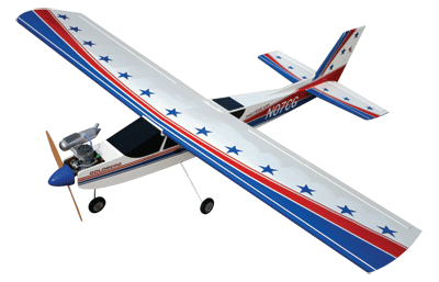

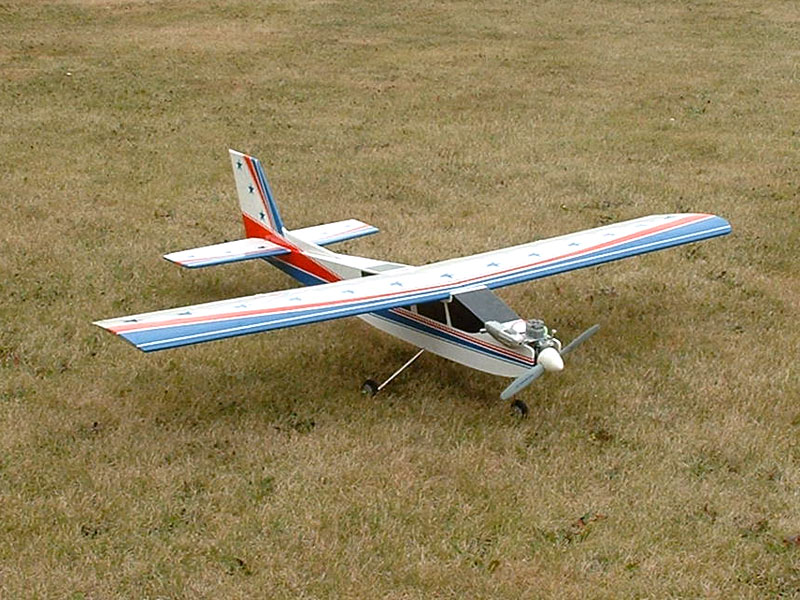

Tonight I decided to take the plunge and buy myself the nicest trainer that I could think of. I'm going ahead and taking advantage of the Great Planes sale on the Goldberg Protege .60 ARF, I ordered one from Omni Models for $119.99 delivered.
At a wingspan of 71.5", it's about as large of an airplane as will fit in my Hyundai Elantra. I have a new-in-the-box Thunder Tiger GP-61 2-stroke that should go perfect with it. I'm excited about the fact that the Protege .60 ARF comes covered with Ultracote, and that it uses dual aileron servos. I think this is going to be a nice large trainer that will be slow and gentle and easy for students to fly yet flexible enough to rev up and have fun with when I'm flying it alone.
I considered the Sig Kadet Senior ARF, but I didn't think it would be as aerobatic as the Protege. It was also $100 more expensive. I also seriously thought about trying the VMar Apache III ARF, but I decided to go with the Goldberg instead. One of these days I'm going to try a VMar ARF just so I can find out if they're worthy of all the abuse people seem to heap upon them. With the Protege on sale for almost the same cost as the Tower Trainer .60 MkII ARF, I figured I would go ahead and treat myself.
I'm excited about this purchase. I think the Protege will be a good trainer for me to fly for a long time to come. I also hope that I can hang onto it for a while and that I won't be in the trainer market again for a long time. This is my fourth season flying RC planes and I'm flying 3D planes, pattern planes, scale IMAC planes, and helicopters. I still can't imagine being "bored" with flying a trainer. I hope I always have a nice, big glow trainer in my hanger to share with others and to enjoy on days when I just don't feel like flying 100 mph with my hair on fire.
There is a picture of each of my previous and current trainers. I have fond memories of each of them. I'm happy to report that a fellow club member bought my old Easy Fly 40 at the auction last year and he flew it at our Memorial Day egg burn. I think I was more excited to see it flying than he was.

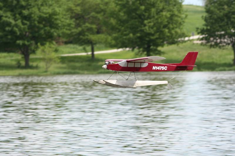

Yeah, trainers are great for nice, relaxing flying. They're also great on floats. One of the guys in our club has an old Protege 60 Kit with an O.S. Max .61 FP on it that he flies on floats and on wheels. He says it's one of his favorite planes.

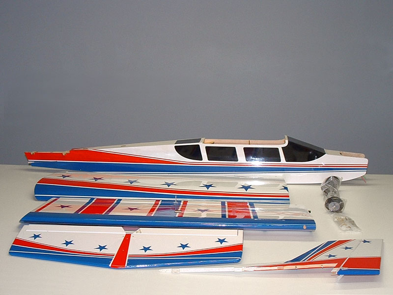

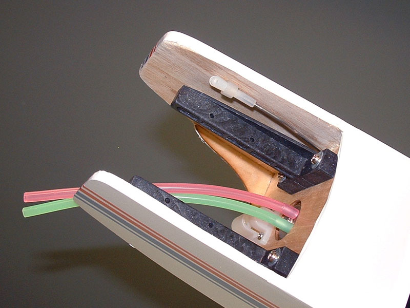

Wow! I had no idea exactly how much prefabrication was done to this ARF! MinnFlyer's review talked about it without really emphasizing it completely. The control surfaces are all pre-hinged, and the control horns are attached. The engine mount is attached and pre-drilled for a .61 FX. The fuel tank is installed and plumed. The pushrods are all installed and there are EZ Link connectors on the throttle and nose gear rods and L connectors on the elevator and rudder push rods.
This might be one of the quickest building ARFs on the market. I feel dumb that I don't have my servos sitting here, or I could build this whole thing tonight and fly it tomorrow.
My covering isn't anywhere near as perfect as MinnFlyer's review plane. It looks like I have some ironing to do, but nothing that should take much work. If you're looking for an ARF that you can get in the air quickly, this has got to be the ticket!

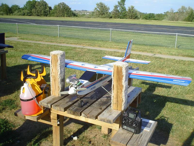

Well, after getting tied up at a wedding all weekend two weeks ago, then helping out at the Omaha Pattern Championship last weekend (grill master), I finally managed to get the Goldberg Protege .60 ARF buttoned up and out to the field.
I still had to check the CG, do a range check with the new RDS8000 radio system, and break in the Thunder Tiger GP-61 and get it running. One of the best pieces of advice I've heard is new airframe = old engine, new engine = old airframe. The idea is that you don't want to have to cope with too many variables or unfamiliar pieces of equipment all at the same time.
I took the Protege .60 out to the field tonight not knowing whether or not I'd even be able to maiden it. The first big challenge, the CG test, turned out to be a non-event. I put my 600Mah NiCd pack right behind the fuel tank per the manual, and with the TT GP-61 on the nose, the plane balanced perfectly per the manual.
The next challenge was the radio check. The Protege is the first plane I've set up with my Airtronics RDS8000 radio system. I've been flying a Futaba 7CAF radio for the last four seasons, and I'm still learning some of the funtionality of the Airtronics radio. I took my manual to the field with me and range checked the system very thoroughly. I did 35 paces from the left and the right of the airplane with no problem. I had some friends hold the plane on it's nose on the starting stand and then tested 35 paces from the top and bottom of the plane. With the bind light blinking steadily to indicate I was in range test mode, the radio system never skipped a beat.
Ironically it was the engine break-in, the task I was least concerned about, that turned out to be the most challenging. The TT GP-61 was really tight and, while I had trickle charged the transmitter and receiver batteries for almost 20 hours, I hadn't charged up my field box battery for my starter. The GP-61 just didn't want to fire up at first. I kept spinning it and spinning it trying to get it to fire, but with the very tight pinch and the weak starter battery, the engine seemed to hydrolock quickly.
One of my fellow Omahawks took pity on me and brought over his 20 Amp motor cycle battery and high torque starter. I removed the glow plug and carburetor line to blow out the excess fuel, then the extra cranking power did the trick. We got the engine running and adjusted the high end needle to 1/4 turn rich of peek, and the GP-61 gulped down its first tank full of Magnum 10% sport fuel like a hungry calf.
After the first tankful of fuel, the GP-61 was much, much easier to start. It also idled down and transitioned surprisingly reliably. I couldn't drop down to full idle on the throttle stick, but I believed the plane was actually flyable at that point. I let the engine cool down for about ten minutes after the intial tank of gas. Once the GP-61 rested for a while, I topped it up and decided to take the plane up for a flight. Normally I'd do more tuning work before maidening a sport plane or pattern plane, but I was confident that a dead stick landing would be little drama for the Protege .60 ARF.
The initial flight started out a little hairy. I needed several clicks of left aileron and down elevator to get the plane even remotely trimmed out. The GP-61 after one tank of fuel on the ground was running reliably, but was far from turning the prop at the ideal speed. Even light on power, however, I had the airframe trimmed out decently and was flying loops and rolls and doing inverted circuits after a few minutes.
The roll rate is wonderful; I didn't reduce the throws on the ailerons and the big 6' wing rolls surprisingly well. The elevator authority is also very good. I wanted a nice big trainer that would be easy to fly but would be sporty enough to be fun to fly when I wasn't buddy boxing students. This Protege .60 ARF will fit the bill nicely! The red, white, and blue trim scheme displays nicely at altitude. It's nice to have a trainer that has a high visibility trim scheme on the bottom and the red and blue bars were very easy to see from the ground.
I flew the plane at altitude until it ran out of fuel. The initially out-of-trim elevator turned out to be a good test for the radio system during the first flight as the plane got much higher and further out from me than I'd intended it. The RDS8000 was rock solid at all angles and orientations with the quick response time of the radio system being readily apparent as well. The gentle glide path and smooth handling of the Protege provided welcome confidence as I glided the trainer in for it's initial landing after the engine ran out of go juice.
I enjoyed the initial flight and it was a beautiful evening, so I decided to fill up the Protege's fuel tank and go up for another flight. The GP-61 was running smoothly and reliably and the Airtronics radio system was crisp and responsive. I continued to enjoy more loops and rolls, I also decided to try a Cuban 8 just for fun. The big trainer rolled through the Cuban 8 so smoothly that I wished I'd finished it a week or two ago. I could have flown the Sportsman schedule with it in last week's pattern contest. My attempts at a wing-over turn left a lot to be desired, however, so maybe I should be glad I waited to maiden the plane.
I flew the Protege around again until the GP-61 drank the fuel tank dry once more. The big trainer glided down smoothly and gracefully once more, and with about half a dozen of my flying buddies looking on, I performed a nearly flawless landing. It looked like I'd been flying the Protege all summer. I proclaimed that the landing was all due to my expert piloting skills, but the guys knew better!
I will continue to work on fine tuning the control trims and the throttle linkage. I think the GP-61 will need several more tanks of fuel through it before it really begins to settle in, as well. Overall I'd have to say that the Protege is still a work in progress, but I'm really happy with how the plane is turning out. With the proper trim and tuning, this is going to be a terrific all-purpose flyer.

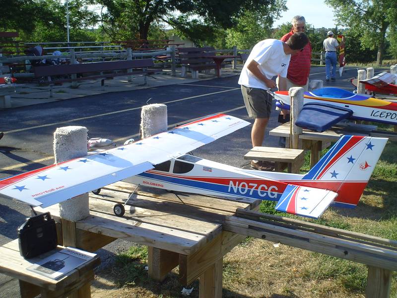

I took the Protege 60 back out to the field yesterday along with both of my RDS8000 transmitters and my Airtronics buddy box chord. I was hoping my friend Mike would make it out to the club so we could do a couple of training flights together on the new plane. I had tested the buddy box features at home a bit, but hadn't yet put them to the test out at the field.
Well Mike couldn't make it out, but it turned out to be a very good thing that I brought out the second radio and cable. Jim and Mary, a couple with an interest in checking out the hobby, stopped by the field to watch a few of us fly yesterday. I got to chatting with them between flights about our club, our Thursday night training program, and getting started in the hobby.
Jim and Mary seemed genuinely interested and began talking about coming out Thursday night and then again visiting our field for our big Labor Day Air Show next week. Realizing that I had a full buddy box setup available for the Protege 60, I suggested there was no time like the present. I offered to take Jim up right then and there on an intro flight and let him try my new plane out on the spot.
While I was getting the two transmitters connected up and double checking the controls, Adam, one of our newer club members, overheard our conversation and asked if I was going to be buddy boxing my Protege .60. I replied that I was, and Adam asked if I could give his girlfriend JoAnn and his friend Jeff each an intro flight. They'd both been interested in giving flying a shot but hadn't been able to come out on Thursday evenings.
Jim and I went up for the first flight and I talked to him a little bit about the controls and using gentle stick movements to control the plane before giving him control of my new Protege. When I first gave control over to Jim, the plane ballooned up rather noticably. I realized we'd need some help adjusting the trim on the RDS8000 I was using for the buddy box. My buddy Roland helped trim out the second RDS8000 and we got things smoothed out, then handed the second box back to Jim.
He took the lessons to heart apparently, because he did an excellent job right off the bat of making smooth movements and not overcontrolling the plane too much. We offered his wife Mary a turn on the sticks, but she didn't have her glasses with her. She sounded genuinely interested in giving it a try on Thursday night, however, and I wouldn't be too surprised if she shows up later this week ready to take her turn at the sticks.
