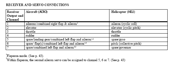

I'm just about finished with my airplane and want to try and get it out to the field today but can't figure out how to connect all the wires.
Does the receiver just get hooked up to all the servos and which one goes to which channel? The jacks are numbered 1-7. Does the receiver need to be hooked up to the battery?
Where does the battery get connected to? I have three wires from the switch and a jack on the back of the charging jack I installed. Nowhere in the Futaba 7C manual does it show how to hook all these wires up.
Please help!

The battery will plug into the switch and you plug the switch into the receiver. Look at the last plug and see if it has a B next to the number, you plug it in there. Each spot on the rx is in the manual on page 14.

Jim,
The channel assignments are listed on page 14 of the manual: [link]http://manuals.hobbico.com/fut/7c-manual.pdf[/link]
The channels for the Futaba are assigned as such.
1- Ailerons
2- Elevator
3- Throttle
4- Rudder
5- Landing gear/ left flap and aileron/spare
6- Flaps/combined left flap and aileron/spare
7- Combined left flap and aileron/spare
The battery will usually be hooked up to the last slot (usually labled "B"). But the battery can be connected to any open channel slot as it doesn't matter. If all slots are full you can hook up a Y-harness into any slot and hook the battery to one side and the servo to the other side.
For your switch. There will be one side of the switch that has two wires coming out, and the other side has one wire. The single wire goes to your receiver. On the two wire side one wire goes to your battery and the other wire is used to recharge the battery.

As for the three wires coming off your switch - one goes to the charge jack, one goes to the battery, and one goes to the RX. If your RX doesn't have a port labelled "battery", then just plug it into any port you are not using (flaps, gear...).
If you accidentally mix up the switch wires for the RX and charge jack, then off will be on and on will be off.
