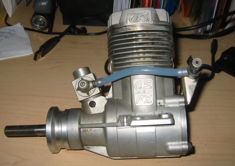

I just purchased a used QQ Yak which included a used OS Max 1.60 that is in fairly good condition but it needs bearings so I'm going to attempt putting them in. It also has a muffler that is in pretty sorry condition on the outside.
I heard from a guy in our club that soaking an engine and parts in antifreeze in a heated crockpot will clean parts like new. Has anyone had experience doing this? I'm going to go out and get a cheapy used crock somewhere and try it.
What temperature and how long do you soak for generally?
Is there a better method? I've heard dawn power disolve works wonders too.
Thanks.

I got the engine disassembled and borrowed the crockpot from my friend. Here's a before picture (along with the new bearings); I'll post the after picture of all these parts tomorrow sometimes after 24 hours in the kettle

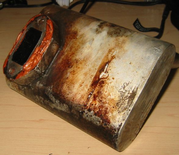

Well, I just pulled the engine parts from the crockpot and wiped off the antifreeze with a paper towel and they look pretty good. I'm satisfied enough so I am not going to get the Dawn just yet. I now have the muffler, which was really bad, see my prior post above, in there and will see how that looks tomorrow. If it's still pretty bad after pulling it out tomorrow and scrubbing it with a scotch pad, I'll try the Dawn and post my results.
At least I can put the engine back together now

LOL. Thanks for the concern, but on the outside of THIS muffler, I wouldn't care if I ended up using a Brillo pad, much less a fine Scotch pad. Shoot, I'll try scraping it off with a putty knife if neither one of those work!!

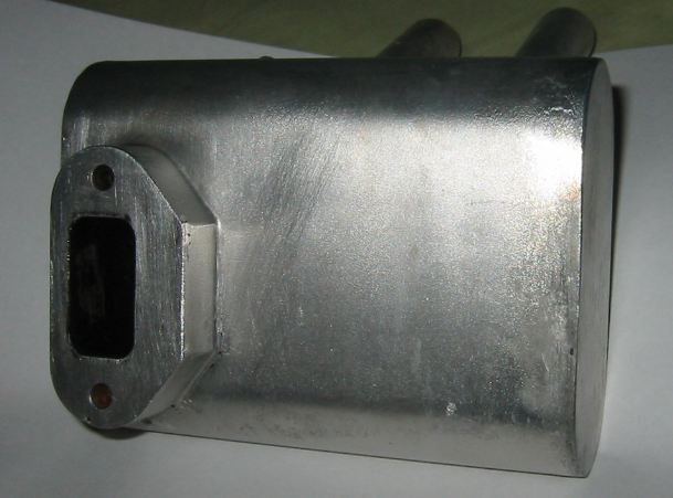

Well, I pulled the muffler out of the hot antifreeze after just a few hours in the crockpot, then scotch brited for about five minutes, and finally scraped some of the black deposits that wouldn't come off and scotch brited, rinsed and dried, and voila - pics before and after below!! Needless to say, I'm pleased.

Your muffler looks really good and Scotch Brite on the outside will surely not hurt it. My information on Scotch Brite comes from an engineer at the Cadillac factory. Using Scotch Brite leaves very small particles that if not properly removed do what abrasives are meant to do and if that is the inside of your engine, well . . .
Rubbing compound and polishing compound could also advertise themselves as not causing scratches I guess.

Thanks for the tip. I rinsed off the muffler really well afterward, and then hand wiped it dry.
