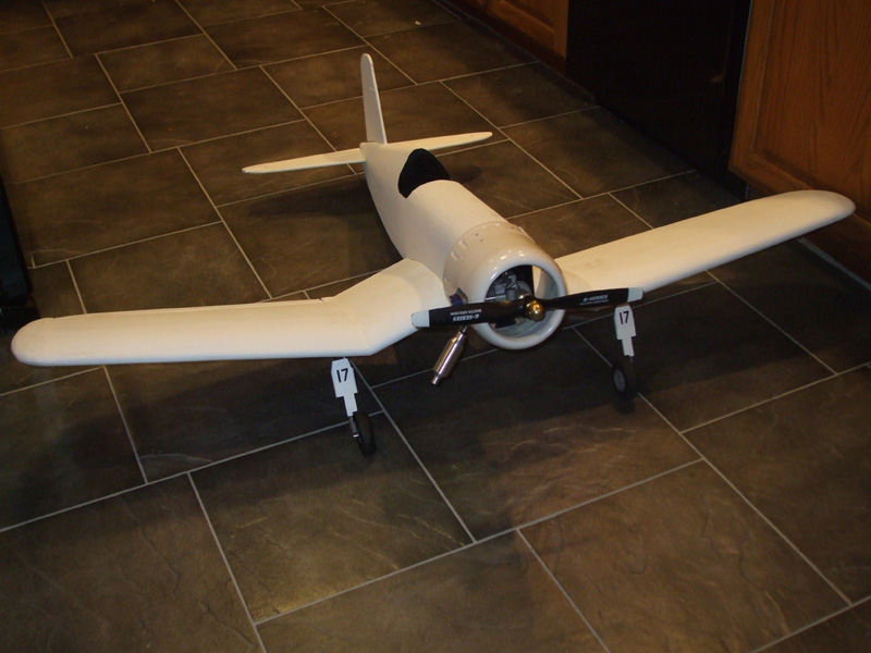

RE: Automotive paint
Looks good capt'n.Spraying any 2k colour or clear over solvent based acrylics is usually avoided because the solvent takes months to release from the paint film(work harden)regardless of temp and will push the non porous 2k top coat off acrylic.Seen and fixed that hundreds of times.
Stevenmax, I am the same way with this process. I pretty much asked the paint guy what to do and what to mix and it's worked so far! I do have Nelson Thinner, not sure if this is the same stuff you are takling about because I got if from the auto paint store. Definatlely use the right thinner for the job. This thinner I have is powerful so be careful with it, but it makes the job so much easier! More pics to come once I shoot the intermediate blue.

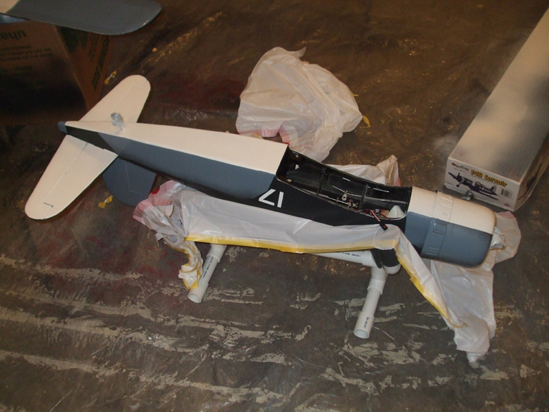

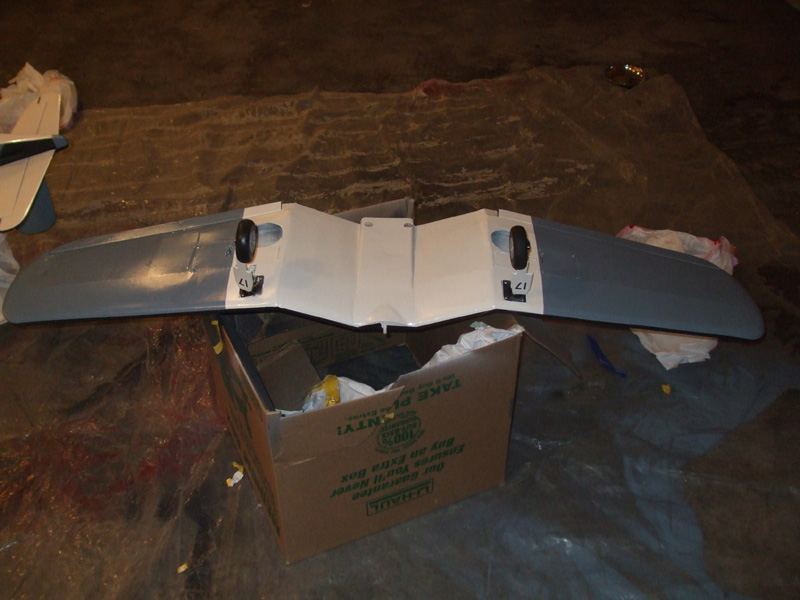

Just an update on my painting progress. We masked and paineted the intermediate blue last night. My buddy got sick overnight so I decided to venture off on my own tonight and go for shooting the white underbelly. I think it turned out pretty good for a first time painter like me. I am quite pleased. Now it's on to decal application, final ballancing and testing so I can maiden her later this month!

I was in Huntsville back on Monday. Thats a 1.5 hr drive for me so I do all I can when I go there. There is a nicely stocked LHS there. Except the only 2 kits they have are the Corsair and a Mustang. And 200 ARF's. That is no exageration. Plus the employees no nothing about building, painting, etc. But if I know what I want at least they probably have it in stock. So thats cool. The reason I bring up my little H'ville trip is that I was drivin down the road and there was a Harbour Freight!!!. My luckey day. Only problem was that there HVLP guns were 50 bucks or higher. Not alot of money, but so much that I need to add that to the monthly budget. 10 bucks I coulda just spent. 50 I gotta plan for.
Capt, your Corsair is looking good. Keep the pics comin bro. And if you could, a posting with a summerization of your process would be cool. I sometimesforget a step when I read the whole process spread over many postings. Now that I think about it, I should probably gather all the tips I have read from various threads.and put them in proper sequence. Anyway...keep up the good work. Do you have an estimated time for completion and maiden?
