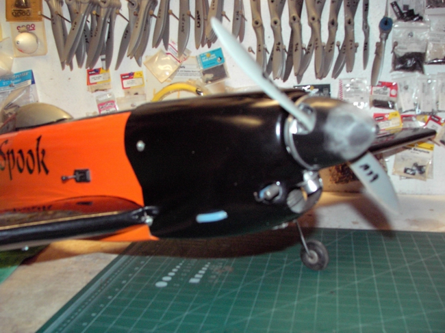

pinch test
when i did my pinch test on my 75 ax it died right away so i richened it a little at a time until i got it too rich and there was still no difference,so i screwed the needle all the way back in and turned it out 2 1/4 turns and started it again tuned it a little and did the pinch test again and it died again i continued to richen it a little at a time and still no luck with the pinch test! what should i do now?
RE: pinch test
The pinch test is for setting the lowspeed needle, right?
Both times you richened it because you thought it died right away. And that didn't work.
Quit pinching because it's either not working with your pinches, or you're not hearing it right, or something very out of the ordinary is happening.
Simply start from that base setting again. Instead of doing any test at all, simply turn it in about 1/8 turn and try the throttle. Keep that up and you'll see improvement eventually or the lowspeed needle will wind up closed. That will tell you that it's not too rich. The last two OS I've broken in both had a really badly set lowspeed needle, over a turn too rich.
There is a chance you're not doing something that needs to be done every pinch test. You've got to run the engine at full throttle to warm it on your first try. Then every try you've got to clear out overprime that came when starting for that run. Each time you restart the engine, advance the throttle to wide open and let it settle. Letting it settle clears excess prime. THEN back it down to idle and let that run a bit before pinching. If you don't clear out the engine before the pinch, you won't get good results..

First, what size prop are you using? OS tends to suggest props a bit too heavy which makes the high speed needle overly critical. Also you are better off with the needle opened more than 2 1/4 turns when starting a new engine. Set the initial position 3 turns from when you can first hear air going through the needle seat with the carb wide open. You will find that position is different from where the needle quits turning. Just blow through the fuel line and listen carefully.
Finally, when you do the pinch test (high speed test at wide open throttle), you pinch and release the fuel line as fast as you can. All you are looking for is a momentary increase in speed.

I'll bet you richened the high speed needle.....the needle that sticks up......the pinch test is for the low end the screw that is inside the throttle arm
RE: pinch test
In all the pinch tests I've ever seen or done, it deals with the high speed adjustment only. Turn the needle valve to get what you think is the maximum safe RPM. Now pinch off the line to the needle valve. If the engine dies quickly, it is set to lean. If it slightly speeds up then dies, it is just right. The pinch test has nothing to do with the low speed needle valve adjustment.

I was taught to use the pinch test by allowing the engine to warm up a bit then running up to full throttle and holding it there for a few seconds to clear out the engine. I then run it back to idle for a few seconds, then back to full throttle. That's when I do the pinch test and set the idle always working to rich and back to a tad bit leaner. I never leave the engine in a tune point where it is lean. I check it a couple of times, even to the point where I put it to blubbering rich for a moment to make sure that it's set right.
When I start out, the high speed needle was originally set to about 2.5 turns out from full closed, which always has been appropriate for the initial start and a good starting point for the tune.
I have use a pinch test at low speed, but not often. I use it mostly at high speed and, with a good practiced ear, I seem to get it right.

Tunning to a pinch I beleve originally came from the high performance free flight fellows and migrated to the pylon crowd where it is very common and where I picked it up.
It is an acquired technique that does require some sound interpretation but is not only very accurate but can be accomplished in seconds easily. It is so fast that you can completely needle the high speed in just seconds with no aids such as tacks or need to keep flailing the airplane up in the air blowing dust and stuff on everone in sight. More importantly is so fast that you do not get poor needles that is typical when sitting there overheating the engine in a long drawn out procedure and gunning the engine. It is like CGR said just done simply by running the engine up WOT letting it stabilize and pinch the tank line just for a fraction of a second almost as quickly as you can do it. Its more obvious than all the other methods on which way you need to turn the needle and multiple pinchs and tweeks of the needle can be done in one quick WOT and your done.
It works and I teach it to any in earshot and the fellows I am mentoring. It is the most used method here now and consistancy of the result becomes noticible over time. It is not as effective with four strokes and for them recommend using more convertional techniques.
So for all my fleet that uses two strokes (the majority) I alway make sure that there is easy accessability to the carb feed line even with cowled installation to facultate easy pinching.
