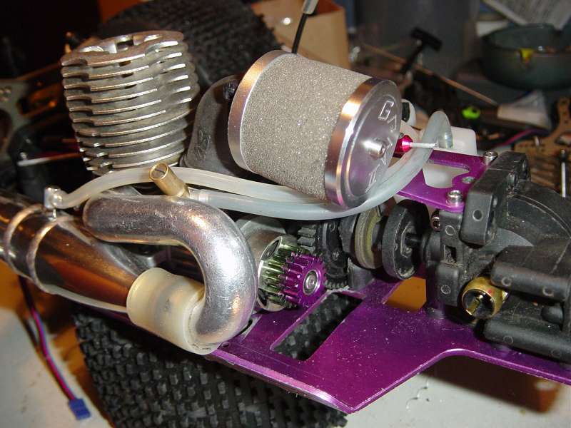

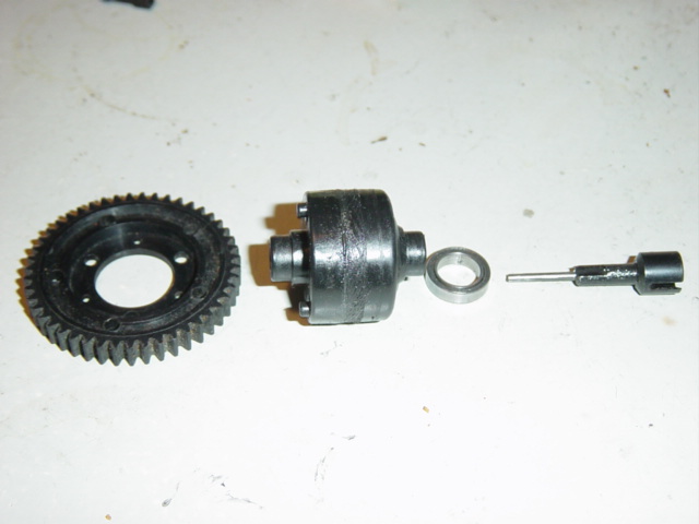

hi, i cant be the first person to have noticed how the single speed spur fits the standard diff, and it looks as if the whole assembly might fit where the 2 speed is. no, i havent decided where the displaced brake is going to go, unless it can go the other side of the seat with an appropriate hub fitted.
have u seen this done before?

RE: FAO: CEN RACING. Centre diff for FunFactor?
Poor Judgement,
That is a very good observation. No, noone have installed or attempted to install a center differential. To our knowledge. We have had no plans on installing center diff to our current FF vehicles. However, future projects of this vehicle include the idea of pursuing a center diff.
Thanks for your comments.
CEN RACING
it all seems to fit in there, its very close mind you, only a milimeter clearance between spur and tank, flywheel and diff etc, but its in... just gotta swap the remaining parts over from my rally to see if it will work ok.
i cant believe no-one has done this before... its very easily done.

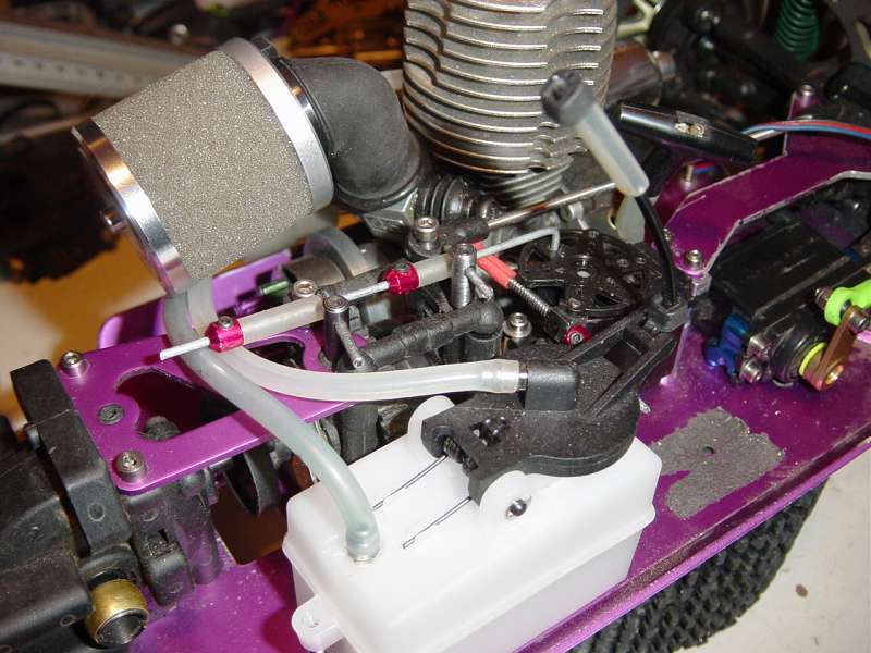

Photo update... shafts and mt suspension arms will be on soon, they are the rally fronts shown on the pics, as are the shocks.
any thoughts as to whether i should go for 18 buggy front shocks all round, or tmaxx shocks all round.... or go mad and put atx shock towers on with some longer shocks?
its kind of a truggy setup i guess... what shocks do they use, and on long or short towers?
Poor judgement, what will you be using as driveshafts when the centre diff mod is ready to run? It looks like you may have to custom fit some.
Join Date: Apr 2004
Location: Cleethorpes, UNITED KINGDOM
Posts: 2,077
ive made some mods to the single speed driveshaft, and ive cut down the long centre shaft, just need to drill it to take another pin. ill post some pics of them when its in bits again if u like.
