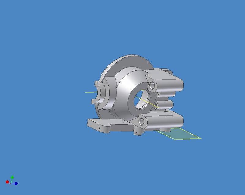

I did a little work on the rear diff drawing tonight since I broke all my spurs and have nothing to do!
Check out what I have so far!
Any suggestions?
P.S. I'm leaving extra material where is wont harm anything so when these get made they will be SO STRONG!
Any suggestions?

Dude, thats pretty sweet! Are you imputting all measurements manually?
If you Git R done send it over to DR Honda and he can try it. I sent him all the internals from my diff too so he can make sure everything fits.

looking good, i can see it being expensive tho! we will see...
the original 3x8mm screws are self tappers, better to use 3x8mm metric, M3 threaded screws imo - but then im in the uk... can US owners get the M3 screws ok over there?

Yes...I'm drawing this all from manual measuring. I could not get a CMM so I'm using good old vernier calipers. Brand new set of Mitutoyo...I checked them with gauge blocks before I started also.
This is partly why everything is taking so long...I need to be as acurate as I can!
And there will be quite a bit of milling to do on these bad boys....could get pricy...I hope I'm at least getting a deal for all this drawing. [8D]
STRONG though....I dont think these will break...all the material that was relieved I left in so these are going to be super strong.
We will be the only guys with this mod!

VERY nice work!! If these get done… I will hook you up. You are saving me a lot of time by drawing it. And, since the wife is towards the end of her pregnancy… it’s time I don’t really have. (thanks) Even though I’m getting a front one sent to me… if you want to do a front case also… go for it. The originals will be good for doing my set up, and checking the fit of the parts.
Poorjudgment…
Unfortunately… you are right… these won’t be cheap… but I’ll do my best to keep the costs down. Depending on how many tooling fixtures need to be built… and how long the machine has to run for… they still may be reasonable. I may even offer a special price for my loyal followers.
OK… this is for every one…
What would you be willing to pay for one case? (front or rear) Also… can you guys can live with a “rough” finish? That would help keep the cost down. A fine finish on the machine will take almost as long to run as doing the rough, and intermediate cuts.
Poorjudgment…

Not including proto's and machine set up......1/2 a day's labour to do each section.
2 sections per part so......100 bucks for front and 100 for rear...if 10 people buy them...150 USD for both.
Thats $1500 in your pocket Dr.Honda....so....with all the set up and building your milling strategy (if you can get it done in 2 days) you can profit 1/2 of that!
The only parts that need a good finish are where the bearings sit and the hinge pins go through...
I have the ARO shock towers so I'm going to size my holes for mounting to those...
The bottom holes and locating pins will be sized according to the stock FF chassis. I dont have the JT racing chassis.....YET!
I want to take my time with some of the measurements so Dr. Honda wont have to make too many proto's.
To cut down on machining time I can remove a bunch of chamfers and fillits I added just to make things look good.
I will only chamfer the pieces that need it.
Dr. Honda...Hook me up and I can draw the front for you also.
Feel free to use my drawings to make as many as you like and set your own price. Feel free to put your "ARO" mark aswell!

I would prefer to have the CNC machine do the holes for me.
All DR.H has to do is get the right tapp.
In the cad tool I can program the hole dia. and thread pitch....so when Dr.H's mill asks for a tool change, it will even tell him what tapp to load!
Plus some of the holes are blind...and would you really want to snap off a tapp in one!
and I dont mind about the rough milling....
For those that dont know what roughing and finishing passes look like....
To make the outside of the diff case look like the bottom pic would double (EASY) milling times.

Don’t remove any of the fillets. When I work on the CAM program, I will just omit them… or I may still use them… but at a roughing speed. I can always make a rough cut with a large tool, and then do a semi-finish cut with a ball nose to get the fillets. (probably not exactly the size you drew them at)
To all…
I will drill and tap all the holes in the case via the CNC machine to make sure they are in the right spot. And anything like a bearing support, or hinge point will be a fine finish because they must hold a tolerance.
Basically the picture posted by bootmachine is the idea of a rough cut… but because we are dealing with smaller parts, and cutting tools… it will still be a semi smooth finish. In a part that I would call a rough finish… you will still see all the tooling marks. And cut lines. (think more like an industrial finish) To get it to a high gloss… you would have to sand and polish it.
My Maxx Gasser braces have a semi-finished pass to make the design in the pockets. So the cases will probably look like that all over. (it’s a faster cut)
