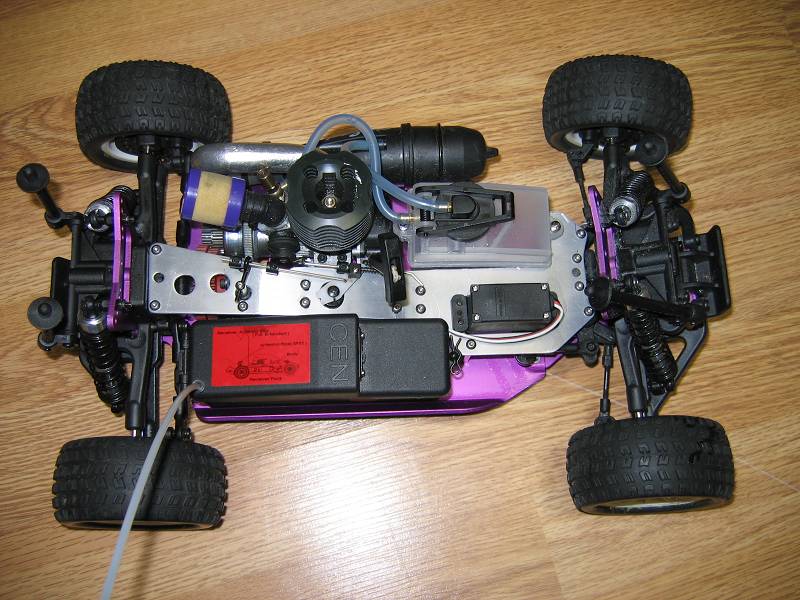

ya heres a pic from his gallery.
Maybe all we need is an aluminum throttle servo mount thing to connect the upper plate to the servo mount, then the servo mount to the brake seat and the plate above the spurs.
I think nitromacguyver had something like that but it was really rough just being handmade.

dustin - that 2nd pic u posted looks good to me. something like that machined up, nice and pretty would be the ticket imo, but again pricey. but thats what i want.
as for the magnum gear - i doubt a plastic top plate will take my bashing sessions very well tbh, so im with alvin there. same goes for the magnum chassis too - what grade is it and how thick? i need something solid to try to get a 1/8 centre diff into my mt, and i dont fancy using the jt as a prototype.

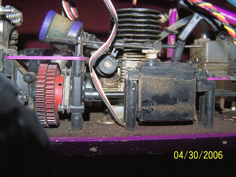

Does anyone have an extra rolling chassis that they want to sell cheap? (or trade for parts) I don’t need a radio.

I JUST THOUGHT OF SOMETHING!!!!!!!
The answer to the chassis flex, and bracing seems too simple to be true.
I need a picture of a stock FF, from the side, looking at the throttle servo. (Dustin’s pic is good, but it doesn’t have stock parts) I also need a top shot of the throttle servo. The pics need to clear and in focus… and only of the servo and surrounding parts. (don’t get too far away, or too close)
I will disclose my idea shortly… and it may be added into the chassis kit!!
(I’ll also post this on the chassis thread)

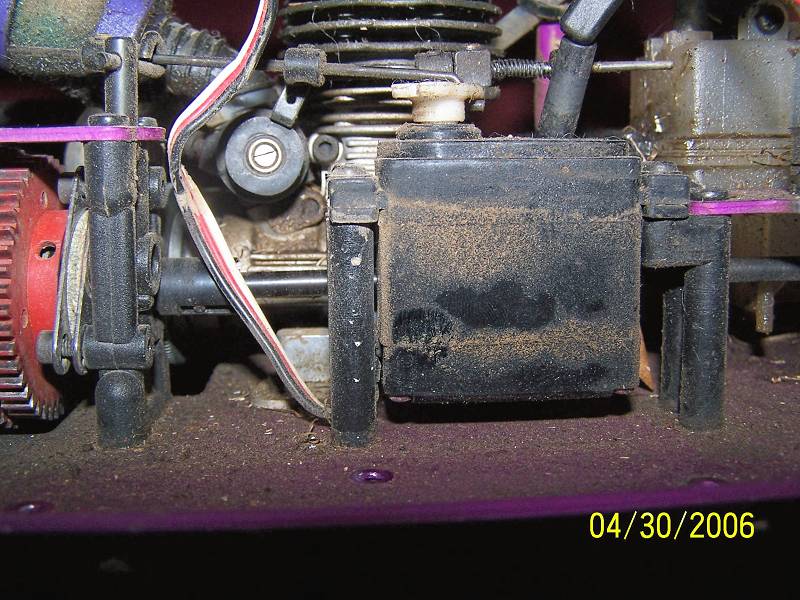

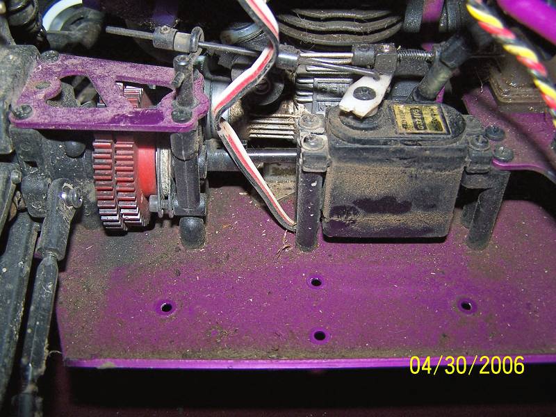

RE: Bulletproofing FunFactor
Dr. Honda. Here are a couple I took of my truck when I first got it. I don't have a lot of real close ups from the original box, but I hope this helps. If you need more, I can take some custom shots. Mine is not too far from original, just really dirty...

Alvinl…
Thanks for the pics. Those showed me a few things I wasn’t thinking about. But I need one side shot of the throttle servo… and now… with the battery/receiver box removed. (90 degrees to the chassis) I don’t care about dirt. These are off-road vehicles after all.
My idea is to extend the rear chassis brace. Instead of it just going from the rear diff, to the break bearing plate… I want to extend it over the throttle servo, and mount it to the forward servo mount. (where the front brace starts) But, I need to see if I can clear the top of the servo (leaving room for the break linkage) or if I have enough room for the servo horn to come threw the plate.
