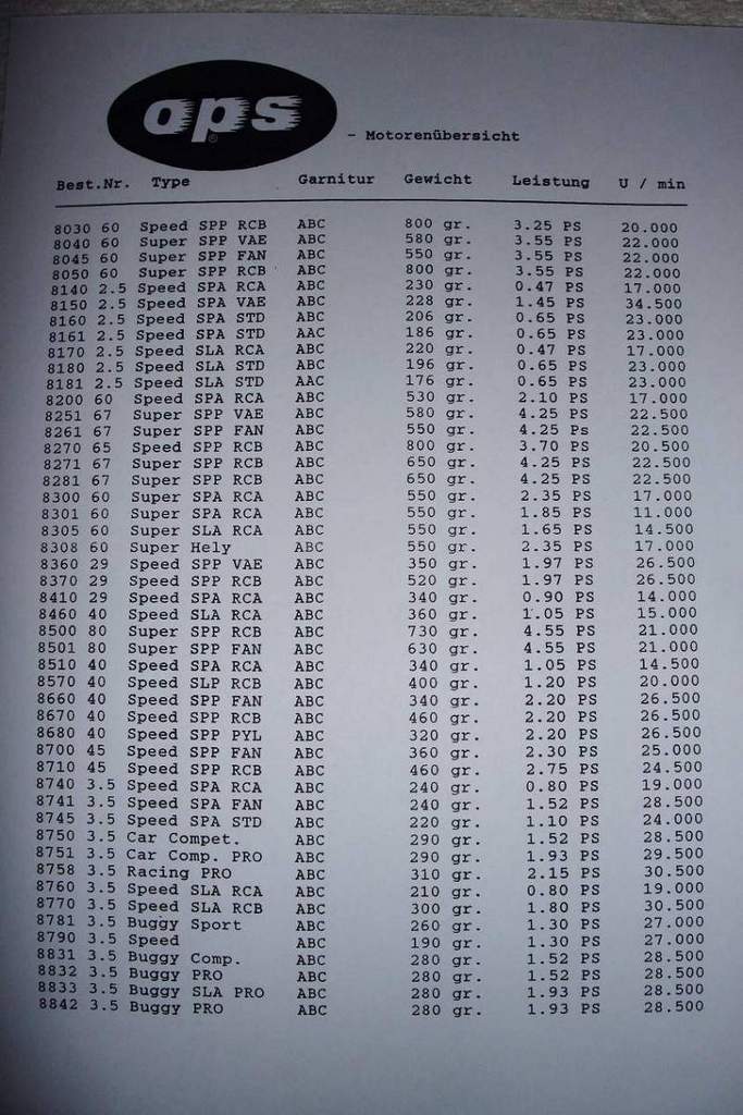

I did understand but maybe there are a lot more models to use, see the picture of I-Love-Jets of RC Groups
I do not know the age of the list but I only see the 8301 of post 1 in it and and three other 60 models (mayb?) to use.
Cees
